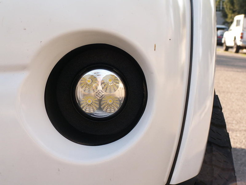

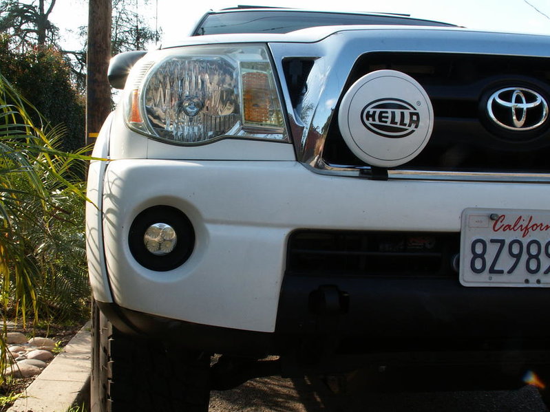

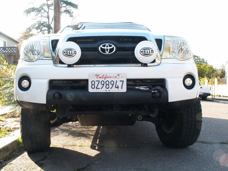

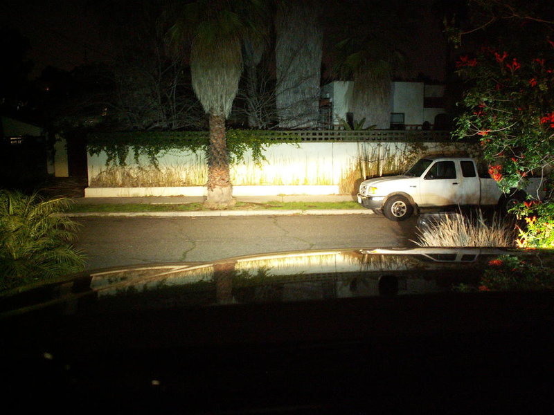

    Blitzpro 3LR installed in stock fog light spot

    that looks badass how did you mount them there? have any pictures of night?

    I was just thinking the other day that these would be cool as fog lights. I am also curious as to how you mounted them and how the light looks at night....

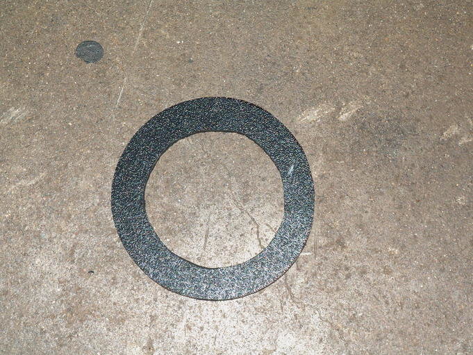

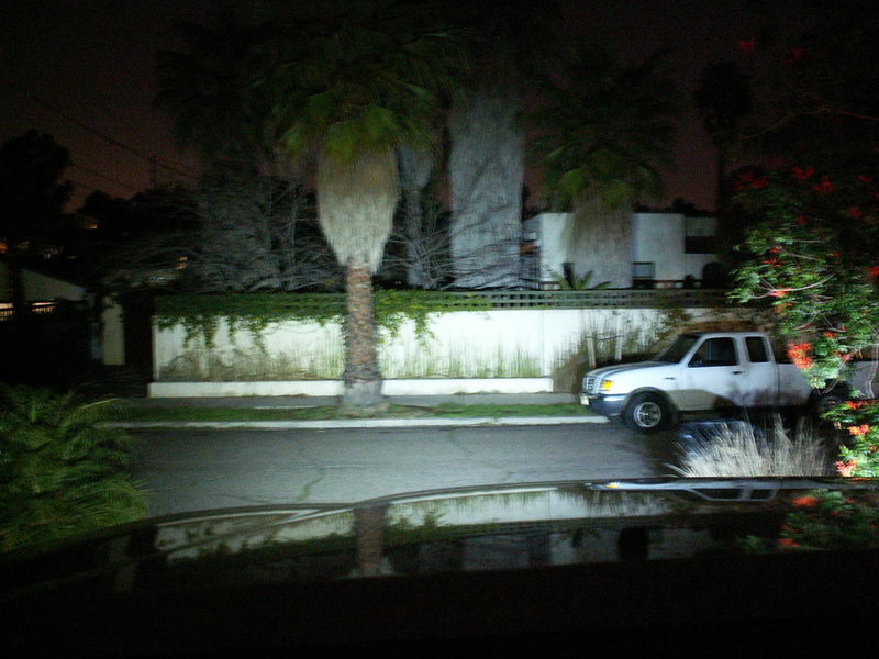

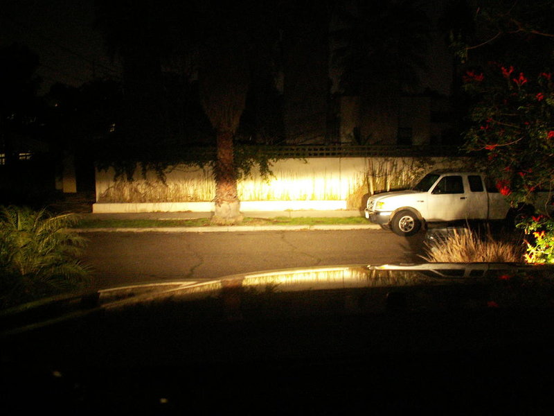

    I just had a small sheet of 1/4" abs plastic and cut the inner hole at 3 1/4" and the outer ring at 4 3/4". Remove the stock fog housing and you will see a small black insert in the back of the bumper light housing. Remove that plastic piece that is where the new 2 1/2" bolt on the led light goes through. I made a small bracket up to the body bolt above the light out of aluminum. You will have a small space between the light bracket and where the bolt goes through the plastic hole. Fill that with something, I used a rubber spacer to fill the spot, so when you tighten down the nut it will be solid. Set your light and put the ring over it and push it all the way back to set it , I used a little silicone on the ring but it does fit pretty tight.
