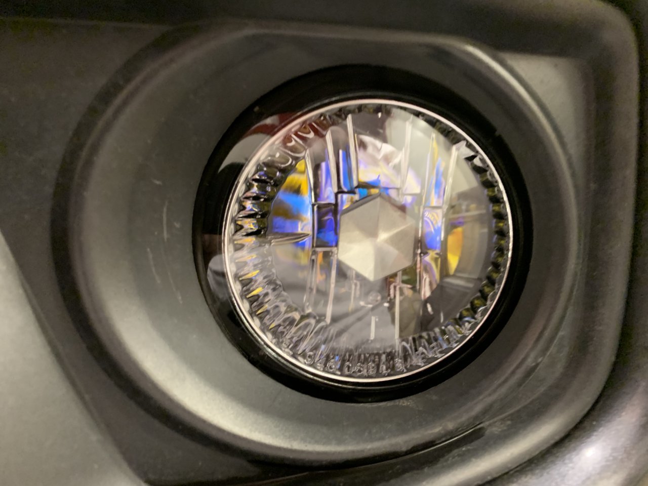

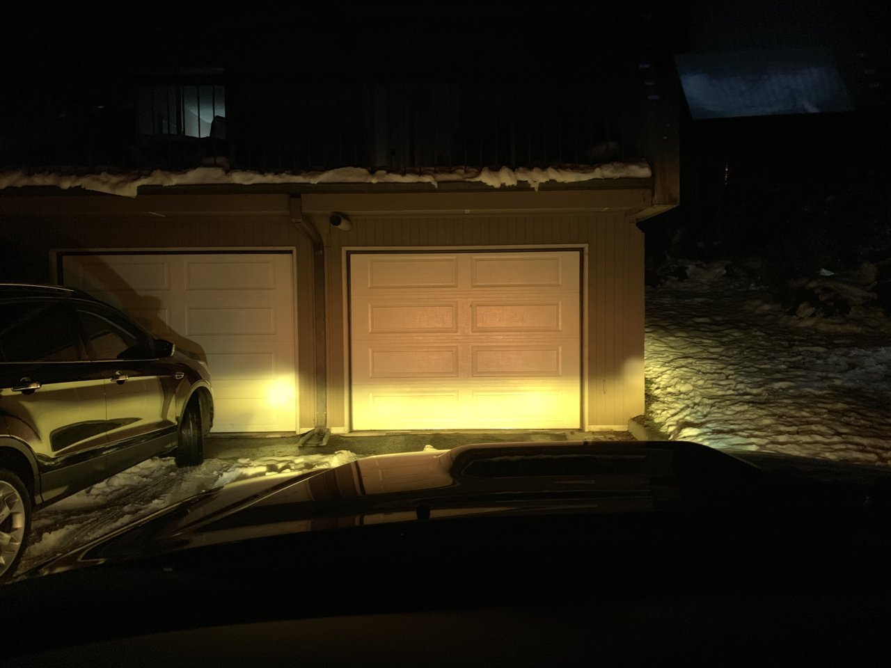

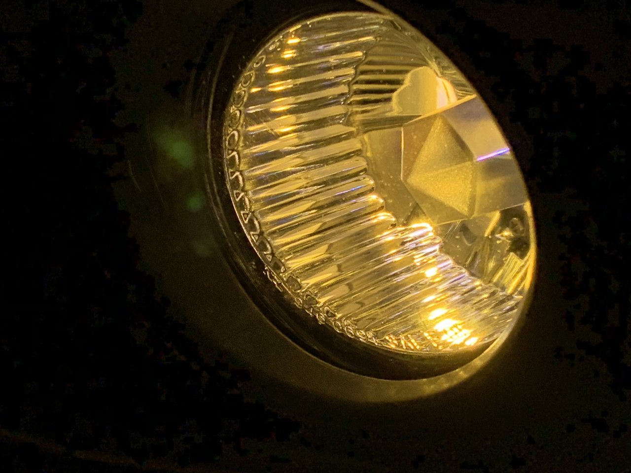

    Here is what I am currently running. Subaru fogs that have internal glare guards with overwattage 2300k H9s. Less glare than stock with stronger cut offs and significantly more output. The beam pattern is much more forward focused than the TRD wide angle fogs though.
    I haven’t consolidated this info to a single post yet and have been sharing as I go putting this together, but for more info I started posting about it in post #378 in my foglight thread and it goes over the following 2 pages.
