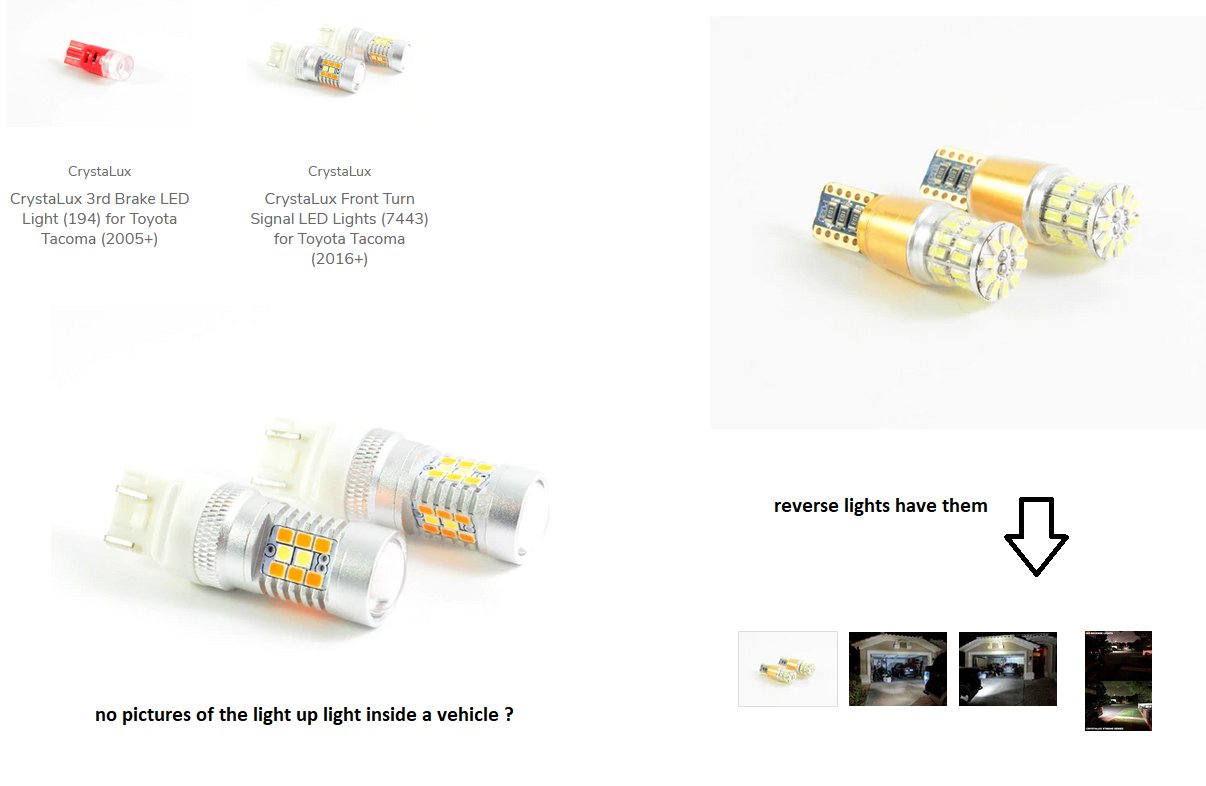

    since i already bought the SS3, just looking for other lighting options like replacement bulbs but seems to have many of these crystal lux brand and no other choices.....and they don't even show the light output rather than a picture of the bulb and not a comparison of levels or these vs stock vs competitors etc.
    i don't see any reviews but i guess maybe this is a new site ?
    thanks for reaching out. i'll just zoom zoom elsewhere
