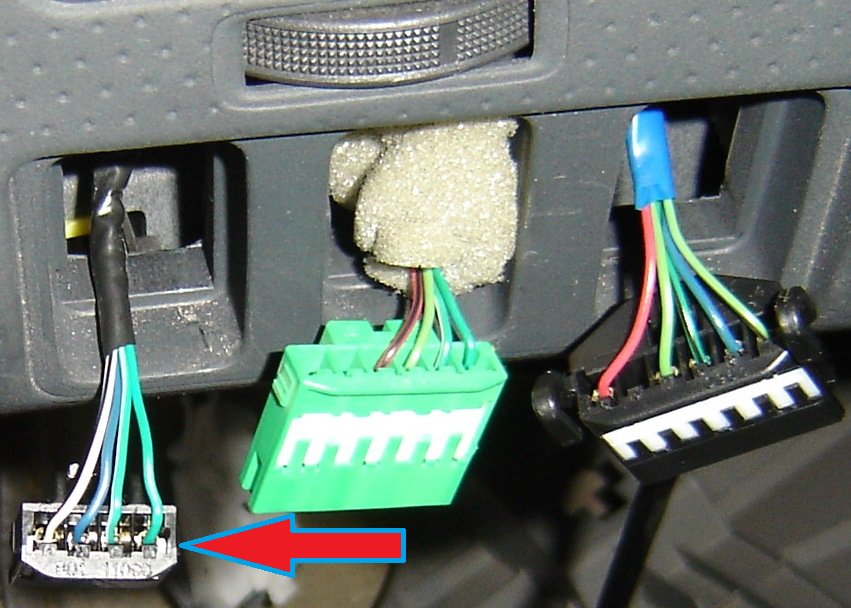

    Do you have this button by your left knee when in the driver's seat?

    So I have this connector but I see no other wiring near the headlights or fog light area.3CE93163-5720-43FA-9401-0A693947F463.jpg

    Definitely no pre wiring on my truck…seems odd to include a switch connector and not follow through with wiring.

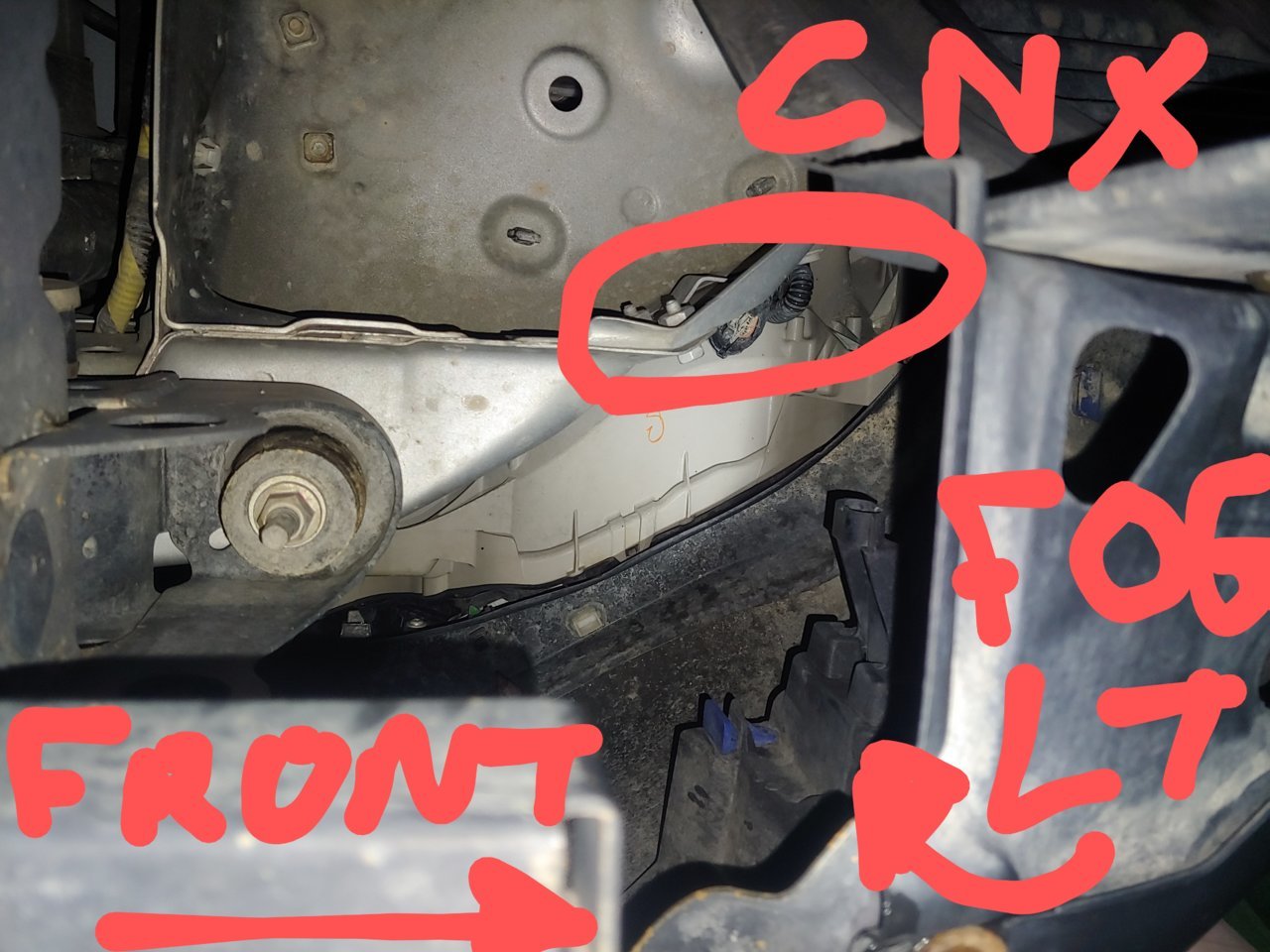

    Here is what it looks like behind my passenger side. Wires to fogs were very high up on driver side too.

    Is that below your headlight assembly?

    That’s what it looks like to me. I’m telling you if the fog switch connector is there the fog light connectors are hiding somewhere. There is no way they built a harness with only one end of the fog light wiring in it.

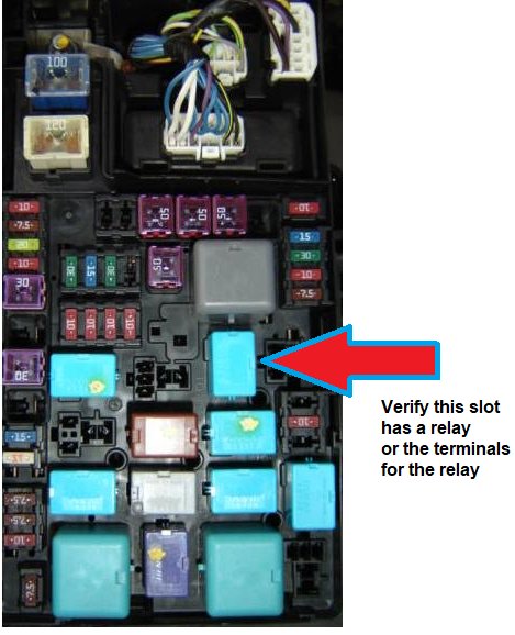

    I did check the fuse box and there is definitely no relay.
