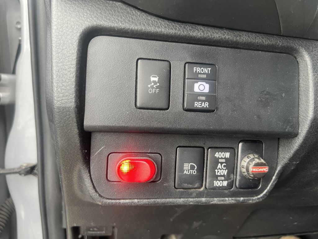

    One posi-tap to the C11 connector (light stalk) to an ON/OFF switch. Switch size depends on vacant slot the Taco has.

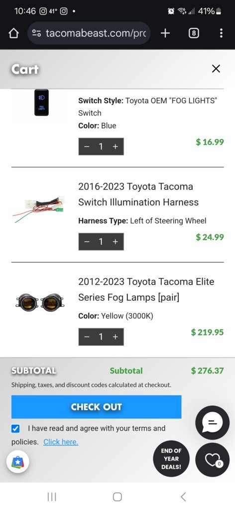

    So this is my cart.
    I just need fog light bezel, wire harness and relay correct?
