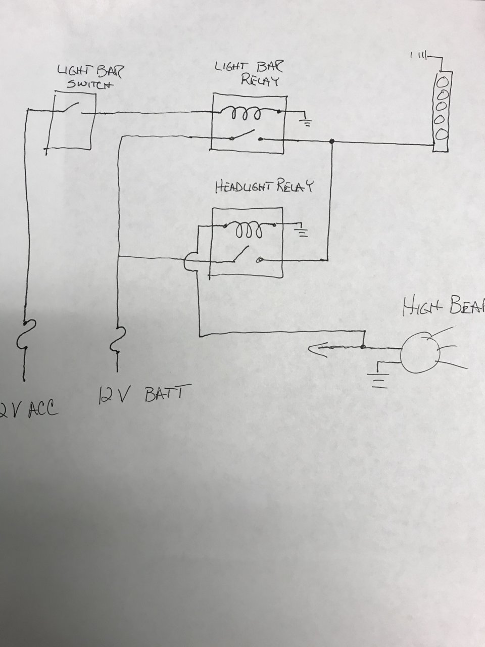

    IMHO, I don't think it's worth having the Fog's on with High Beam's. Personally, I think you would be better off purchasing a Light Bar / Driving Light Kit. And then simply use your High Beam circuit to trigger the relay for your new lights. I did this exact set-up on my previous JK Wrangler. And It was awesome.

    @DWD484 You already have everything you need to make your Light bar activate with Highs. Just need to add a little more wiring.

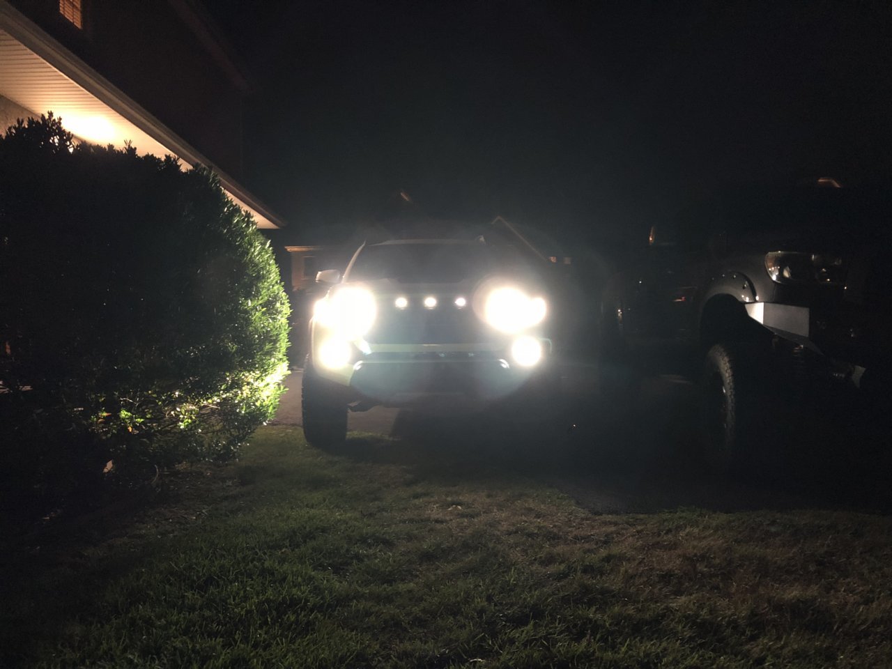

    AFAIK this doesnt work on 3rd gens

    Plug
    And
    Play
    :spending:
    :bananadance:

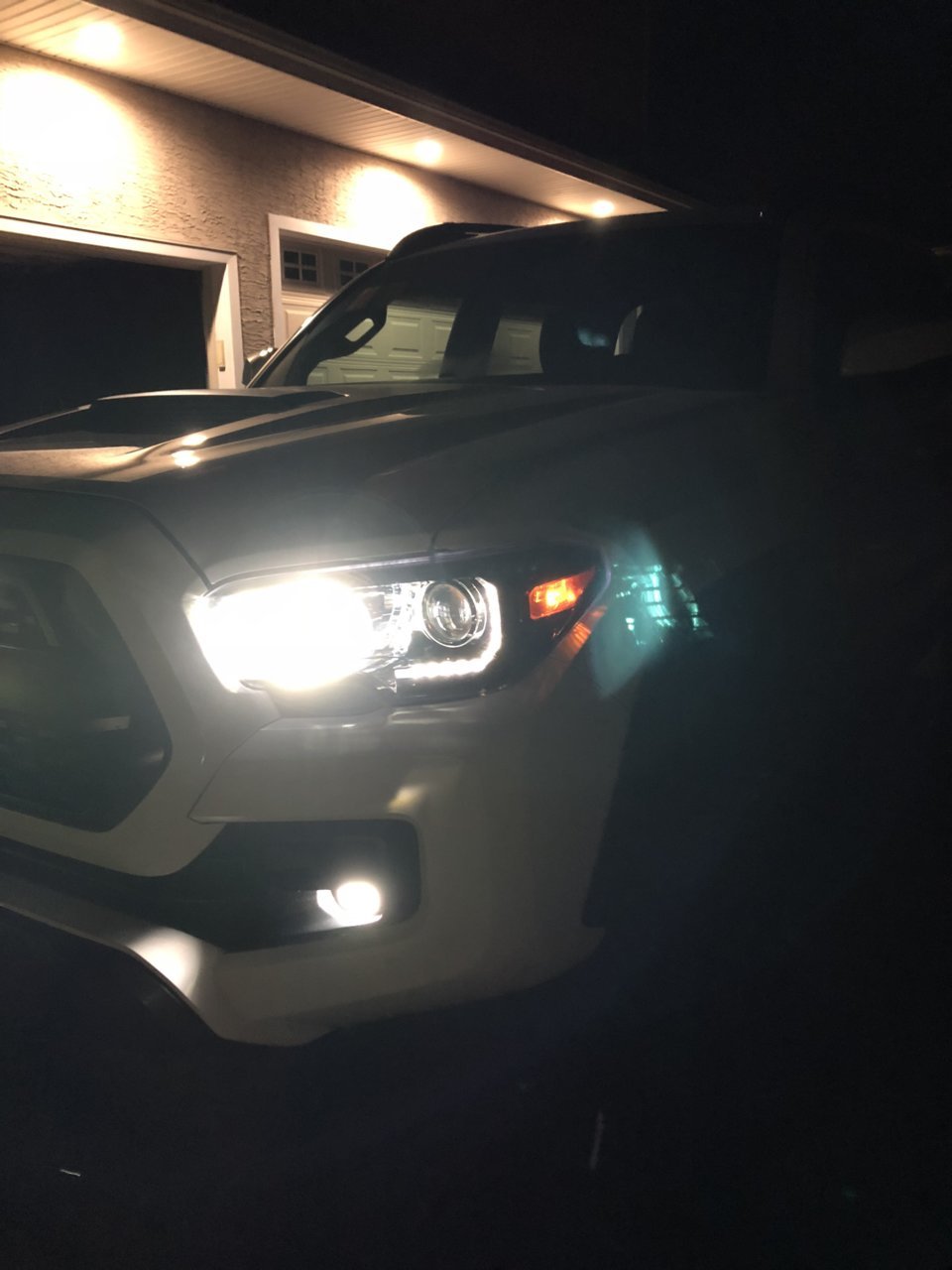

    An easy solution would be to swap out your turn signal bulb for a switchback.

    That is the reason I use two relays. The only modification to the OE system is the additional current from the new relay (maybe 0.01 amps). The system can be easily reversed by removing the wire tap fro the OE head light circuit. I used this system successfully on a 2007 JK Wrangler (With CanBuss). And had ZERO affect on the OE systems. I also used this same system for Reverse Lights and Puddle Lights. The biggest benefit for this type of system is NOT using the OE "plug-N-Play" power supply. By using the battery as the primary power supply, you further reduce the chances of electrical issues with the so called Plug-N-Play systems.
    Your right, I'm just a nobody. But you really should do a little research on the difference between Fog Light System and Driving Light Systems. You may actually figure out why this is a poor choice.
