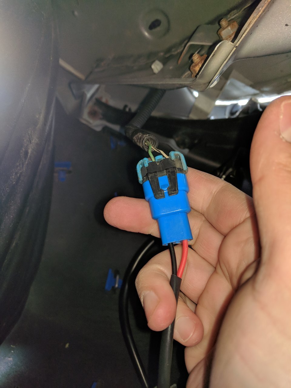

    I just got some new side shooter ditch lights. I had amber pods there previously and wanted to move those to the fog location.
    I just buttoned everything up, side shooters worked plug and play to the original harness.
    However, the fogs did not turn on at all. I used the "plug and play" pigtail provided.
    Is this pigtail wiring in your "plug and play" harness wrong in the image below?? These amber pods worked perfectly fine in the ditch location so i know its not the lights. Even the morimoto fogs worked perfectly just before i took them out so i can rule out the oem harness having an issue.
    Thoughts @CaliRaisedLed

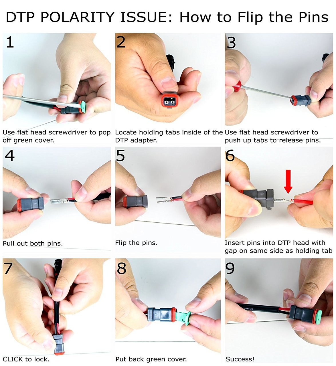

    The polarity on the fog light harness is different than the oem plugs provided. If you follow these steps. It will fix it.

    PERFECT! Thank you
