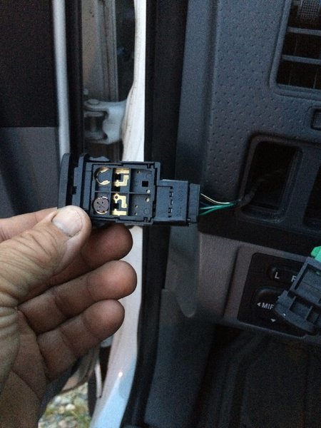

    My taco came with wires to the fogs which I just plugged in. This connector was the only clue as to what might be the switch-side of business. fog1.jpg
    Before I start snipping and beeotchin thought maybe I would if one of the viewers might have been here too...?

    Fog light blank if top row left side, if there is a connector, it will be behind that, you have the mirror remote wires
    The wire connector will be push into back of blank if it's there
