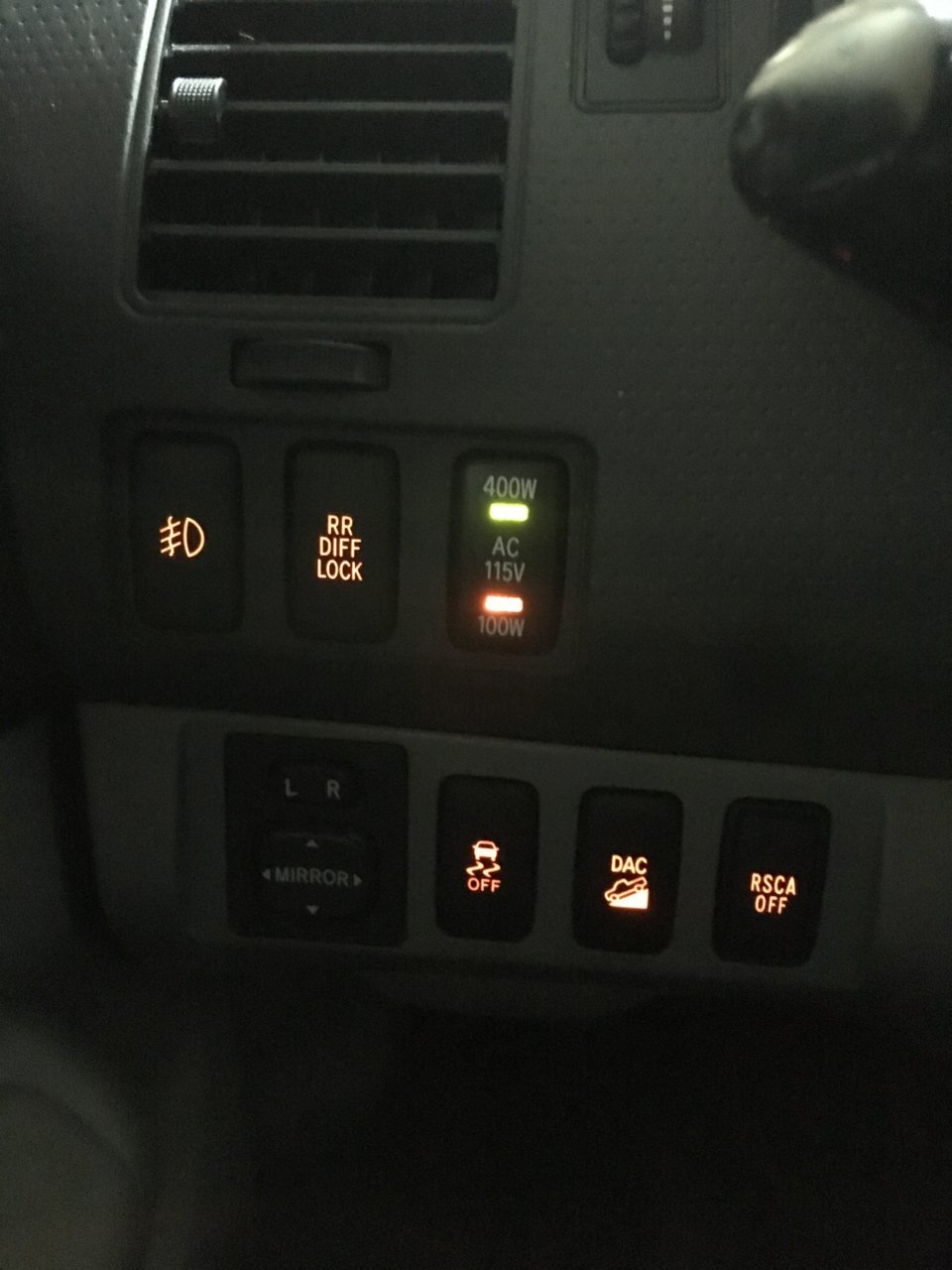

  9. Sep 7, 2019 at 5:03 PM
    #29
    mphawk
    mphawk Member
    Jan 6, 2016
    #174224
    8
    Bristow, VA
    2010 DC TRD OR
    OME 2885 front coil overs, Bilstein 5100 front, 5125 rear, ICON RXT pack (option 2), JBA UCA, Whiteline LCA Bushings (Best thing I've Done), ECGS front diff bushing, VLEDS Triton V6 headlight bulbs, VLEDS DRL, Power Stop front calipers, SOS rear bumper, RCI skid plate, Rough Country step bars, TRD gloss wheels, KO2 265 75. With the OME coil overs, ICON RXT option 2, I essentially achieved a 2 inch lift with no vibe issues, way less body roll than stock. With the Whiteline LCA bushings, my steering is hands off straight on the highway...night and day difference from OEM. Replaced upper and lower control arms, sway bar bushings, alignment cams and had some alignment cam stops welded on at 120K miles. Drives better now than when it was brand new.
    I just replaced the back lighting bulbs in every switch except for the inverter...
    Thanks for all the tips in previous posts. I ended up dropping the lower dash toget to the upper row of switches. Pretty straight forward. (Video link below)
    Ordered the T3 bulbs fromAutolumination. The amber matched my 2010 dash perfectly. They lock and unlock in to place with a 1/4 turn from a straight slot screwdriver. (Had to shake the old ones out of switch onceunlocked)
    The autolumination bulbs are tinted glass....The OEM bulbs had like a silicon condom-like cover on them. My guess is, that the heat retained by the silicon cover may be one of the reasons thatthe OEM ones didn’t last long...maybe?....so hopefully the tinted glass bulbs last longer...
    Found a pretty good video...it’s actually showing how to remove instrument cluster. For gaining access to top row of switches...I was able to stop once i got to the part where the lower dash is separated from the upper..(10 minutestops to get the dash halves separated)
    https://m.youtube.com/watch?v=bh_SmWsSZH8
    I tried the fishing line...the butterknives...trim removal tools...My upper switches were locked in tight....couldn’t budge the upper switches till I separated the dash halves...and was able to get a small screwdriver behind them for some persuasion. Top switches seemed to take considerably more force than lowers..
    Also replaced the lights in the climate control panel. Clear T4’s from autolumination.
    Replacing the climate control panel lights first was good practice...the T4’s are quite a bit larger than the T3’s in the switches
