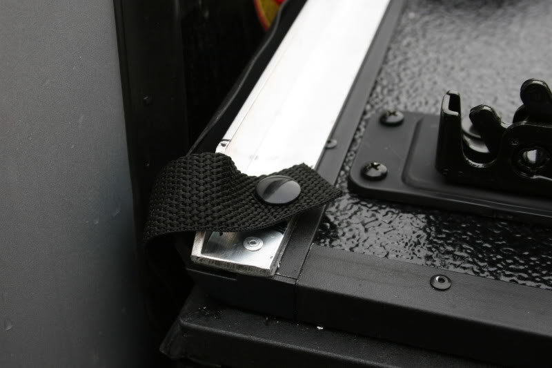

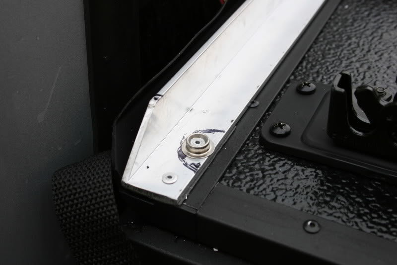

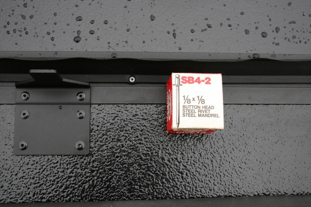

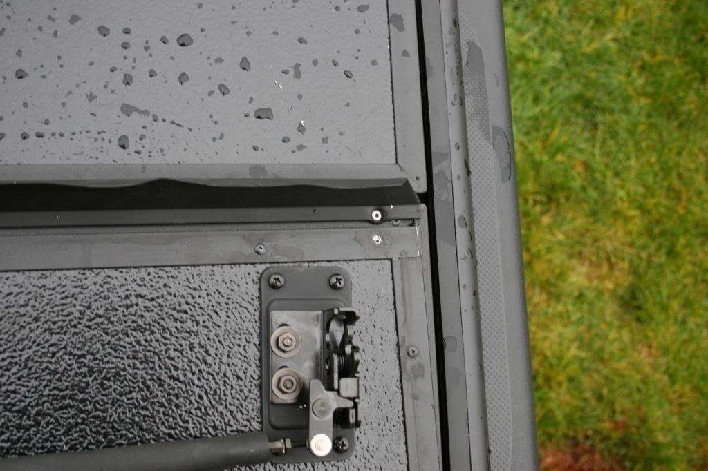

    The gap was about an inch. I riveted the strapping on. I will plasticote the strapping once it warms up here. Rivets are spaced about 3 inches apart. The design (angles) of the weather stripping doesnt allow the stripping to flap over the top of the tailgate. Once mounted it fits square down to the tailgate and folds back in. Ill will get a pic tomorrow for you.
    Cheap, cheap design for the moulding. Its like they just used whatever was in the back room to get rid of it. Im on the hunt for a more appropriate moulding.

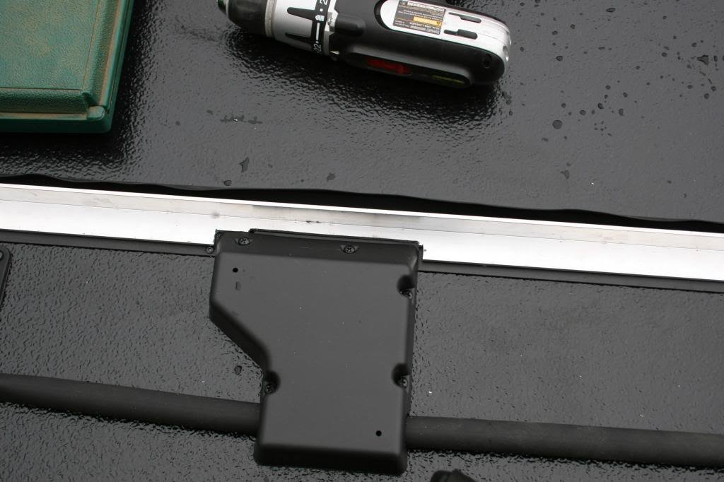

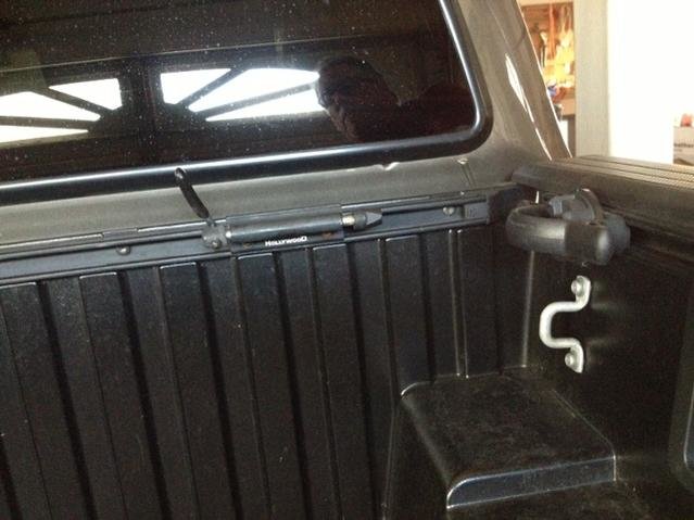

    This is a pic with 1" aluminum tube attached to tailgate with out a seal.
    These pics show a 1" tube attached to front rail.
    The above shows from front of bed looking in

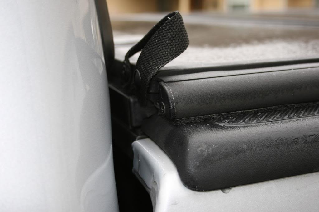

    Now this last one shows the seal I put on the door for the front of the bed.
    I am re thinking on how to do the rear at the tailgate.
    Stea put a strip over the stock seal, I am thinking instead of a strip how about a inverted L with the short leg as the strip and the long leg being a block to anyone trying to stick something in between seal and tailgate to break into the rear area. I was thinking of a 1/2 X 3/4 L shapped strip of aluminum.

    Vince, I think the L would be a better idea. Go with 3/4x3/4 though. My straps for the weatherstrip sit at kind an angle due the thickness of the weather strip. A 3/4 would bridge the gap to the panel frame and sit more flush. Use the weather stripping and it will cover the angle piece and look more clean.

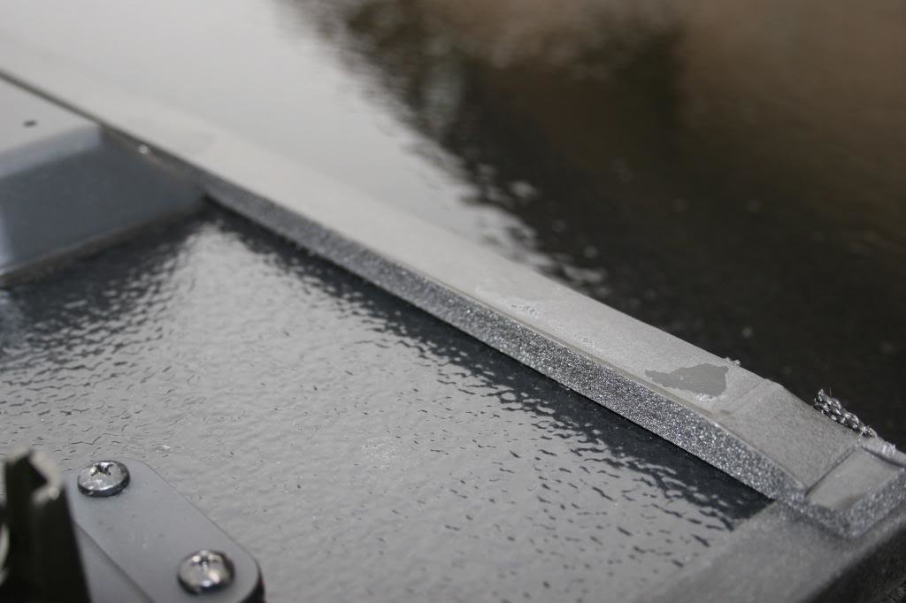

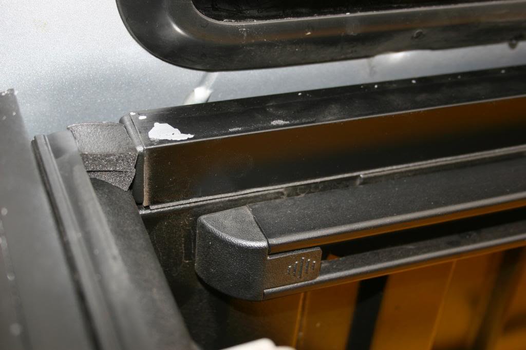

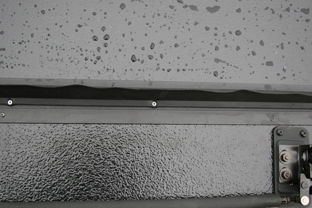

    Well this is my next installment of modification to tailgate seal of the fold a cover. Mondays are my day off so this is the only time I get to work on my truck. And the weather here is not co operating very well.

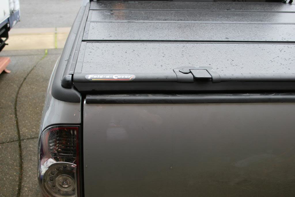

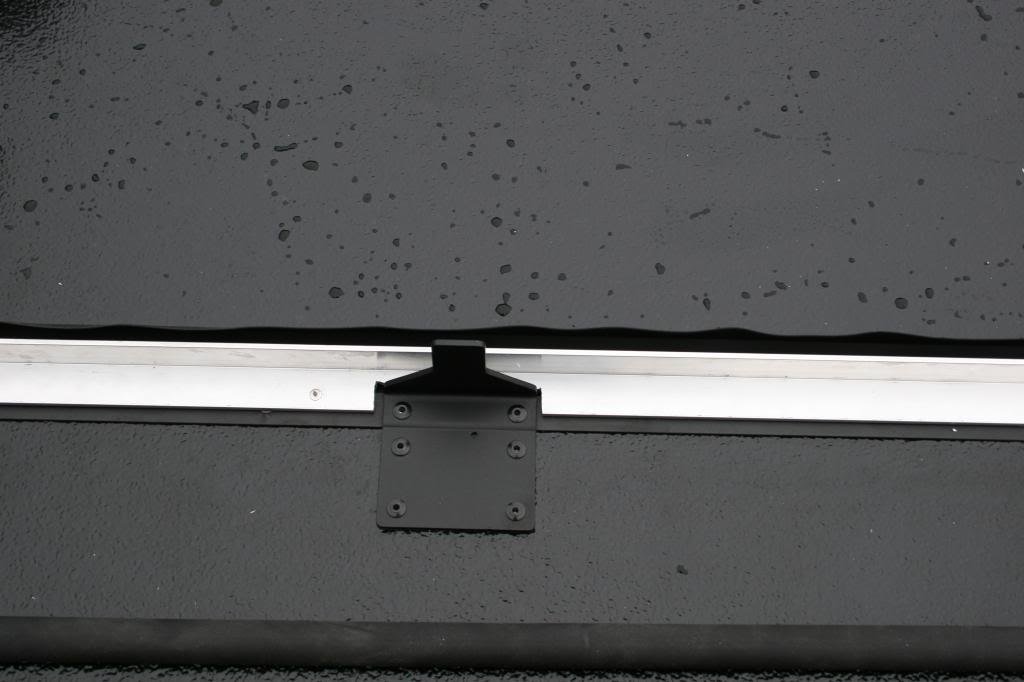

    So any way I removed the 1" aluminum square tube I attached to the tailgate. Then I went with a 1" L aluminum angle that I had picked up. I am attaching this to the cover lid. Now it needs triming to fit around the latch housing and the angle to lock the tailgate. You also need to remove the two snap heads attached to the lid. Here is a picture of the 1" aluminum angle on the cover.
    Because it is still winter and in the 40 degrees around here after triming it I attached it with 3 rivets only. When summer comes I will take it off and paint it black.
    Now because it is winter and 40 ish I put the seal on the rear door and then riveted it to the door to keep it from coming off here are pictures of that.
    Now here are some after pictures and it now looks as good as everyone else's but with the added security that some one can not get under the seal and easily pry on the door.
    For those of you thinking of getting this cover I would recomend you put a 1" square aluminum tube with plastic ends and attach it to the rail behind the cab. I had originally planned on screwing it to the rail, but I got some heavy duty double sided tape and just taped it across the rail. Then I put a seal on the front door, which by the way will probably need replacing in summer(I did this in 28 degree weather).
    Then if you put the 1" L aluminum angle at the back your bed will be more secure.

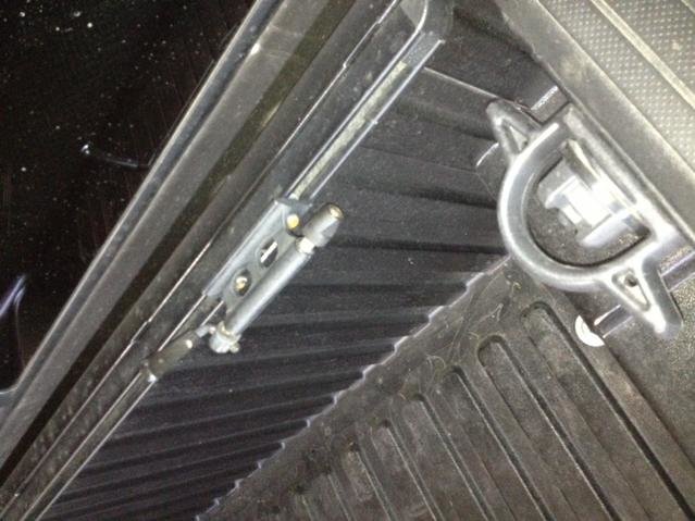

    For those who have the G4 Elite installed:
    Wondering if I can use the fork mount bicycle rack in the front rail of the bed. See photos. I figured on leaving them in the rail. To carry bikes I'd fold the front section back, secure the forks in the mounts, and have the bike ride on top of the bed cover. I'm carrying CF road bikes (< 20 pounds) so weight shouldn't be an issue.
    So my questions:
    1. Will the front section of the G4 close with the fork mounts in the front rail?
    2. Is there any problem driving with the front section of the G4 open?
    Thanks.

    Looks to me that the cover would close easily over the brackets. Also, it shouldnt be a problem folding the front section and hooking up the bike. The second section hinge bracket is solid mounted.

    Thanks for the info. That makes the buying selection easy. Can't think of another folding cover that would allow me to use the fork mounts in the front rail without removing the cover.
