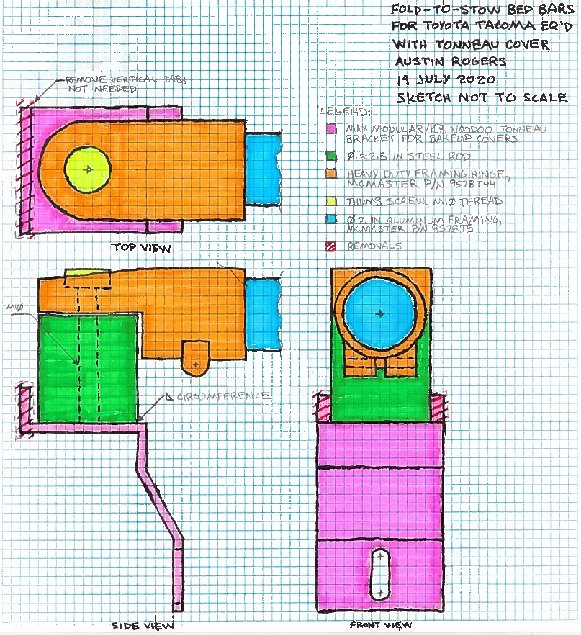

    TL;DR - Looking for design feedback from RTT users and anyone familiar with welding or cutting threads.
    I finally got around to piecing a setup together that should work well. I'll post a sketch up in a few hours to help illustrate the design. Here's a rough description of what I'm planning on doing:
    - Use MAX Modular/KB Voodoo Bakflip-compatible brackets to connect everything to the bed rails:
    https://www.max-modular.com/shop-max-modular/tonneau-brackets-bakflip
    - A short piece of ~2.5 inch diameter solid steel rod will be welded to the horizontal section of the bracket linked above. The MAX Modular brackets are 3/16 steel, so welding shouldn't be an issue.
    - The steel rod will be threaded dead center on its top face to accept a bolt.
    - From there, I'll use one side of a heavy duty 2 inch framing wye fitting to act as the hinge/pivot point:
    https://www.mcmaster.com/9578T44/
    - 2 inch OD tubular aluminum framing will be used as the bed bars themselves, which will connect the hinges.
    It's a pretty simple design, and should perform well. Assuming a 700 lb evenly distributed load, maximum deflection ("sag") is about 0.3 inches for 2 bed bars (0.2 inches for 3 bed bars). I do have a few reservations, so any feedback you guys can provide would be appreciated.
    - Due to the design, the bed bars will have to be mounted about 60 inches apart. I'm not sure how far apart RTT mounting points are, so I'm a little concerned that compatibility will be an issue if I ever decide to get one of those in the future.
    - I'm not sure how well low carbon (1018) steel will retain threads. I opted for this material because it's easy to weld, but am open to change it if there are better options out there.

    As promised, here's a sketch of what I have in mind. Anyone have feedback for me?
