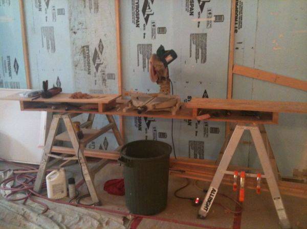

    Lol
    It's a couple pieces of plywood on top of some sawhorses

    Tada

    Function factor 10.
    Style factor 2.
    Space savings factor 5.

    It works the best for me .
    I can break it down in like 30 seconds , the sawhorses get used to rack my off cuts under the saw as I work , I can store small tools under the table , I can clamp material to it for planing or cutting , I can screw a stop block to the top for cutting multiples , the stock is fully supported for 5' on either side of the blade at all times , and I can make one in 20 minutes with one sheet of 3/4" plywood

    Yeah, only bad thing is it takes up space when disassembled compared to the dewalt folding miter stand. But you have a cap so no worries.
