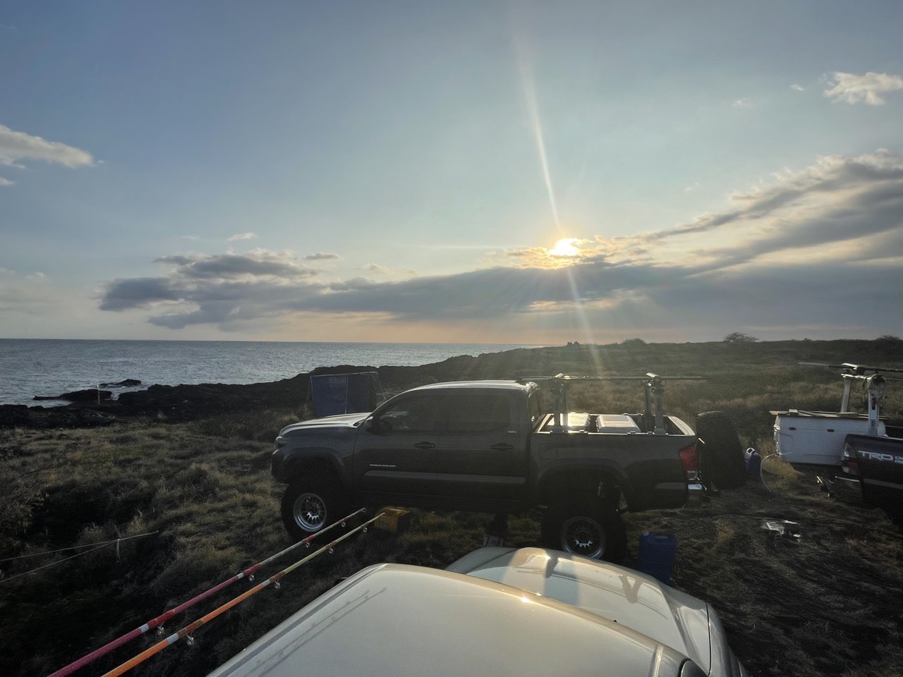

    A lot of great posts already, so I’m not gonna beat the horse on it - rather share my experience/reasoning.
    First off, I’m on 35s
    I set them at 30psi cold. I don’t daily my truck. It’s a 2017 with 19,2xx miles. Strictly fishing/camping/whenever I need a truck kinda thing.
    When I go fishing/camping - most times I’m driving 80 ish miles just to get to the trail. By the time I enter the trail, 30psi now turned into 35 due to heat building up. I can’t offroad my load range 35 @ 35psi - bounces like a damn pogo stick and the volcanic rock just chews the tires.
    So I deflate them down to 20, do my thing and refill before returning home. Been having nice even wear for the last 2 years on them
    30psi cold on my tires nets me about 20mpg in town, 17 ish highway when going camping with weight. (Also geared and tuned)

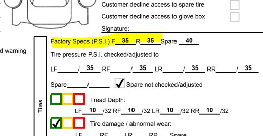

    My '23 Trail states on the door jamb to run 30 psi in the tires (seems low, but that is what the sticker says)
    Just got back from my first service and the dealer's sheet says 35 psi...
    Does anyone know what is correct?

    Go by door jamb if running stock tires.

    I just had mine serviced at Toyota, they put 36psi in all 4. 30psi does seem low and when its cold here I get low tire pressure readings if set at the 30 recommended PSI.

    Thanks, I'll go by door jamb but prob run 32
    So 35-36 seems like the norm for dealer psi's, frustrating they can't align with the manfacturer

    With stock tires (stock meaning stock size, stock load rating), run what the sticker says. Stock for you is 265/70R16, so 30 psi. If you changed to P265/70R16, you would want 27. It's not solely based on size.
    The dealer did what they did because they aren't going to be bothered to adhere to a strict psi, they're gonna probably follow some sort of general guideline that all trucks get 35, or something like that.
    if the door jamb says 30 and you're going by the door jamb, why would you run 32?
