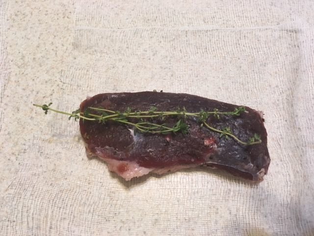

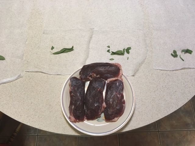

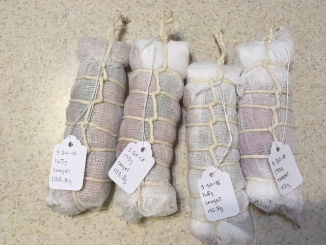

    I encourage you to make some Duck prosciutto. Its very easy all you need is:
    Skin on split duck breast
    3 cups kosher salt
    1 cup sugar
    Spices if desired
    White vinegar
    Cheese cloth
    1. Unpackaged and blot dry with clean paper towel
    2. Mix salt and sugar (cure) and put a thick lay in the bottom of a reactive dish. You can mix in a little black pepper as well)
    3. Place the beasts on top of the salt/sugar meat side down.
    4. Cover the breasts with the rest of the salt/sugar. They need to be totally buried in cure
    5. Put in your refrigerator for 24 to 48 hours
    After 24 to 48 hours:
    1. Remove from cure and wipe off as much cure as possible
    2. Very quickly rinse under fresh cold water and blot dry.
    2a. Pour about a 1/2 cup of white vinegar in a clean bowl and quickly dredge the splits through the vinegar and blot dry. (this helps kill off any unwanted nasty's)
    3. If you want to lightly spice now is another opportunity before wrapping. I used 1 sprig of thyme and a few sage leaves per 1/2 breast. Just place one on either side of the meat and move to step 4.
    4. Wrap up the individual pieces in clean cheese cloth and truss and/or tie up with cotton twine (available at any kitchen shop, grocery store or wallyworld)
    5. Hang in fridge (cannot touch other items) for 10 days to dry out.
    There are other things you can do to impart flavor like after the vinegar rinse, rinse again in white wine.
    I did the entire process above for 2 duck breasts (4 pieces) other than the aging part in less than a 1/2 hour total time with stuff I had at home save for the fresh spices.
