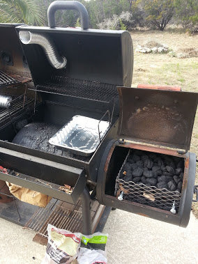

    Any of ya'll have any tips or tricks to make a cheap offset smoker work better? I plan on upgrading shortly but its just not in the budget right now with everything else I have going on.

    I find on a lot of smokers cheap or expensive using some sort of nonexistent gasket material makes them behave much better.

    Charcoal basket for the fire box
    seal the main door
    Dryer vent from vent to grate level.
    3 quick and easy mods. I'll look for my pics real quick

    no gasket on it yet, but that's self explanatory. Dryer vent and charcoal box were two biggest mods that helped a ton

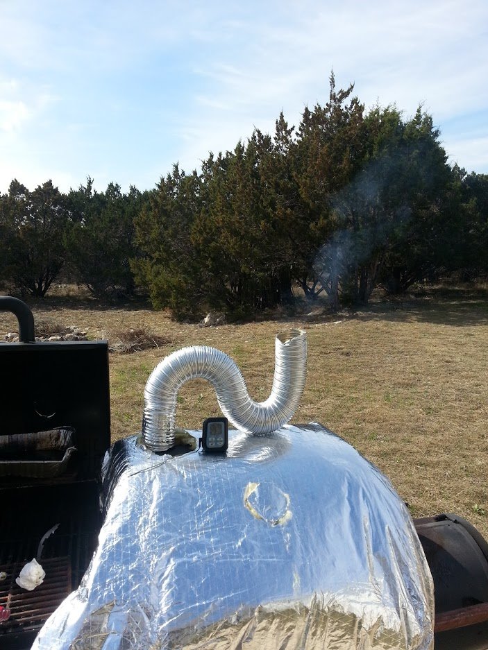

    cold weather mod too :rofl: even a cutout for the temp probe :D

    Only you :eek:
