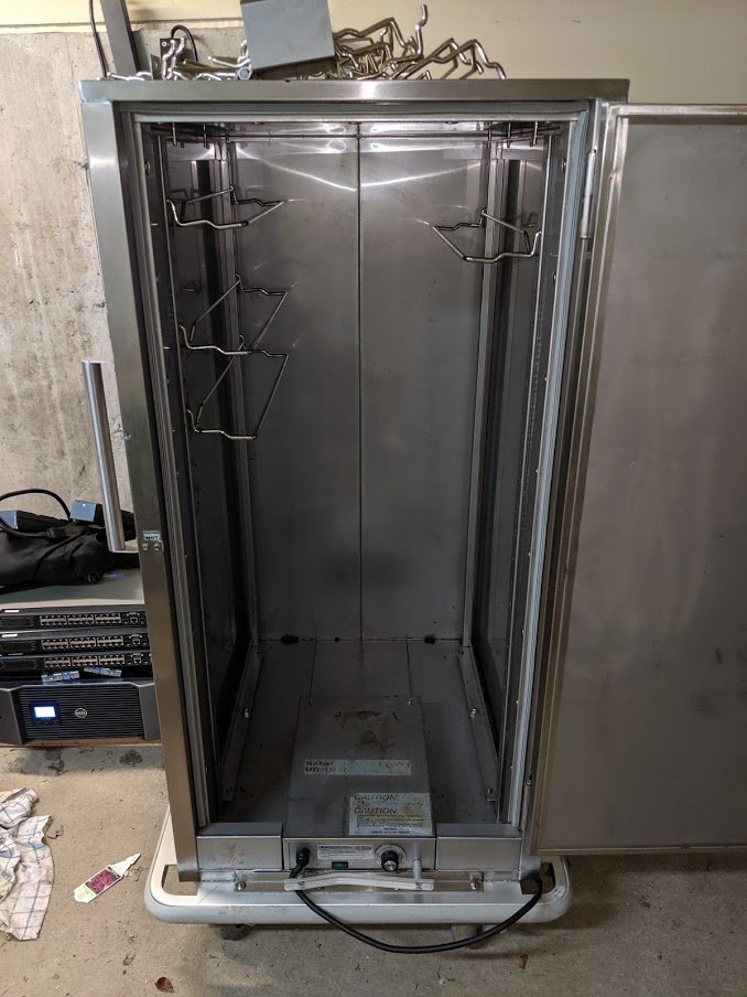

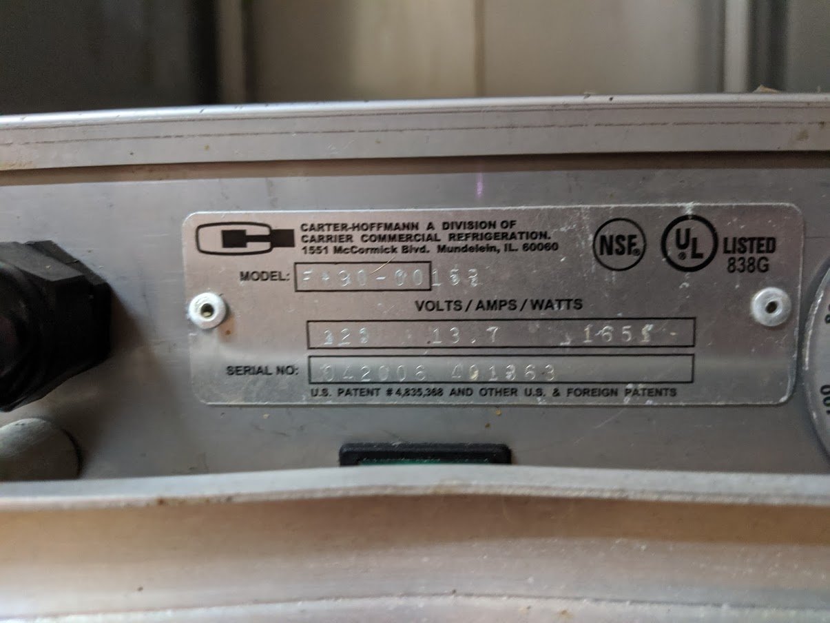

    Well, after a much needed vacation and journey to pick up my auction prize, it's back home with me in the garage awaiting modification.
    Now a question for those of you that have done similar conversions. I want to keep this as neat and tidy as possible. The walls of this thing are about 1" thick and insulated. I am looking for ideas on how to put vents in, but also re-seal the holes I cut so I don't smoke up the insulation or get moisture in there. I would prefer a no-weld solution, but if it comes to that I can. I've been looking at stainless flashing/pipe flanges that I can use to accomplish this but so far I'm coming up empty handed.
    I want to use something like these for the side vents, and a 4" chimney with a damper in it. I would prefer to keep it 100% stainless, and yes I know that will be expensive.
    I'm also looking for smoke generator recommendations. The holding cabinet heater should cover most of my temperature needs, but it would be cool if I could get a little extra BTU. I'm leaning toward buying one of the replacement bradley units and modifying it to suit my needs. I will probably put my own controller on it though.

    Those are ok, I have a box of stainless ones in the shop. I use rivets to install them. They will
    Last a long time

    The problem I have is I will need to put a sleeve through the side of the holding cabinet and have them welded in. I don't want to leave the insulation open. I would like to retain the ability to just hose the whole unit off or leave it outside if I decide I want to. The heating unit just lifts out. I'm considering just getting some SCH40 pipe and having a bunch of them welded in and using something like these: https://bbqsmokersupply.com/dampers...bly-for-4-pipe.html#product_tabs_askit_tabbed

    Maybe a pellet stove type wall thimble for the hole?
    https://www.lowes.com/pd/DuraVent-Black-and-Silver-Wall-Thimble-for-3-in-Pellet-Vent/3134705
    We punched a hole in one of the houses we had and those two pieces kind of thread together. You could find a vent that fits in the hole nicely probably.

    Used one like that for my pellet stove install and it had provisions for outside air feed for my Harmon stove. None made of stainless that I know of. I also need to be concerned with collapsing the thin walls trying to squeeze against them. I have a local welder willing to help out. This is one of the times I wished I had my own tig though. Maybe I'll splurge in an El-cheapo 110v unit. It would have no problem welding this stuff.

    10-4
    Welding in a sleeve would be easy and a clean install

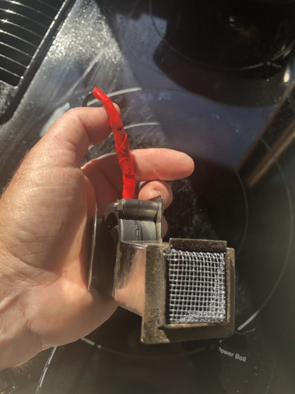

    Had an ember drop into the fan for my Flame Boss. Assuming anyway since the impeller had a chunk that was melted. Found a replacement fan on Amazon and put a piece of steel mesh on the mount and I am back in business.
