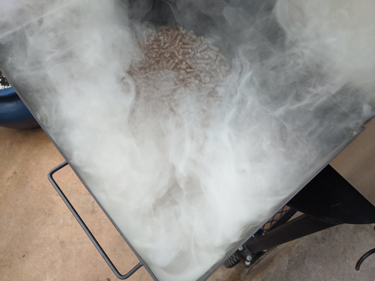

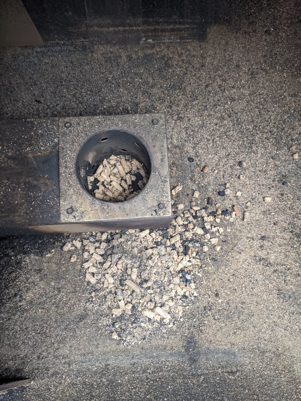

    Blew a fuse on the pooper... found the backups and replaced within 5 minutes. restarted pit and a few minutes later...
    @uhplifted ...
    Started to backburn on me!
    Purged all the pellets and scooped out of the fire pot. pic is post purging. caught it fast enough thankfully.

    Your pot was over full after the fuse incident. That causes a huge amount of smoke to push back up through the auger tube. Had it happen to me once. Shut it down and it’s all good.

    Most likely. From the time the fuse blew (the auger stopped) to re-fire wasn't long. but the flames were apparently enough to overcome the fans and work back into the feed tube. Still need a new igniter though if it keeps popping fuses. I already emailed customer service.

    Once it popped and you restarted everything it started pumping pellets into the pot as if it was a cold fire but problem is the pot was already pretty full with them. :)

    That was my initial thoughts as well. When I pulled the parts out to investigate, there was hardly any pellets in the pot. I figured it'd be full or full of ash if it burnt up this way and then backfed.
    Only thing I can really guess is the flames just got up near the feedtube and it just caught. right set of circumstances I guess.
    Initial response from P&S is to call tomorrow. They said the only burnback they have seen (rarely) is from dirty parts and lack of cleaning/care. This was a fresh fire after cleaning the pit out recently including the whole auger feed assembly. Maybe too clean :confused::D
