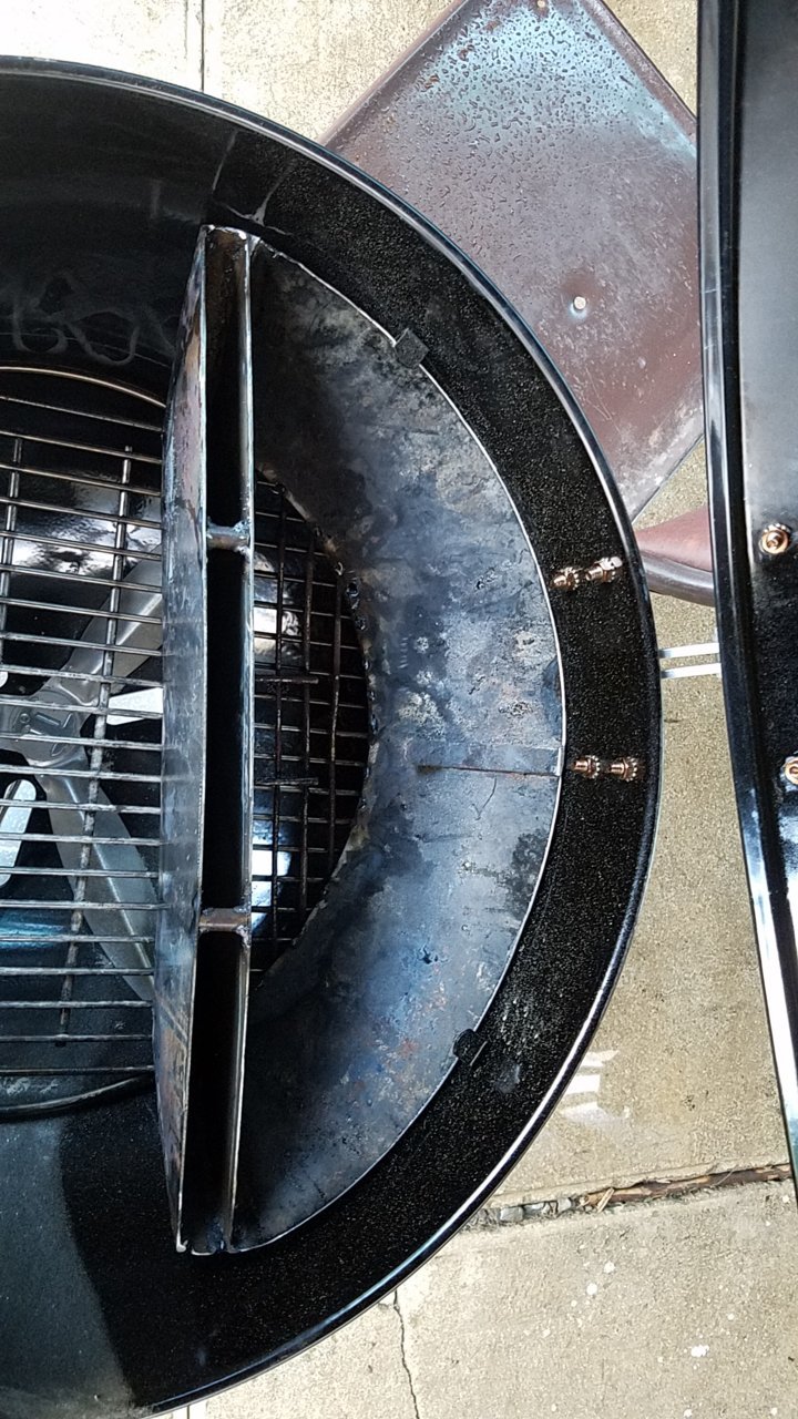

    Hahaha awesome! And that's what I did with the cone.. just left the cone in place
    Haha you think I'm kidding but I'm looking at TIG welders already! And I've learned a lot fr YouTube over the years!

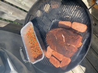

    Today is the only nice day this long weekend in SW Ontario. Doing a pork shoulder (pulled pork) and you guys got me hooked on smoked Spam. And smoked baked beans. First pc of wood is mesquite followed by maple chunks.

    Like that . Once made a "slow and sear " out of my old 22 webber . Going buy a vortex though . Dont got the skills to make that . Nice job.
  17. May 16, 2020 at 2:41 PM
    Kilo Charlie
    Kilo Charlie Disruptor
    Nov 10, 2011
    #66805
    11,181
    Iowa
    2017 Inferno Off Road
    Heck man if you can make that you can totally make a cone!
    It was actually pretty easy. I started with a piece of poster board and cut out a circle. In this case I used the charcoal bowl as a template. I then found center and cut out 1/4 of the circle and bent the two cut edges together.
    I taped the edges together and found the desired height and marked the cone for that. I then used my template to transfer the design to the stainless steel and cut it out.
    I used a shirt piece of 4" PVC pipe to help me bend it enough and used some vise grip clamps to hold it in place while I drilled and riveted it in place.
    Now if you read all the posts about it.. it was a bit tall and I ended up drilling some holes around the bottom with a drill press from the inside .
