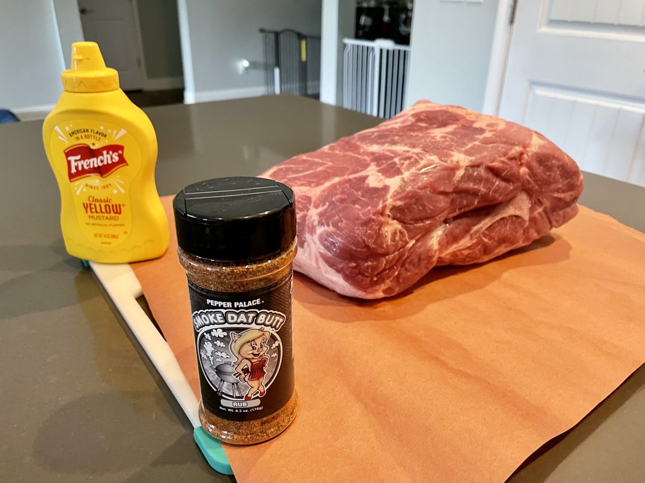

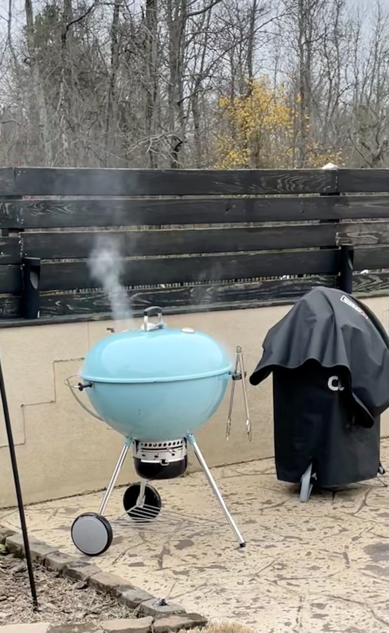

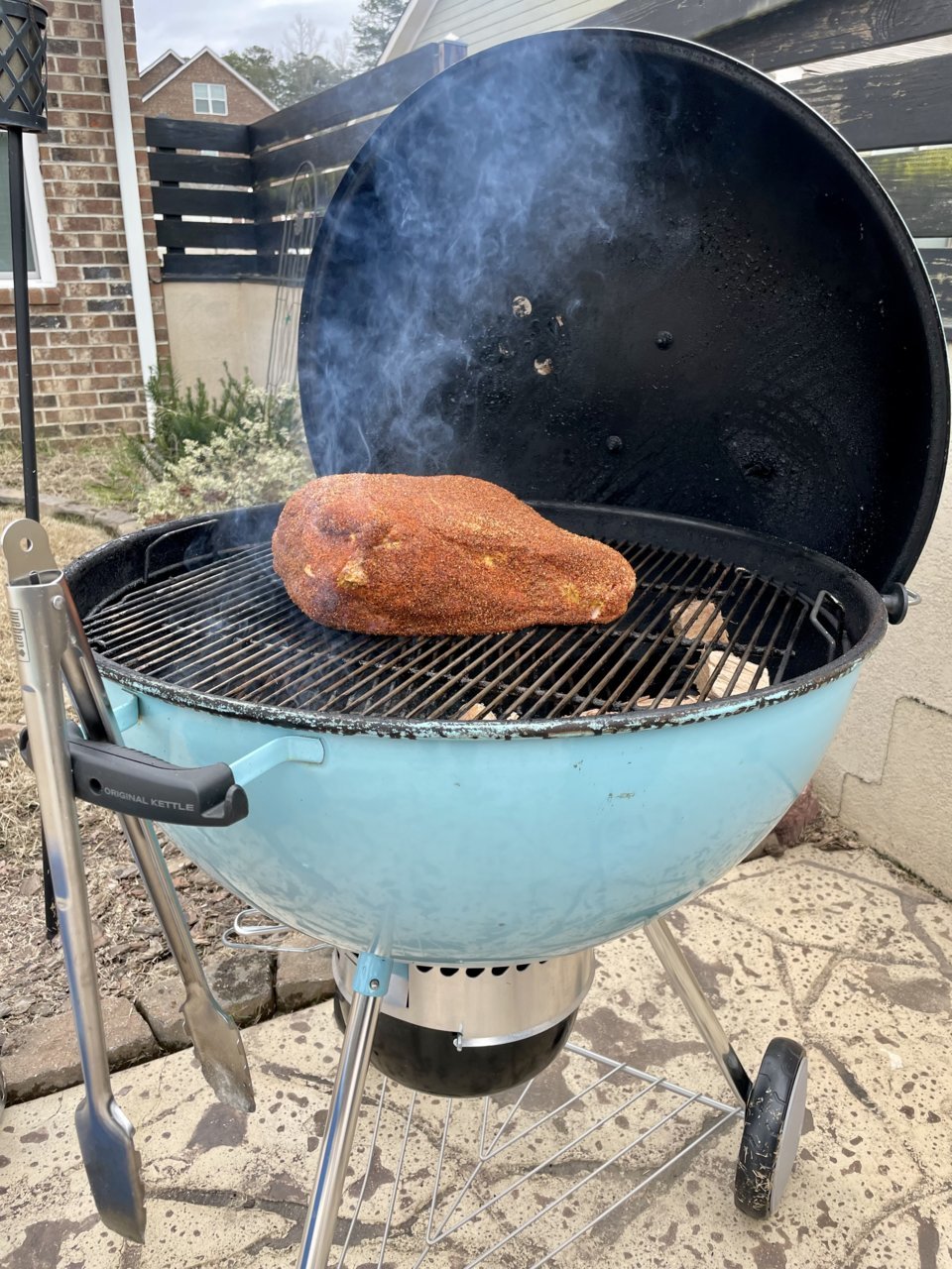

    Smoking a butt today

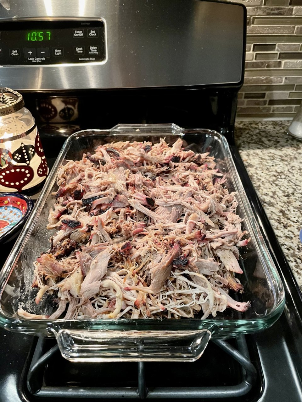

    Done. I didn’t use my normal homemade rub, much less flavor. Ah well, that’s what they make BBQ sauce for.

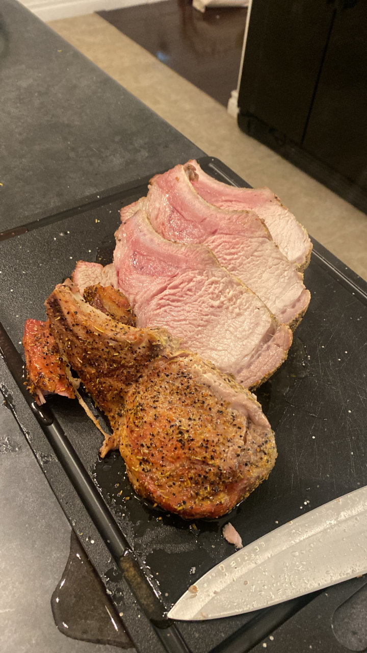

    Pork was on sale at the store today so I got a rib center roast, smothered it in mustard and “the usual” seasoning, threw it on the grill in smoker mode with some cherry chips for a few hours until I ran out of propane then transferred to the oven to finish. I was happy with the result, not a ton of smoke flavor but was definitely there.
