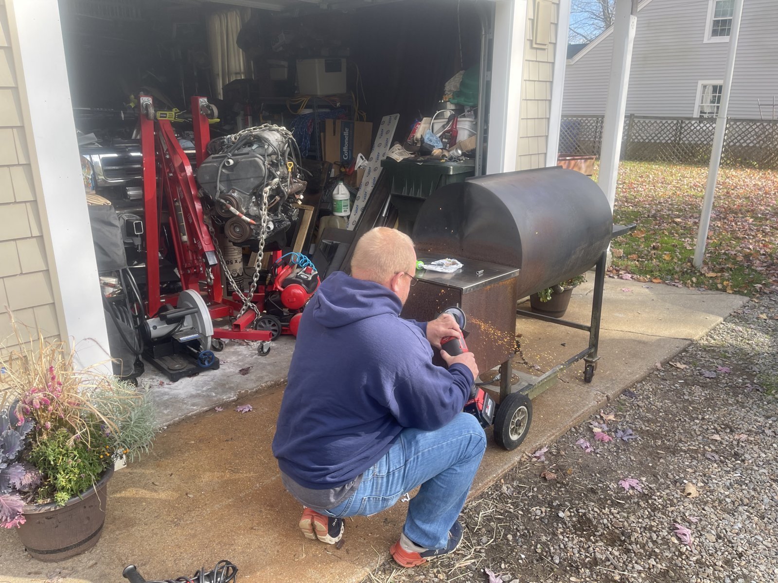

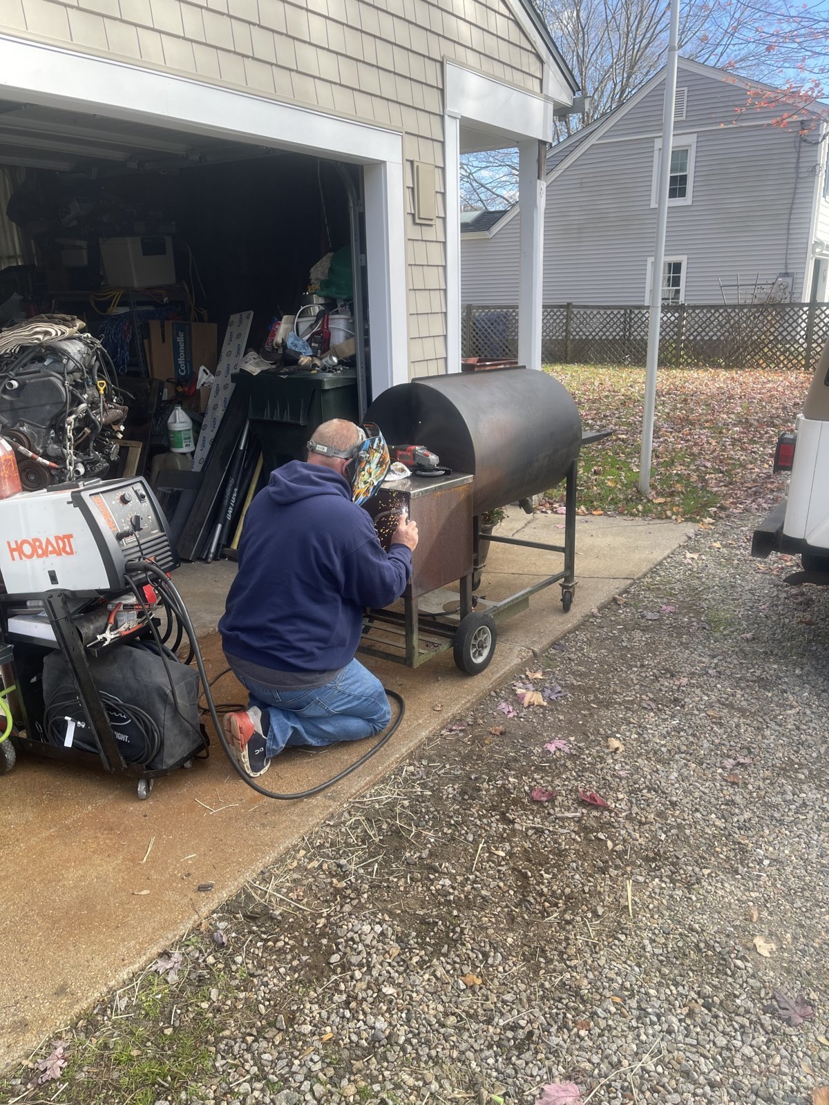

    If he doesn’t have any heavy duty switch magnets to keep the door in place, he could tack it directly to the firebox. Make sure the hinges are lined up before tacking! Cut and grind off the existing hinges, weld on the new ones, and grind the tacks off.
    I’m excited to see you get this up and running!

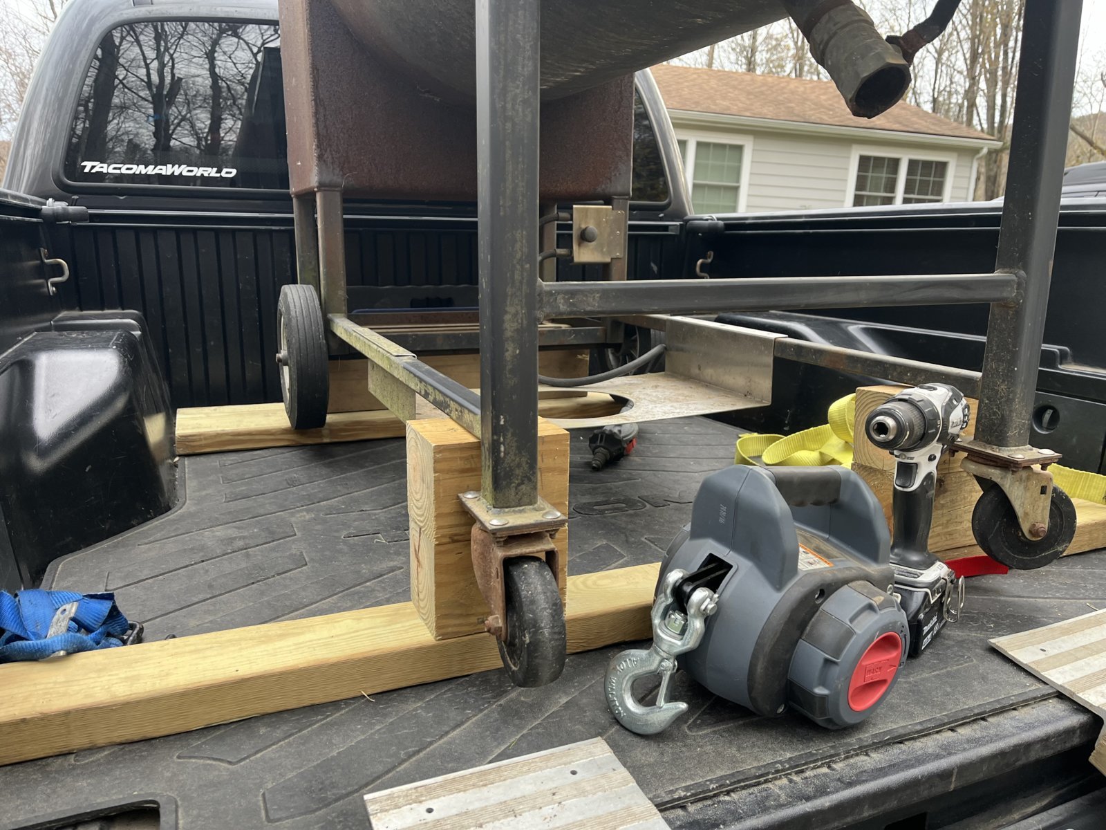

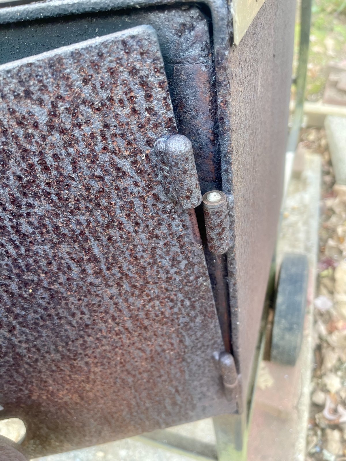

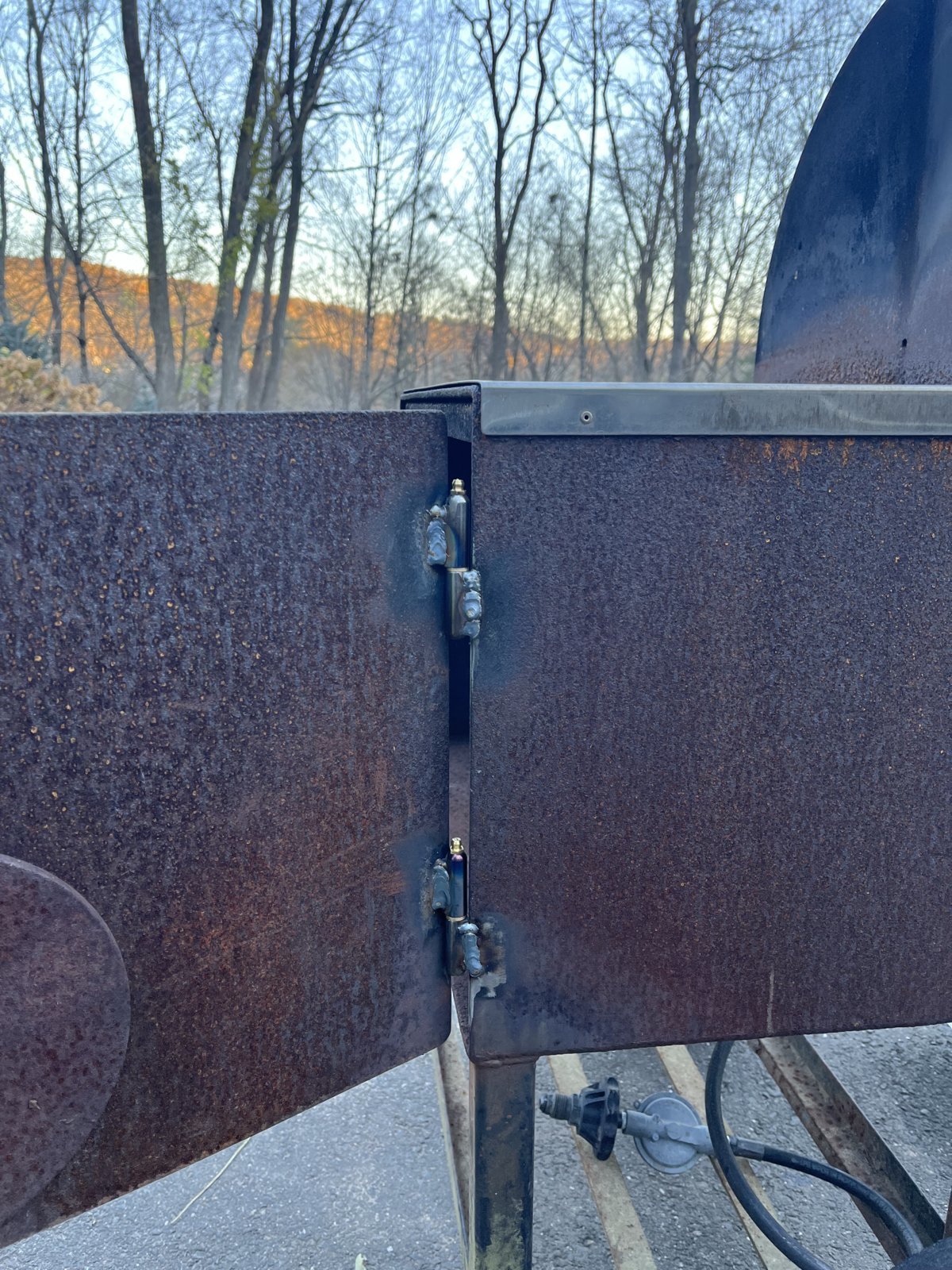

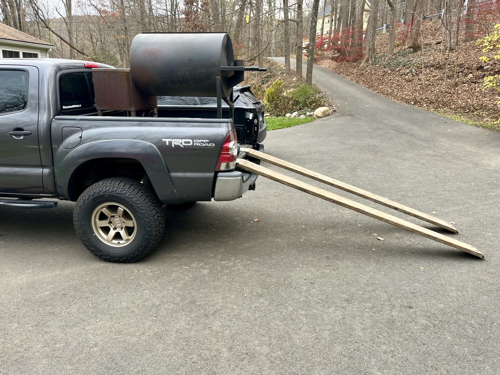

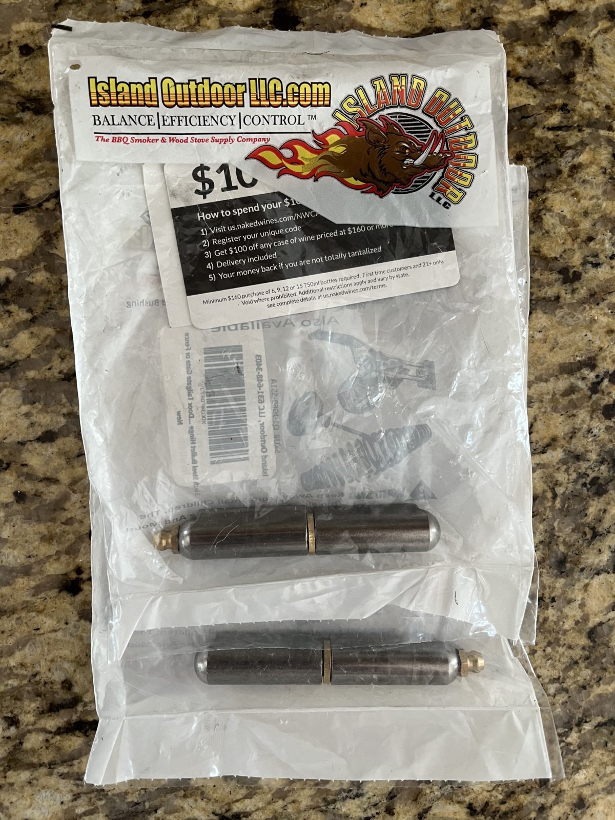

    Back in business. Coated the new welds and hinges with a quick spray of high temp black since getting it home.
    IMG_8937.jpg IMG_8938.jpg 72142875692__F9B0F882-D232-430F-A1E7-601344B0E53D.jpg
    Looking forward to firing it back up, maybe next week. Thinking I will sandblast and repaint the whole thing with some high temp paint next spring.

    Those of you that have zerk fittings on your smoker hinges- what are you using for grease?
    Obviously wouldnt come into direct contact with food, but thinking something foodsafe is needed vs the Lucas redntacky thats sitting in my grease gun for driveshaft lubing.
    Was thinking about pulling the door off and coating the pins with vegetable oil.

    Vegetable oil will get sticky ... hopefully someone has a better answer than me though

    I stumbled across this while googling after posting. Might give it a go unless someone has a better recommendation. I appreciate the insight on veg oil, thank you.
    https://www.olehickorypits.com/product/high-temp-food-safe-grease/

    I use the same grease as my truck on the firebox hinges, just a wee bit every 5 or 6 cooks. Chamber door hinges get a drop or two of canola.

    The canola doesn't get sticky?

    Not in my experience. The cooking chamber doesn’t really get above 350 and the hinges are far from the firebox. It’s not really a necessary step for my bolt style, though.
    The grease will absolutely melt out after while, thus the need to replenish. It’ll give the pit added character :thumbsup:
