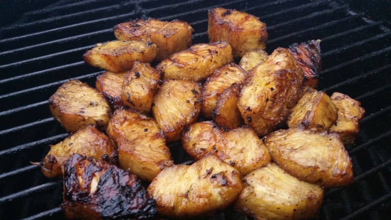

    Almost forgot the pineapple

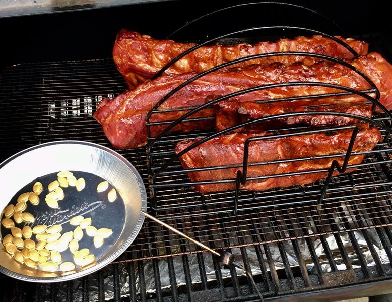

    Doing the usual ribs for dinner tonight, although 2 racks are just SPOG while the 2 1/2 racks have SPOG, cayenne, chili powder and paprika. My GF carved a pumpkin and we were just going to bake the seeds with some salt but I decided to experiment. Handful in the smoker on smoke mode. A handful will get seasoned salt, others a little garlic salt and another handful of just plain salt. We'll see whats best...

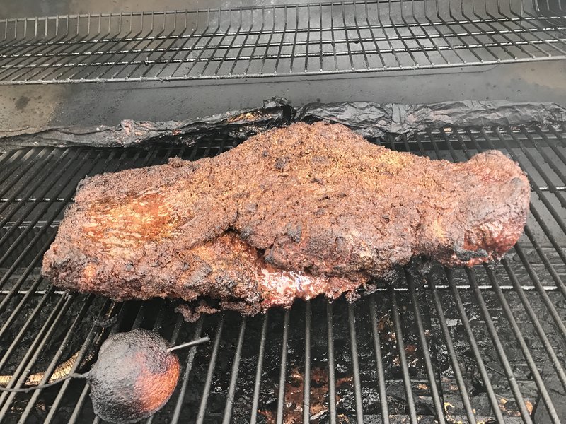

    So I must be doing something wrong with my high heat briskets but it still came out ok. Did my 2nd high heat brisket last Friday. Picked up a full packer from costco (12# before I trimmed a lot of fat off). Rubbed with SPOG and paprika and set it in the fridge overnight. Got the offset up to 325 and threw the brisket on at ~11am. Internal temp hit 170 at about 1pm and I decided to foil it then. By 2-230, IT was at 212 and it didn't quite pass the toothpick test but I was worried about letting it sit any longer. I moved the probe around several spots just in case I put the probe in a thin spot. It was about the same temp all over. Decided to pull it and put it in the cooler. Left it there for 3 hours.
    In the end, it wasn't as tender as I like but still tender enough, flavor was good, and was still moist. Smoke ring wasn't as prominent as I expected but in the end, everyone else liked it and ate it up. I may go back to low temp brisket on the next run just to give that another shot.

    My 3 high heat briskets have been awesome. Costco... Was it prime? My Costco sells prime which helps. Other differences are I go 350 till 160, then wrap tightly in foil until IT is 195-205. I then let rest for just 45 mins in cooler, no towels, still wrapped.
    Somethings sounds a bit hinky with your getting to 170 IT in just 2 hours at 325. Takes me 2.5 hours to get to 160 IT at 350, same size brisket. You sure your smoker therm is accurate? You measuring temp at the grill level, at least 1.5" away from meat and not touching metal?

    I can't remember if it was prime. Meat was good just this one had a bunch of hard fat (more than the ones I've been getting at smart and final). I'd definitely buy it again, just need to sort out my temp issues with the smoker.I didn't use any towels, just vented the foil pack and set it into the cooler. I left it in there for 3 hours only because I pulled the meat a lot earlier than I expected (230pm) and people weren't coming over till closer to 6.
    Agreed. my first thought was my thermometer (https://www.amazon.com/gp/product/B0000DIU49/ref=oh_aui_search_detailpage?ie=UTF8&psc=1) was off but Its been working pretty great so far. As far the grill thermometer, it was in the center of the grill about 2" away from the meat probed through a lemon with the end exposed (been doing it this way for a while)
    Next time I smoke, I'll be sure to have another thermometer handy to double check my usual mavericks. It still came out good but just not what I expected. I'll be giving high heat brisket a shot again but probably try the usual low and slow next time around.

    Yes, get another therm to double check.
    You say you vented, then into cooler? You should only vent for 10 minutes and then close back up tightly. That would definitely cause dryness.
