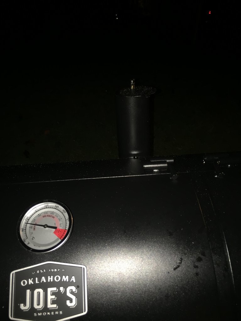

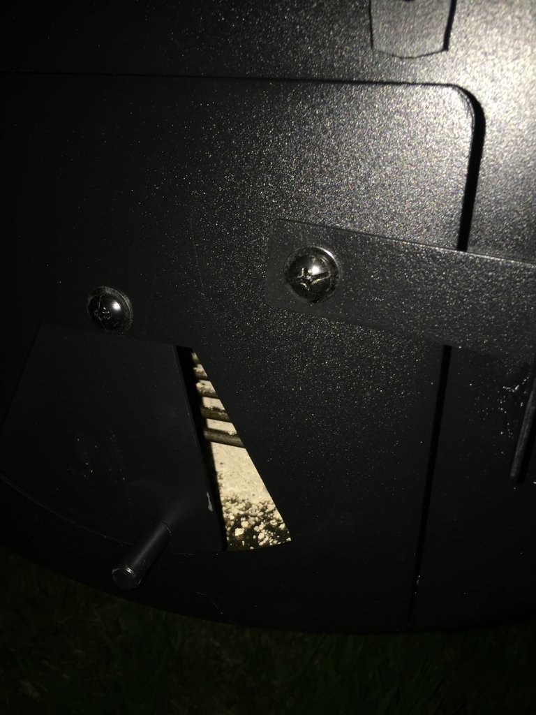

    Here's where I'm at now.
    WBF610 likes this.

    You're on the right path. Usually exhaust is full open and the temp is regulated by the intake, but I'll let the expert on that particular piece of equipment verify :D.
    Good luck! It's a fantastic hobby.
