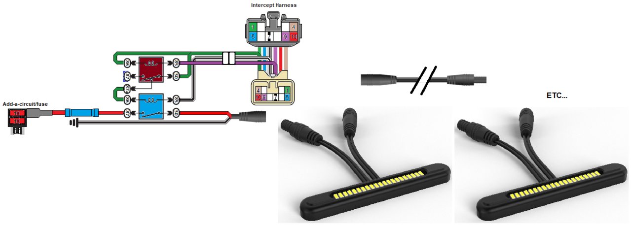

  14. Feb 8, 2022 at 6:08 PM
    #654
    caribe makaira
    caribe makaira Well-Known Member
    Feb 13, 2011
    #51121
    11,786
    Caribbean, Puerto Rico
    05 PreRunner TRD Offroad AutoTrans
    Hood Struts, My version Fogs always ON, Map & Overhead Light Mod,
    I wouldn't recommend it.
    For that it be best a separate/different approach, like adding a relay activated by PANEL circuit.
    Green is PANEL circuit, activates Blue relay.
    Violet on Red relay cuts power to Blue relay when door(s) are opened.
