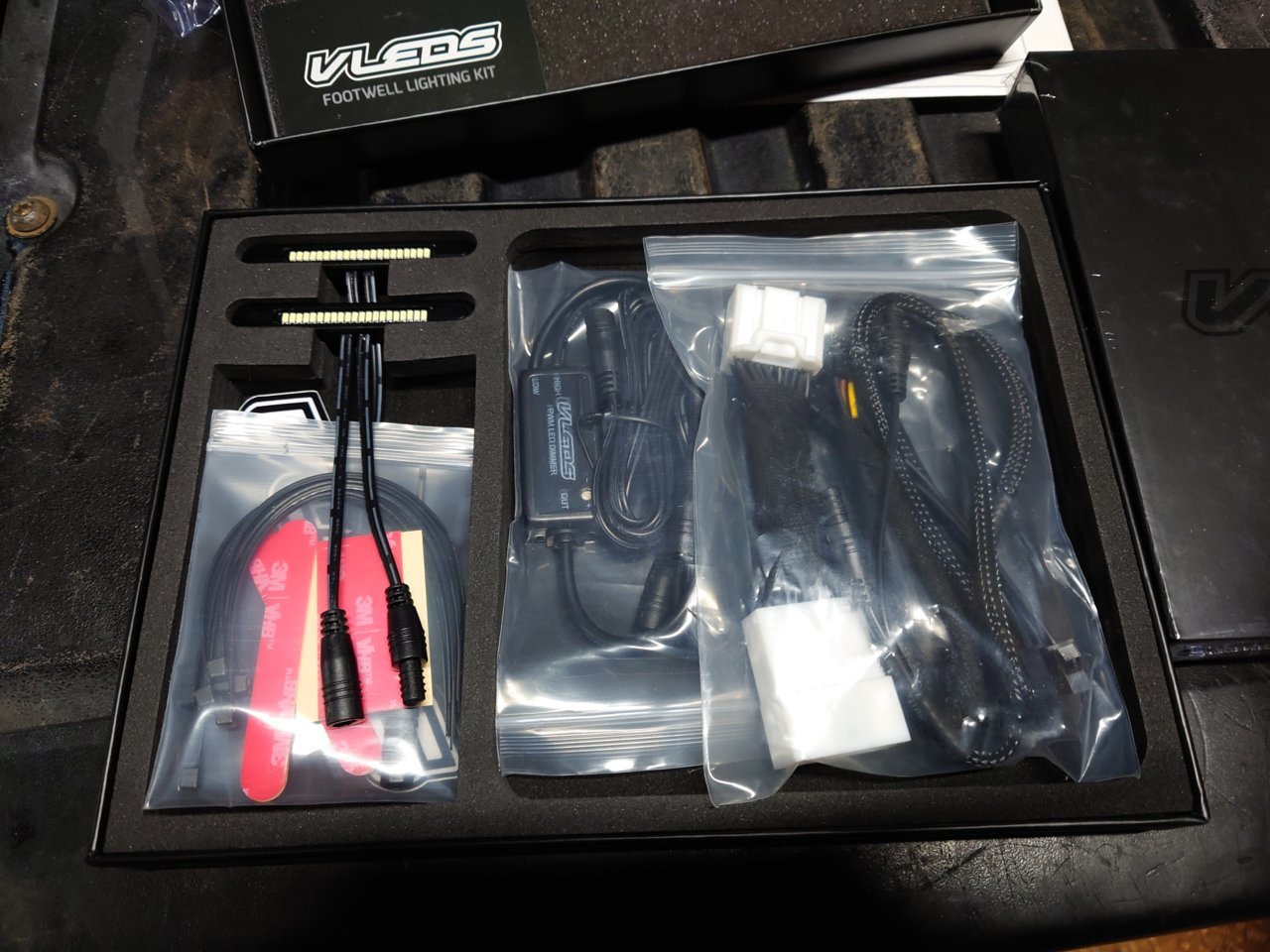

    Received my kit from VLED earlier today, will install in the morning. I must say the packaging oozes quality!

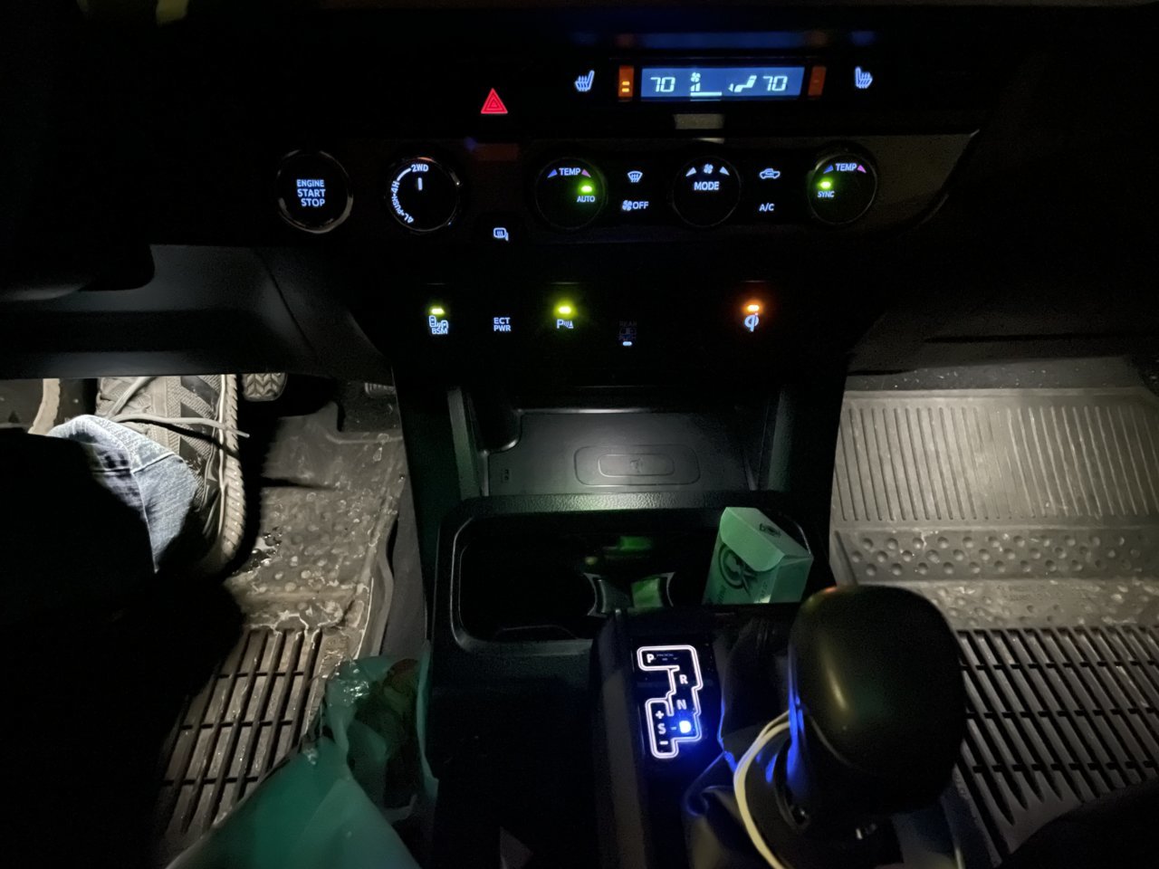

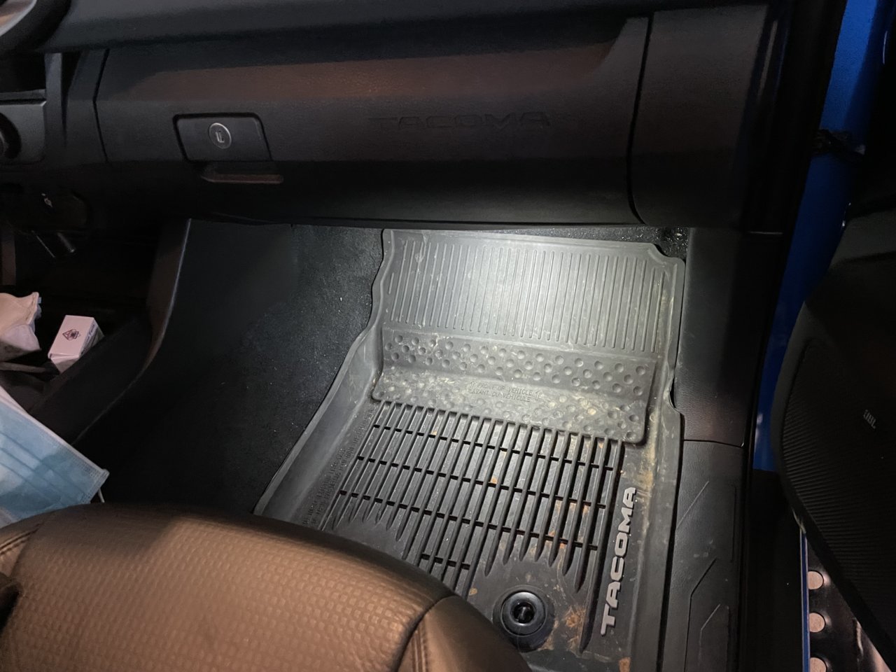

    20220207_165726.jpg 20220207_165556.jpg 20220208_200915.jpg 20220208_201024.jpg 20220208_201211.jpg 20220208_201050.jpg
    Blue is cool!:)

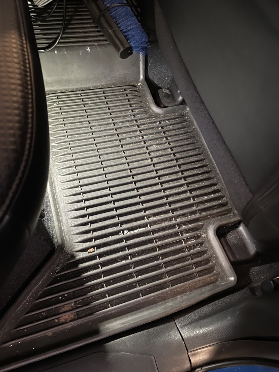

    Still have to work on the rear footwell lights.

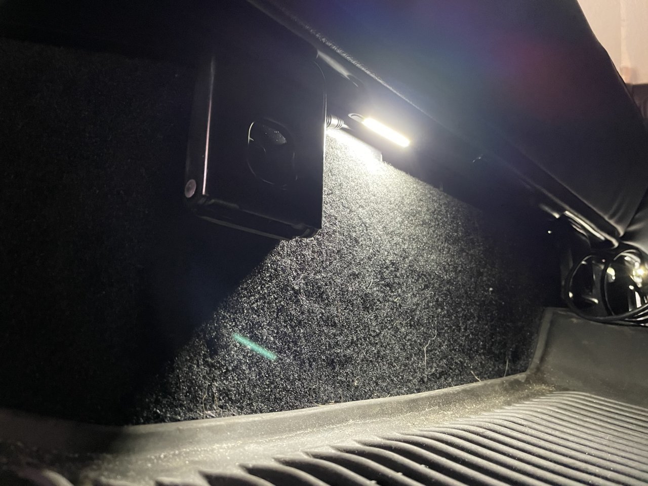

    I took off the right side kickpanel, front passenger kick plate, B pillar cover, right rear passenger kick plate. Pulled out the rear underseat cubby and routed the wire under the carpet from about the B pillar to the front of the cubby.
    It pops out right at the rear seat hinge:
    The connectors fit perfectly in the gap between the carpet and hinge. I don't have to mess with them when opening and closing the seats.
    If the wire was a bit longer from the front to the back I could have had the light fully on the rear seat instead of overhanging a tad but I didn't want the wire to be taught at all as I flip my seats often.
