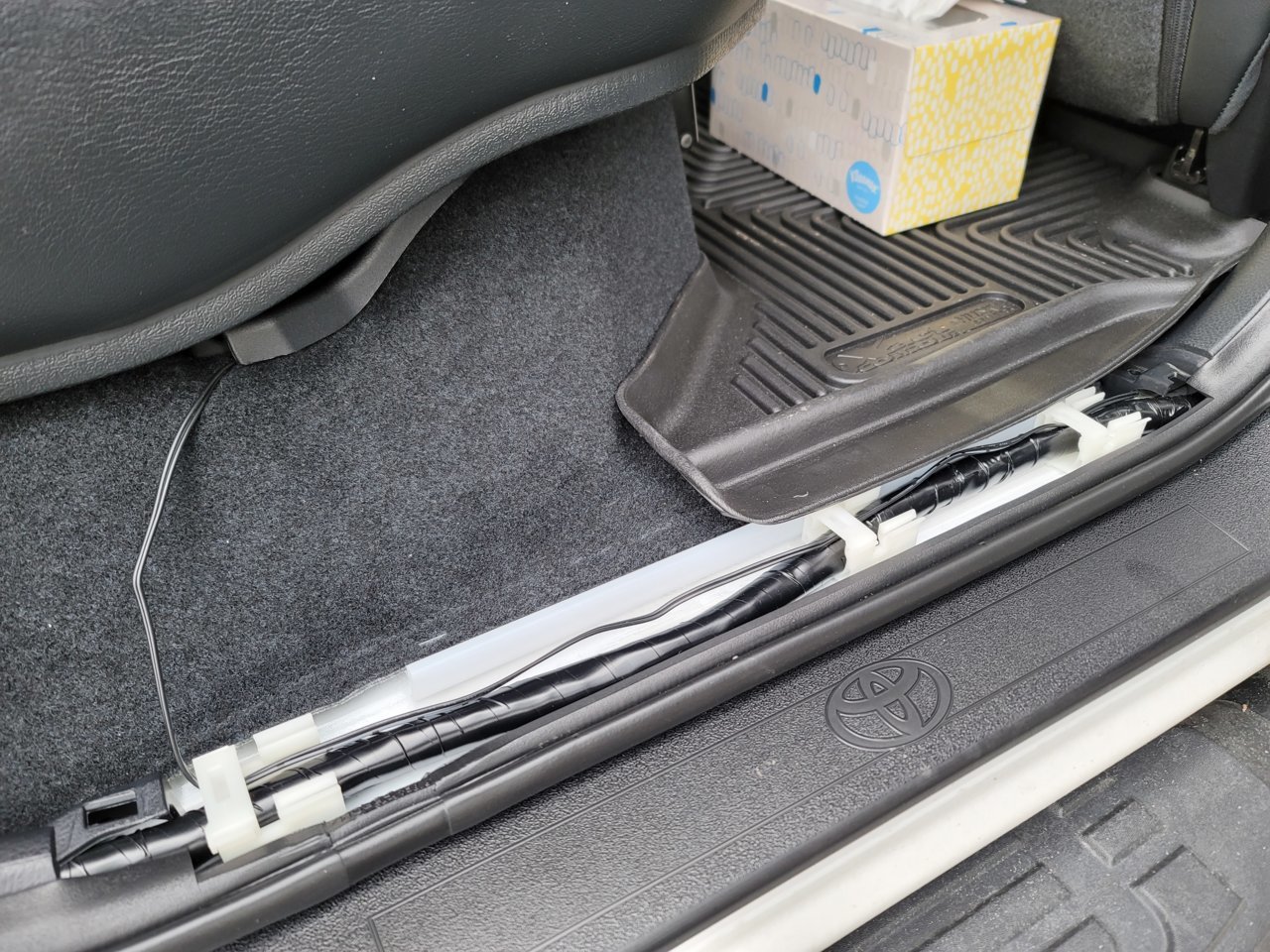

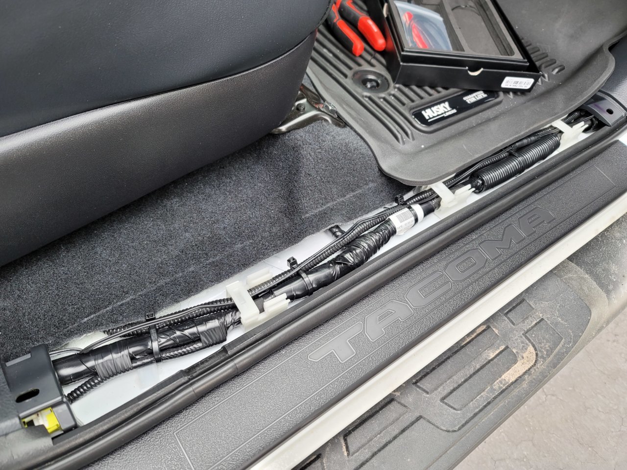

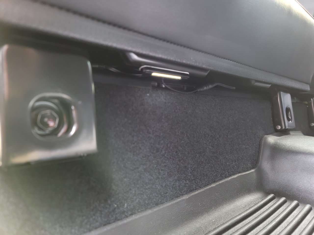

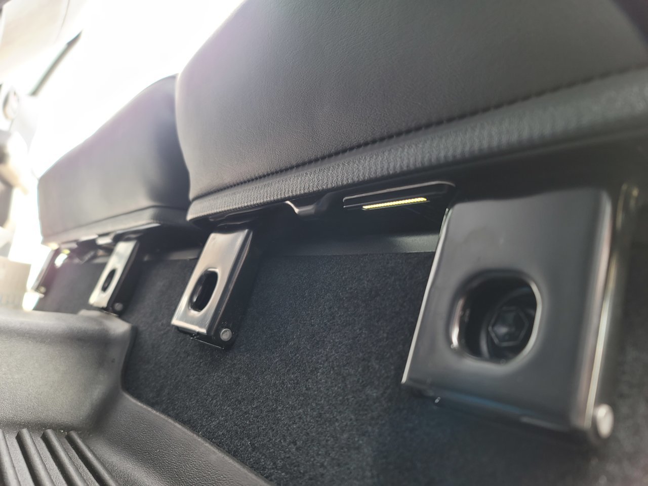

    Just got done installing mine. The longest part was messing around in the apillar section since I had the extra harness attached in there and also my dash cam wires. I routed the wire through passenger panels for rears and just mounted the led strips to the front of the rear seats. I originally was going to mount it to the rear of the front seats but I though this was an better option. I just have the wires tucked under the seats. I rarely fold my seats down.
    stealthmode, BOMBS, VicNic3 and 2 others like this.

    How do the sill covers come off? Do the just pop off using a trim tool? I've got rears coming and am looking for ideas on how to run the wires.
  16. Feb 12, 2022 at 1:18 PM

    Yes they just pop off. I just used my hands. I did remove the passenger side before to install the oem tail gate lock, so it was a bit easier for me.

    I had the same struggle with the harness in the A pillar. That took the vast majority of my time for the fronts.

    No problem! Did you have the extra harness as well? I couldnt really get the oem harness to sit straight towards the bottom.

    Yes, the Pros have them, too. I had to move the OEM harness cable some and maneuver things around to get it to fit.
