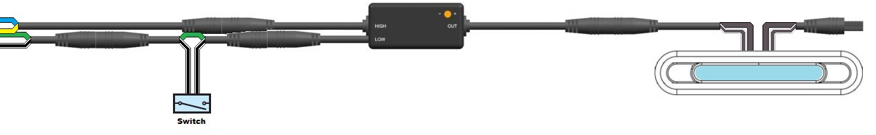

  16. Feb 15, 2022 at 1:01 PM
    #836
    TacoSupremo19
    TacoSupremo19 Well-Known Member
    Nov 24, 2019
    #311587
    1,289
    John
    NJ
    2019 Black Tacoma TRD SPort DCSB
    Brushed Copper Blaze 10 Rims | 265 70 17 Toyo Open Country A/T III tires | Bilstein 5100 w/ Eibach Coils 2.5" lift | Blackhawk UCAs | ICON Rear 3 AAL |TRD Skid Plate | TRD CAI | OEM Rear Bed Lighting | OEM rear Tailgate lock | RC Bed Molle Racks | Custom Blacked out OEM LED Headlights | MESO V4 Mirror Turnsignals | MESO Interior trim blackout | TG DMM dash mount | TRD Shift Knob | OEM SR5 interior door handles | Upgraded Stereo including Alpine 700W Amp Alpine Type R Components & Hertz speakers 12" Sub | Custom Clazzio Seat covers | Mobtown Sliders | Front Camera
    I would like this but I don't want any lights on while I'm driving but I'd like to be able to switch on the lights while I'm driving, if needed, and have it work the way the interior lights function when the doors open/ close and such. Keep it as close to stock "looking" as possible.
    If this has been discussed I apologize. Thanks.
    corgimas likes this.
  17. Feb 15, 2022 at 1:57 PM
    #837
    caribe makaira
    caribe makaira Well-Known Member
    Feb 13, 2011
    #51121
    11,781
    Caribbean, Puerto Rico
    05 PreRunner TRD Offroad AutoTrans
    Hood Struts, My version Fogs always ON, Map & Overhead Light Mod,
    Tails need to be ON for switch to work.

  19. Feb 15, 2022 at 2:18 PM
    #839
    caribe makaira
    Feb 13, 2011
    #51121
    11,781
    Or this:
    Full Bright when ON.
