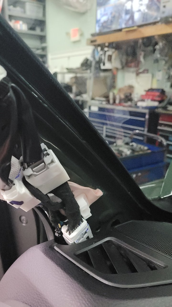

    You're saying leave the connector unclipped? What does it do? (Or doesn't do once it's unclipped?). I was able to get all the connectors clipped in, with the nasty bend, but doesn't seem to strain anything too hard.

    Same thing i did. I just tried pulling the oem harness towards the bottom more where it clips into the side of the dash.

    No no — I’m just talking about the retaining clip that attaches the harness to the vehicle itself. Absolutely plug your harness in :rofl: unless you don’t care about your map/dome, ATRAC, VSC, sunroof, etc.

    I decided to “unclip” my harness at the dash retainer location to create a more gentle bend in the harness. That way everything was able to remain clipped inside the a pillar location and didn’t require a harsh bend in anything.

    I just did my install last night and I also have the two connectors. Talk about a huge pain in the ass. I was able to clip everything back in and I think it’s okay. I don’t even want to try to install puddle pods now haha

    It’s not going to be anything ground breaking. You will remove the clip that retains the 25-pin from the bracket holding the 25-pin and the neighboring connector to the truck. Then you will connect the breakout harness per the instructions, and instead of putting it back into the retainer clip you’ll leave it loose and stuff the slack down into the a pillar (see Chloe’s video). Zip tie where appropriate. However, it’s still possible to get a clean install even with the harness re-clipped to the retainer:
    I have the dual in my truck and it’s not a huge struggle. Feel free to cut more zip ties off to get yourself some slack but be extremely careful you don’t knick anything.

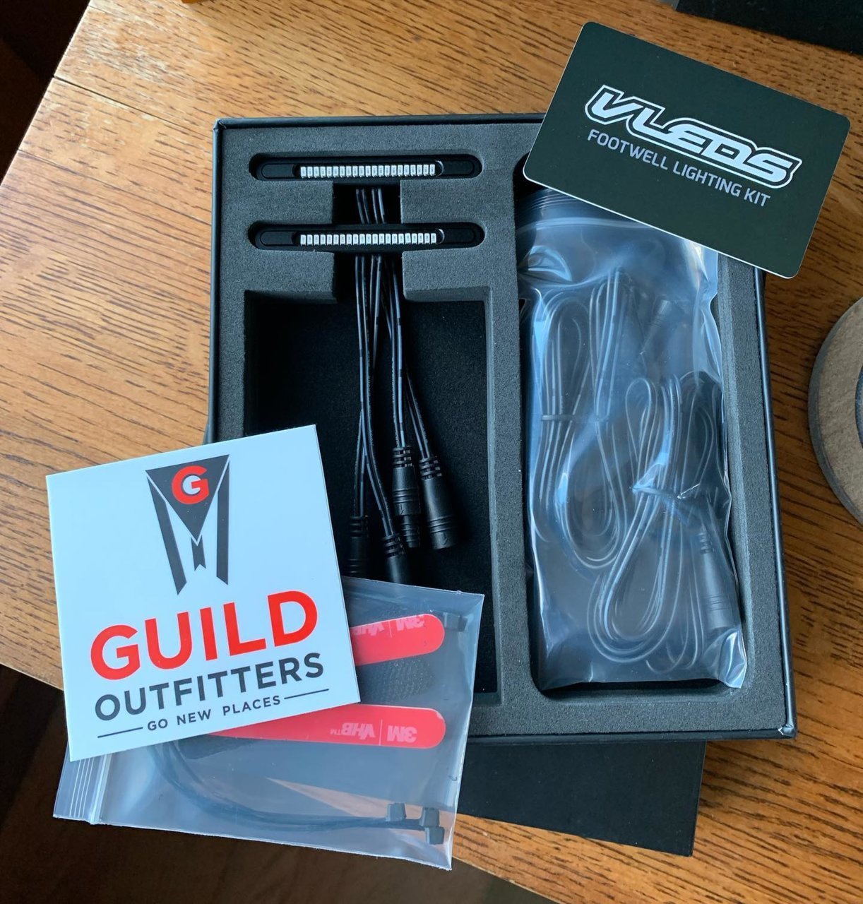

    Got my rear set of red VLEDS footwell lights from @GuildOutfitters today - hope to get them installed tomorrow!!

    Ordered mine from VLEDS. Is it plug and play into the front set?

    Yes
