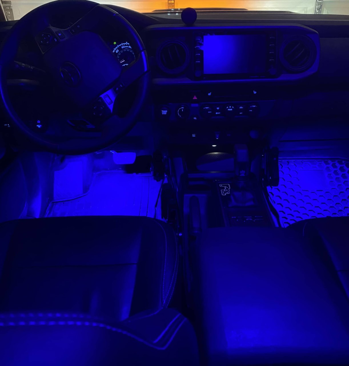

  18. Feb 27, 2022 at 8:50 AM
    #998
    tclavell
    Aug 7, 2020
    #336897
    12,481
    Troy
    Phoenix, AZ
    G70
    If I got a lane departure malfunction what could that mean? I’m checking all my connections again
    Footwell lights work but there error is present. I did remove negative battery cable during install
    Edit: removed negative battery cable again and all is good! :thumbsup:
  19. Feb 27, 2022 at 8:59 AM
    #999
    kmorgan3
    kmorgan3 [OP] Redside Electric, LLC | VLEDS
    Aug 22, 2019
    #302994
    1,952
    Kyle
    PNW
    2020 4Runner SR5 Premium | RAM 1500
    If you have the 2 connector design in the a pillar, try re-seating the connector that neighbors the one you put the harness on. Or it could just not be happy because you messed with that connector in general, and when you re-cycled your negative terminal it went away. Weird stuff happens. I installed a prototype on my 2020 4Runner and had something similar. It never came back, though.
    tclavell[QUOTED] likes this.
  20. Feb 27, 2022 at 9:21 AM
    #1000
    tclavell
    Aug 7, 2020
    #336897
    12,481
    Troy
    Phoenix, AZ
    G70
    Completed product. I really like the blue! Nice easy install. Hardest part for me was getting my fat head far enough under the footwell to fish out the wires
