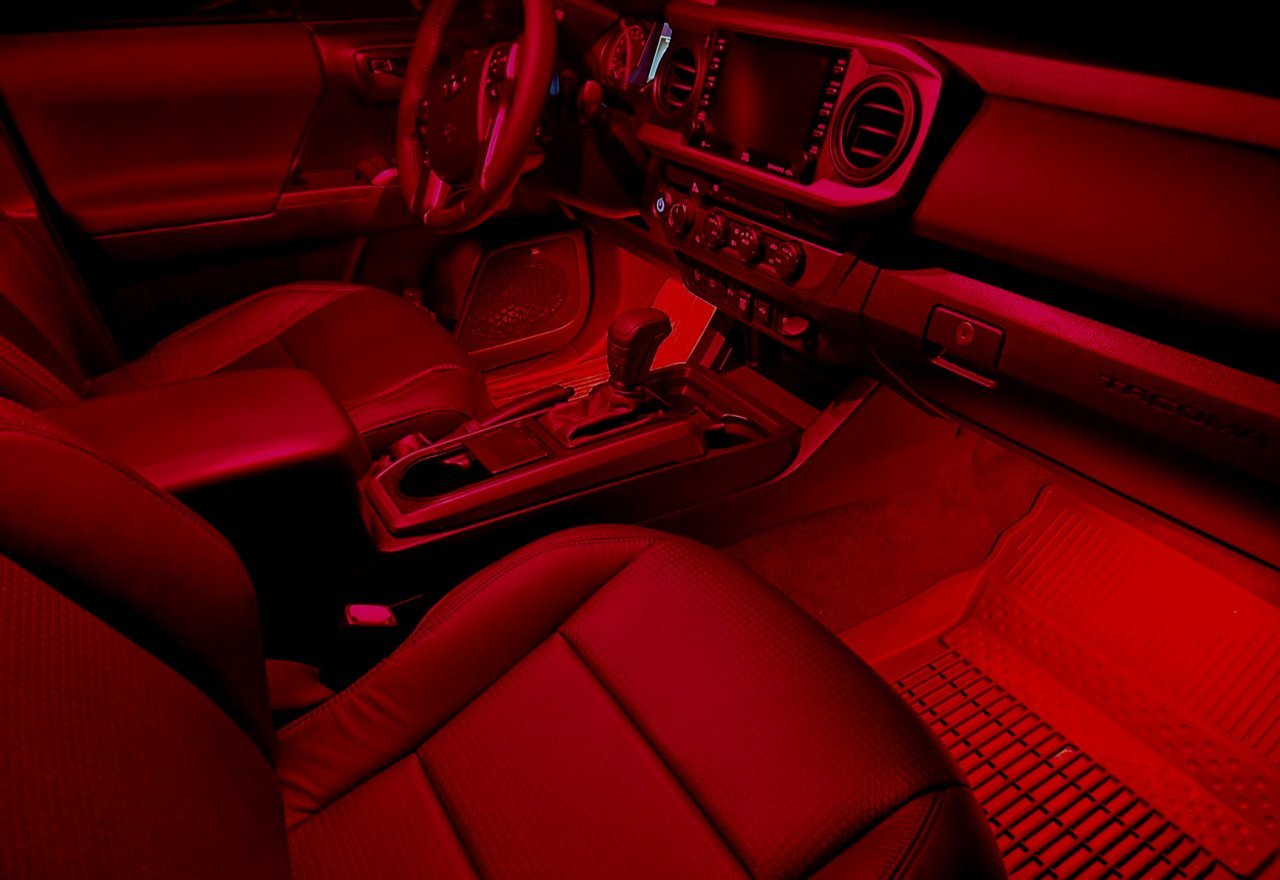

    Also did this. It’s very subtle, but if you know, you know.

    X-files? :rofl:

    I want to believe.

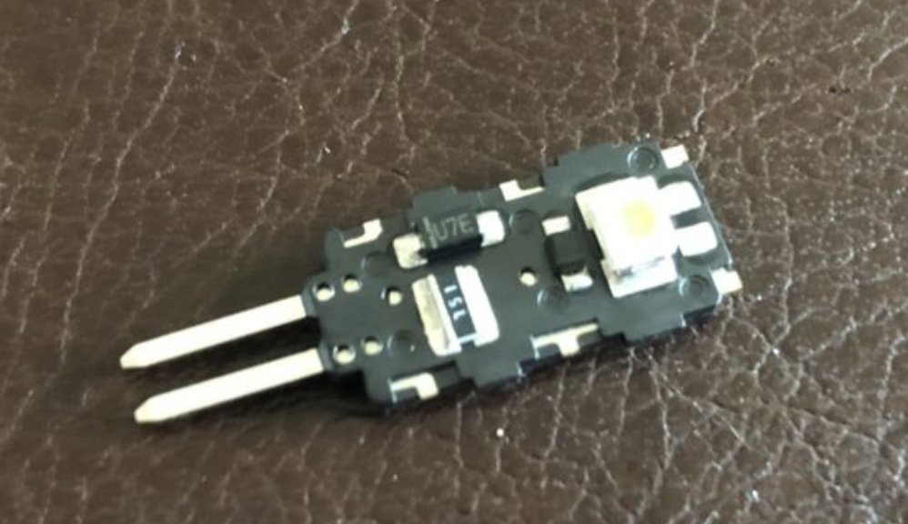

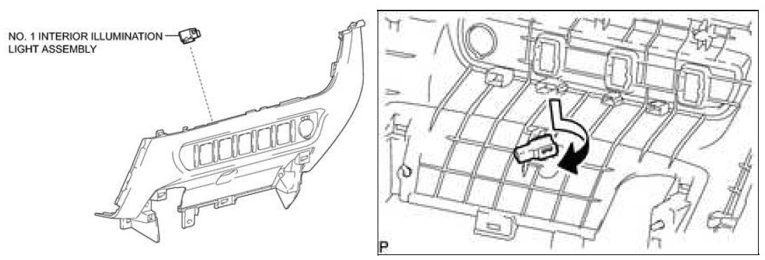

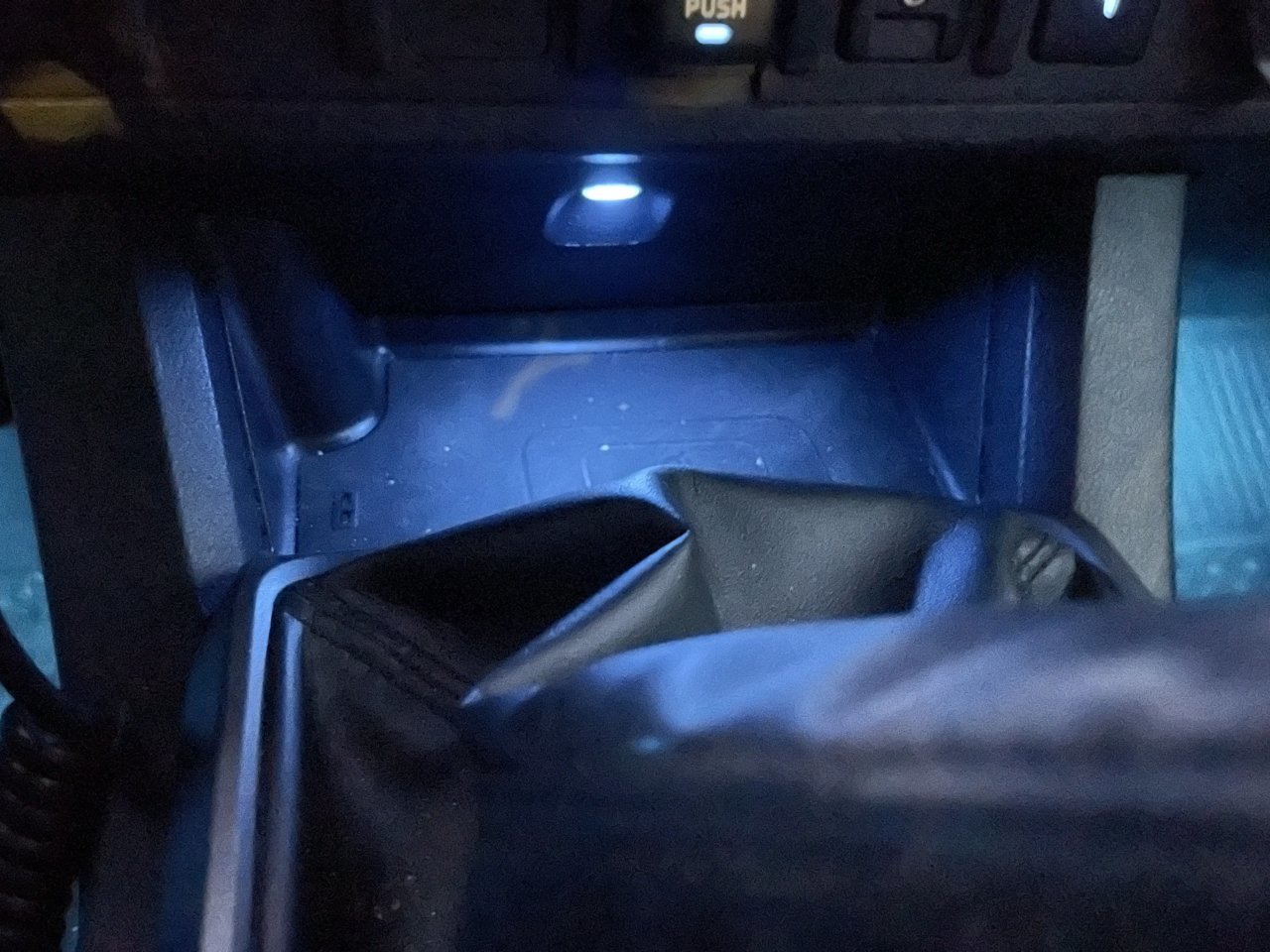

    Okay, how did you access that light and what bulb does it take? Couldn't figure it out, so put a piece of red clear tape over mine.

    It's a connector with an LED built into it, I'm sure more skilled minds and hands than mine could swap it out, but that wasn't necessary for my case. I reached in through the head unit hole and swapped it out, and my hands/arms took a beating.
    Tacoma part number is 81080-12100 with white illumination.
    RAV4 part number is 81080-42040 with blue illumination.
    Direct swap.

    So that thing is surface mounted. If you really wanted to get a different color you could, you'd just need a hot air station to melt off the old one and then melt the solder for a new one:
