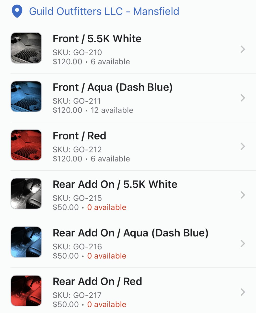

    Anybody still hunting for Front’s we’ve got some 5500k, Aqua, and Red still in stock and I think Hotshot has some except Red reading their website. Happy lighting ya’ll :cheers:

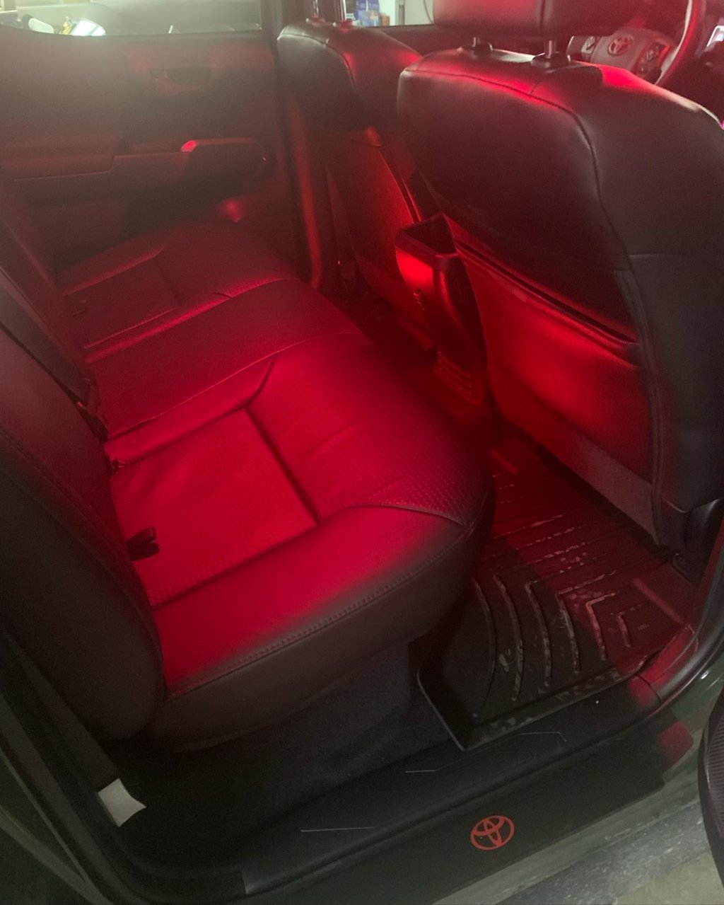

    Bed cover, step bars, SCS SR8 wheels
    Looking for a set of red front and rear…

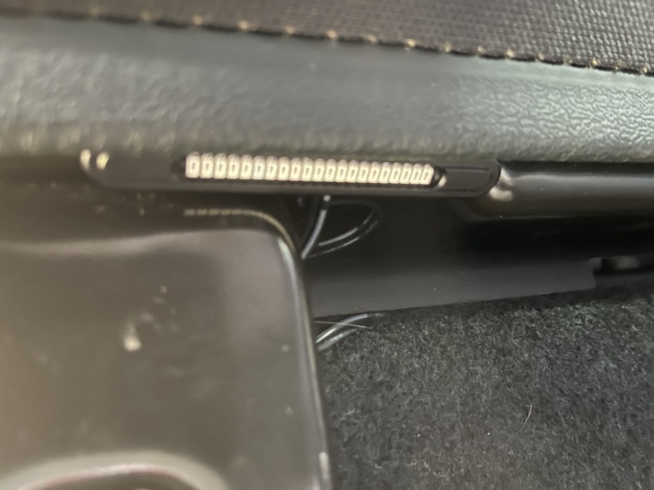

  3. Mar 4, 2022 at 3:24 PM
    #1023
    ljerr2
    ljerr2 Well-Known Member
    Oct 20, 2018
    #270010
    333
    Iowa
    2020 Tacoma TRD Pro

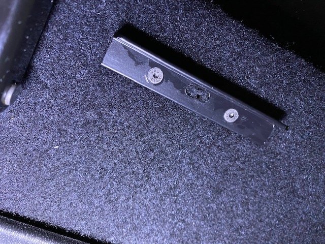

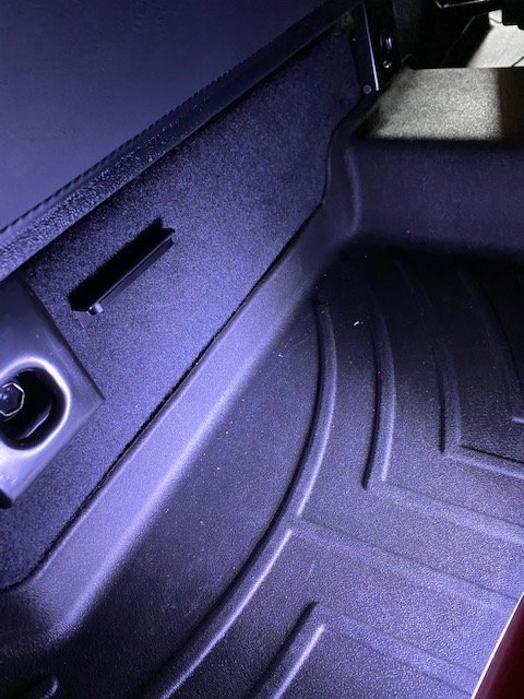

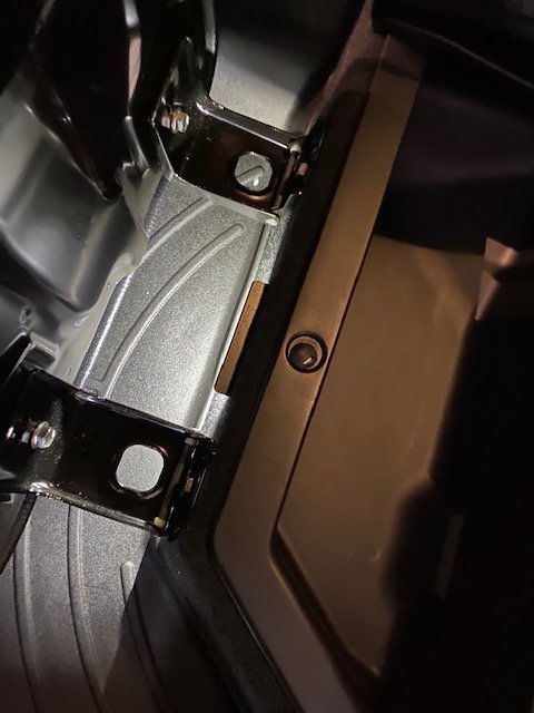

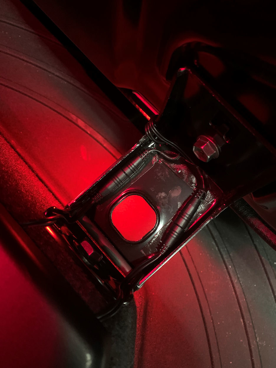

    I know it is a bit more of a pain to do, but I installed my rear footwell lights mounted to the rear cubby wall. I just didn't like the idea of moving wires when opening/closing the rear seats for access to the storage well. I took some 1/2" aluminum angle and made some 3" long brackets. There's an existing 3/8" hole on each side that's convenient for running the wires through and it's pretty much centered where you want it. I did end up hard-wiring my lights and getting rid of the QD's because of the diameter of the connectors compared to the existing hole but it's a permanent install anyway. I used M3 countersunk screws to secure the brackets with flanged locknuts and it is very secure and I think the finished install looks great.

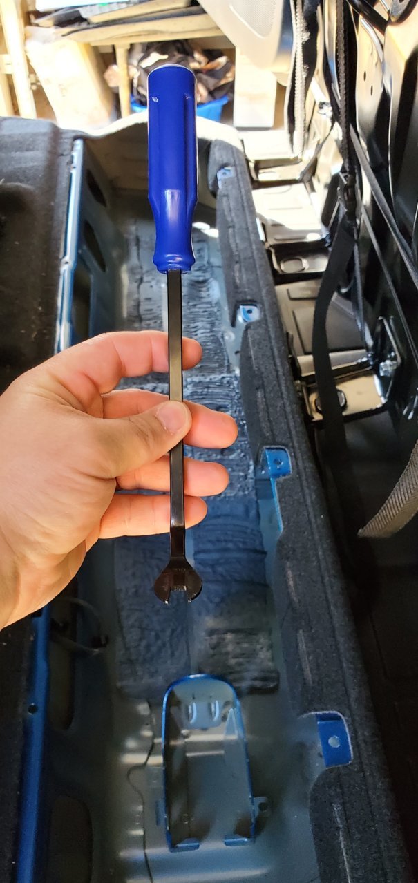

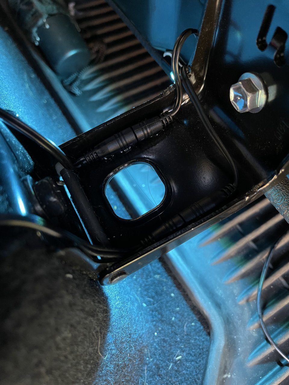

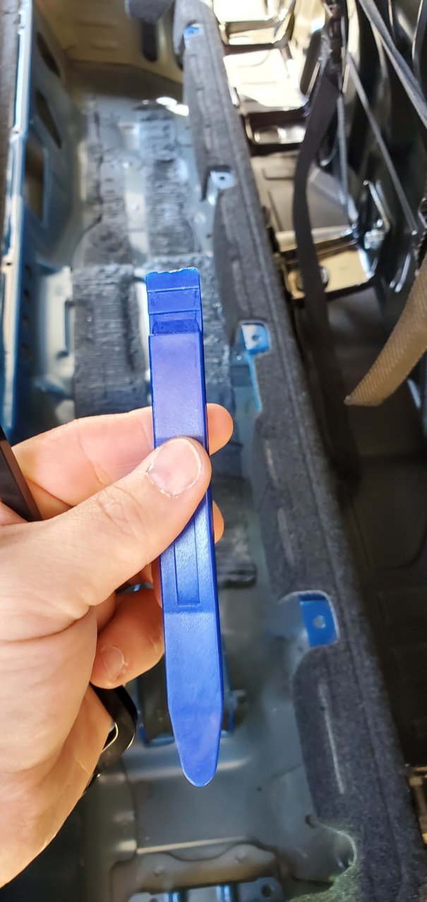

  4. Mar 4, 2022 at 11:46 PM
    #1024
    playdixie
    playdixie Miss'ippi fella
    Apr 2, 2020
    #323619
    1,119
    Jason
    Mississippi
    2016 Blazing Blue TRD Sport DCSB 4x4

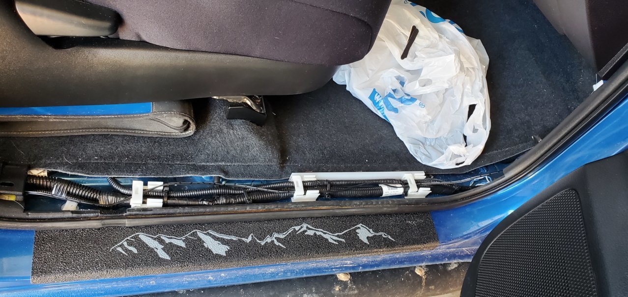

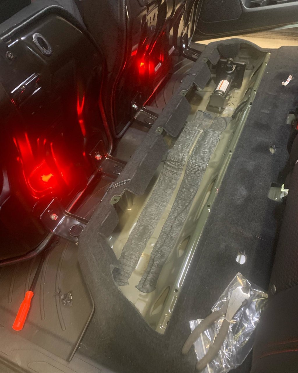

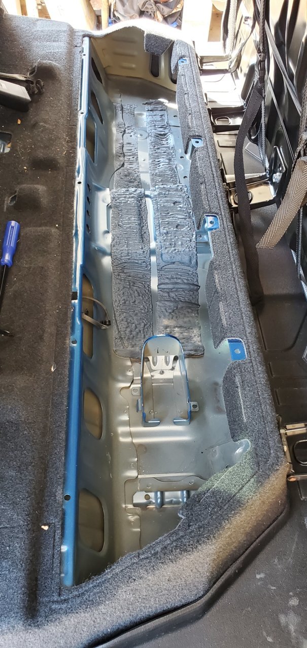

    So I wanna give a HUGE thank you to @TheCochese. I followed your write up pretty much to do my rear lights install.
    I only wanted to add a few pics in case some one might be confused on somethings.
    Removed the under seat storage:
    I'd recommend these trim removal tools. My plastic screws didn't wanna come out.
    Front and rear covers removed

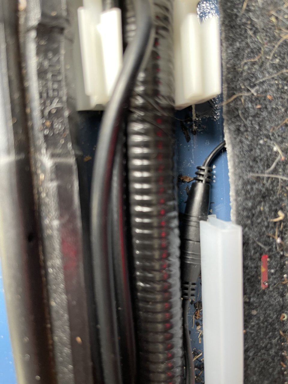

    I used some doubled sided 3M tape I had left over and put the wires up under the seats
    Front and rear lights

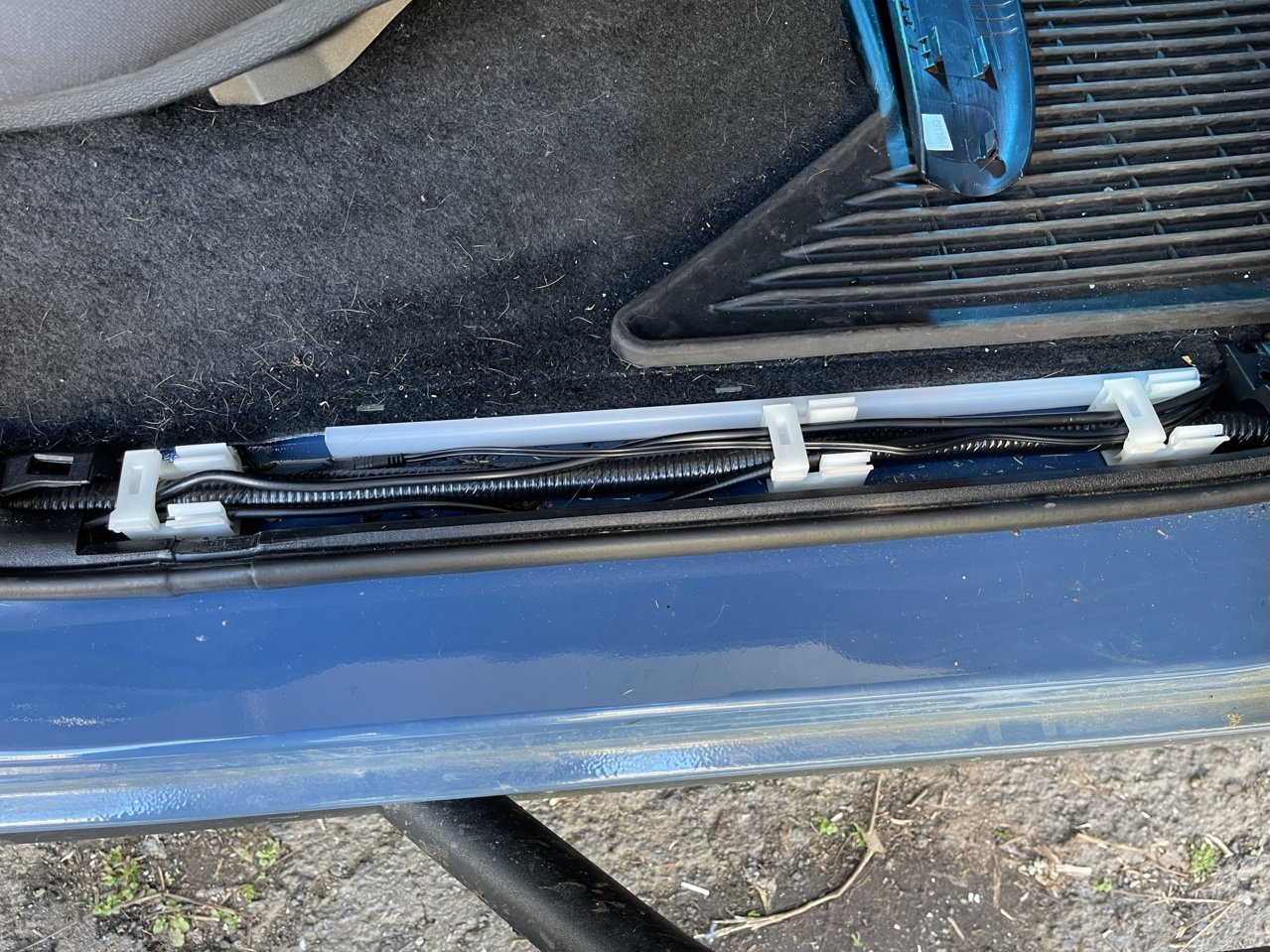

  5. Mar 7, 2022 at 8:45 AM
    #1025
    Devious6
    Devious6 Not your Average College President Emeritus
    Jul 15, 2011
    #59910
    6,784
    Mark
    Northeast Pennsyltuckyvania
    2020 Army Green TRD Pro

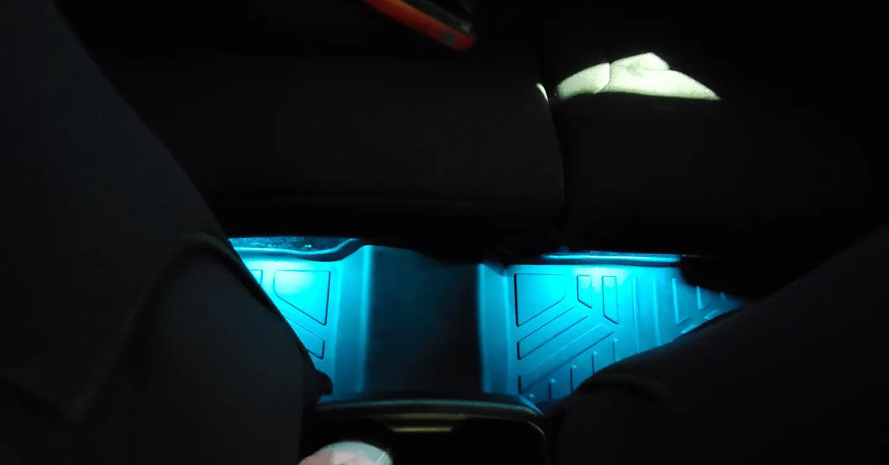

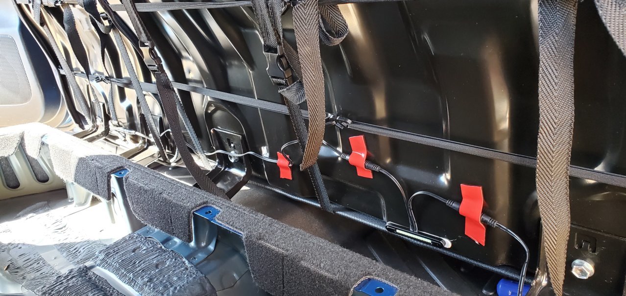

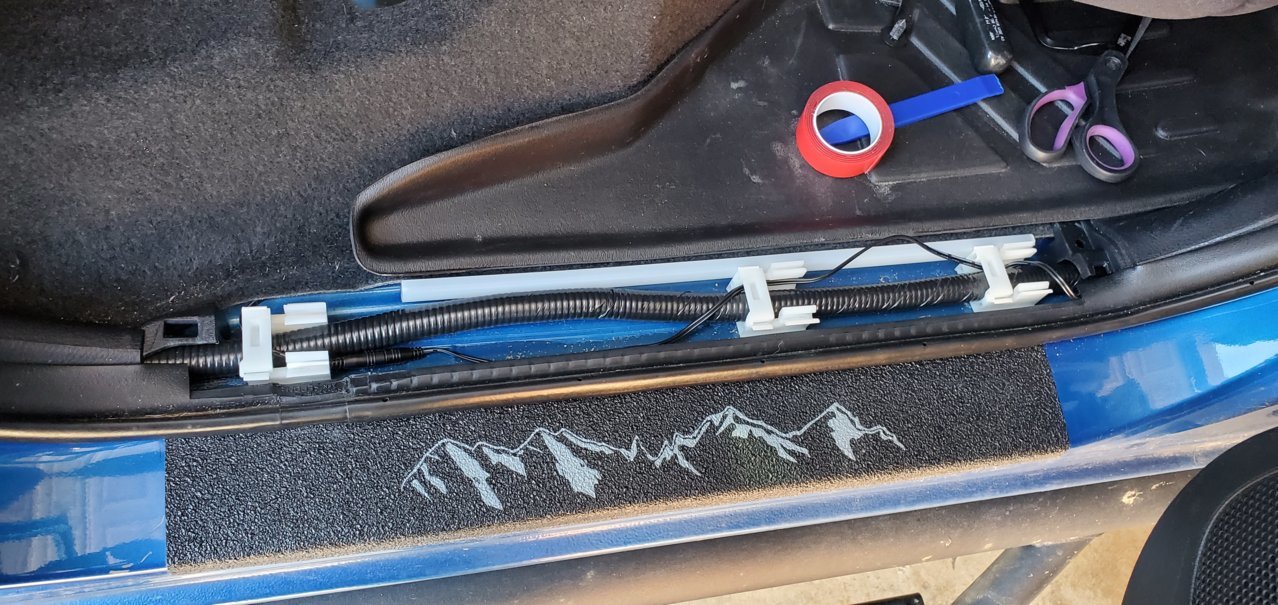

    I decided to move/re-wire my rear lights - tried placing them on the top of the rear wall of the footwell but when you turn your head to look out the rear window they just glared in your eyes. I followed @TheCochese 's example. I used 1/2" black 3M tape to secure the wires/connectors instead of glue - seems like they will hold well. Now they are perfect!

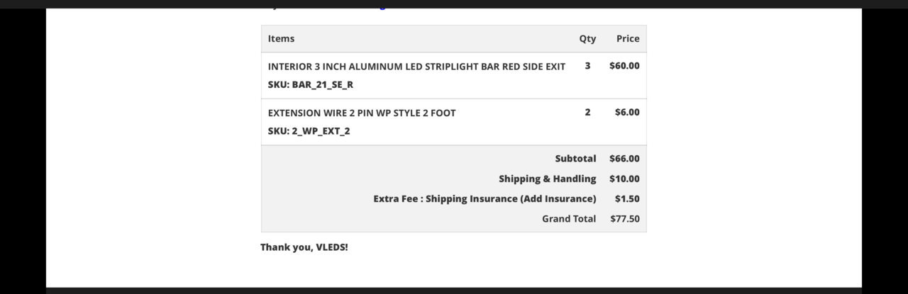

    I want to purchase some replacement 5500k white. I'm going to try them vs. the aqua. I think it'll look better when opening the doors. I know VLED has them here, but is that for a single one? So it would be close to $40 for the new set (just the fronts so x2)? Just want to confirm before purchasing.

    If you want the same ones that came in the kit, you'll want the "side exit" version. They are $20 each on the VLEDS site.

    Isn't that the ones I shared in the link?

    No. Look for the side exit version if you want the same type that came in the kit. The wires should exit the LED right next to each other.

    Found em! Thank you. These ones

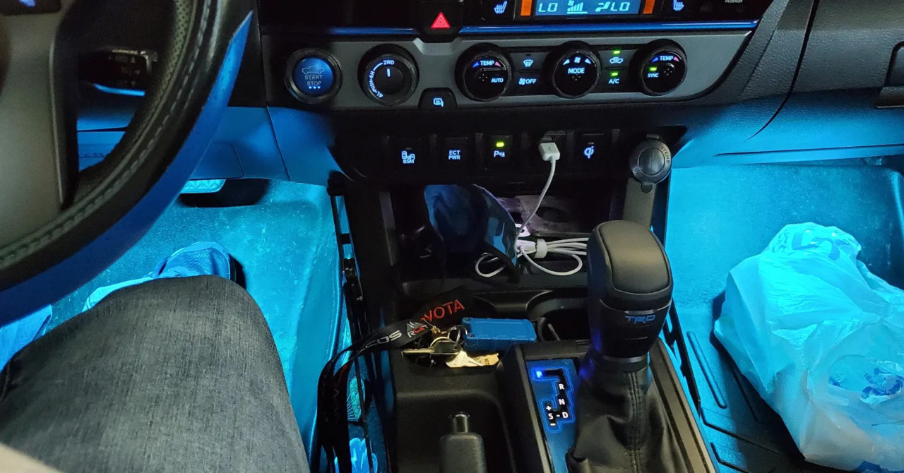

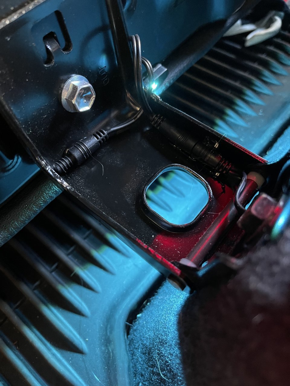

    Another thanks to @TheCochese for the tip on the blue Rav4 Qi spotlight. Got mine this week, excit
    Man my forearms are sore and my fingers even more so but I'm pretty stoked on that mod. Probably way easier with the panel removed but it is doable from the reacharound. Thanks for the part number and the idea, this one bothered me a fair bit I think. Excited to see it tonight.
    ETA: Photo. Oh, and, yes I'm working on the fugly seat heater switch, I have some OEM aqua ones, need to get those swapped...
