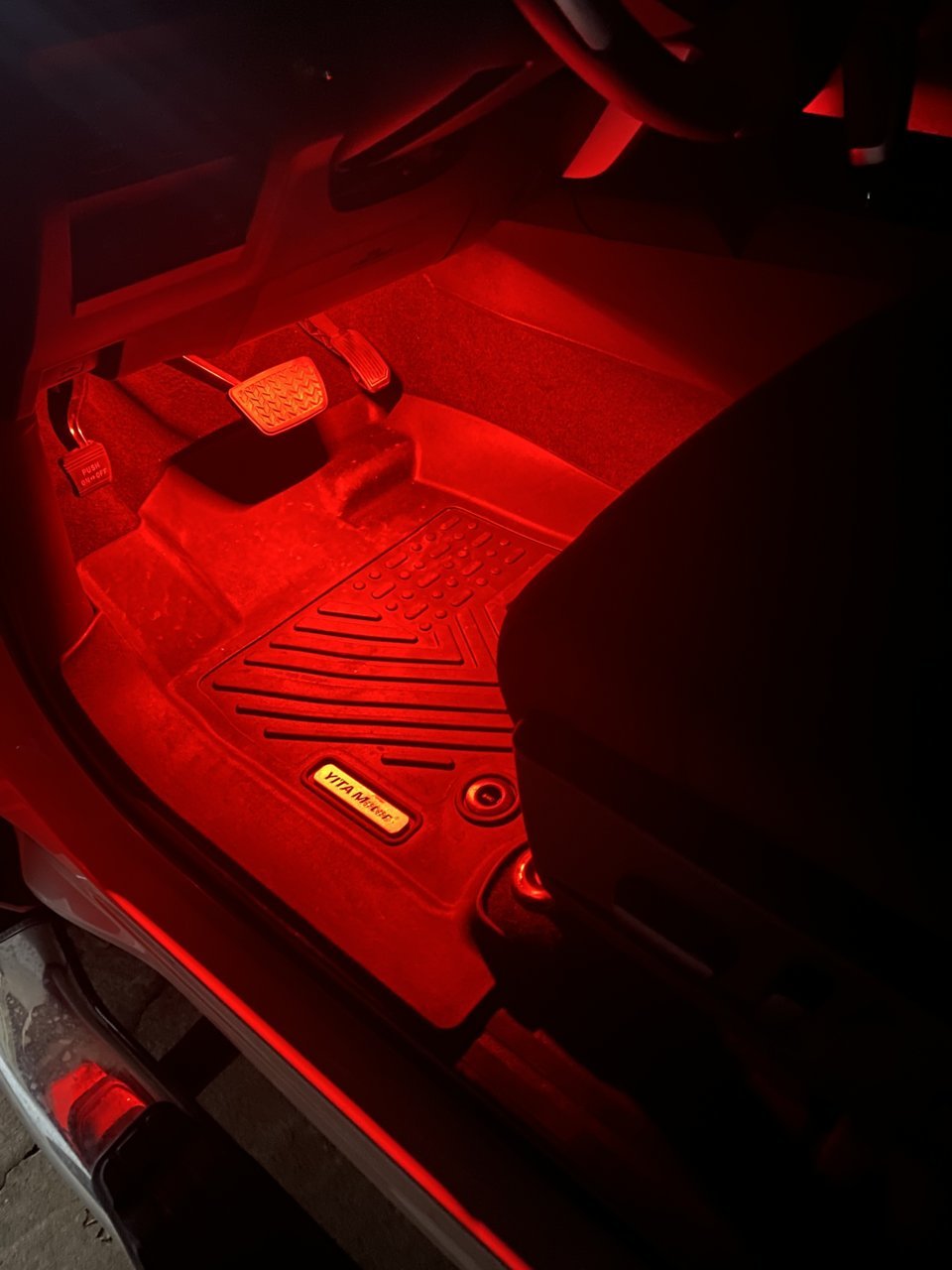

    I did my fronts in my tundra the other day.
    Great with Dual color maps and dome.
    only did the front as I’m not sure if I want red also in the rear or run white in the rear.
    Might just run the reds and rear and see how I like it. If not an easy switch to white
