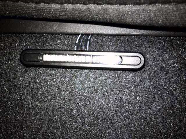

    Installed my rear FWK today. Due to my Wet Okole covers I decided to go the Velcro route and I think it came out great.
    Routed the wires under the passenger side kick board, then behind the seat and then under the carpet.
    From there I went under the cubby and just had them come out from under the edge. Velcro is surprisingly strong.
