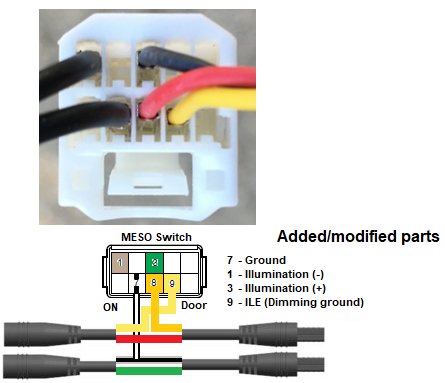

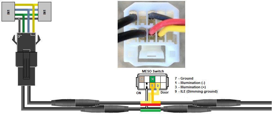

    Is it possible to add a switch to these? I was wondering if the Meso puddle switch would also control these if it was connected before the splitter? Not a big deal I just like being able to turn off all my lights if needed.

    So what exactly do I need to do for this? Probably way over my head. Thanks

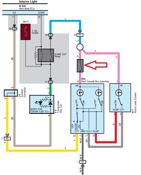

    But now that the masses are satisfied I'll get my grubby mitts on these. I'm tired of the interrogation bright map lights in my face. But I want some light at night when I open the door.

    You could interrupt the map lamps illumination by adding an on/off switch at R44_15 and leaving the push to ON selected.
