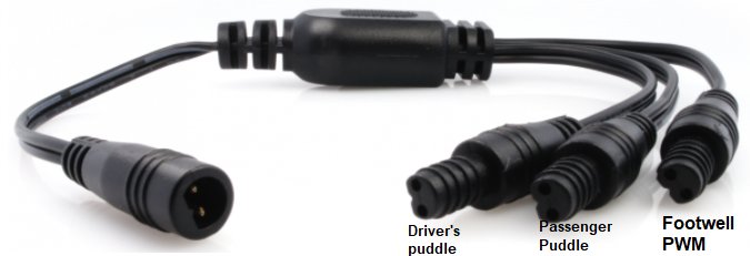

    Yep that is an option at the HIGH input to the PWM. Use a splitter on HIGH and break it off into a PWM feed and then 2 long WP extensions directly to the puddle lights.

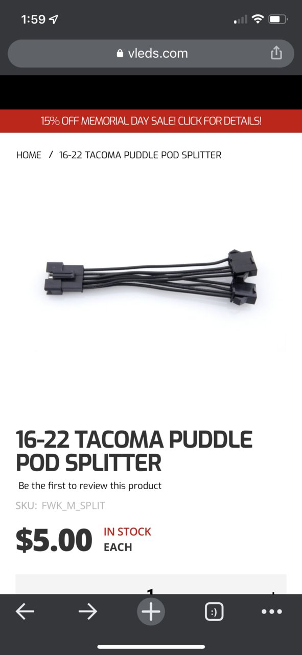

    So what the difference between that and this? Don’t they both allow you to use all 3 of the lights v5, pods and footwell?

    Only the JST splitter I designed will allow you to use all 3. Caribe is illustrating that a 3-way WP splitter would allow you to use the puddle pods and footwell lights only using WP connectors (no JSTs) which is lighter weight for those only using those 2 accessories. You wouldn’t need to open your a pillar again going that route, in theory. Some know-how is required.

    Ok I don’t know all this wiring nomenclature but I’m trying to learn. So just get what I posted and I will be all set

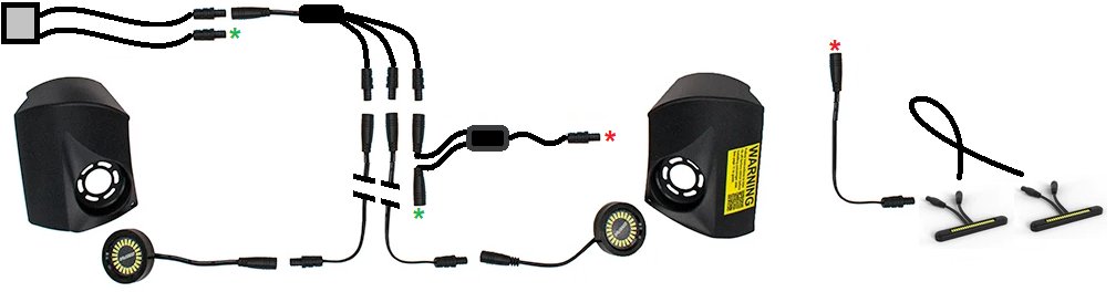

    I'm assuming we need 2 of these (1 for each side) if running Meso puddle pods and VLEDS footwell lights?

    Should only need one AFAIK, and you need to be using the VLEDS a-pillar T-harness. You would plug the Meso splitter into one side of the VLEDS splitter. The VLEDS footwell stuff plugs into the other side of the VLEDS splitter. The VLEDS splitter plugs into the VLEDS a-pillar harness. The Meso puddle a-pillar harness has the wrong pin quantity in its connector so you can’t use the Meso harness for anything but puddle pods. I had already ordered the puddle pods when I found the footwell kit so it made sense to go ahead and do those too for mine. I didn’t know to order the harness though as I thought it came included (it used to be). No big deal though, $5 and ships fast.

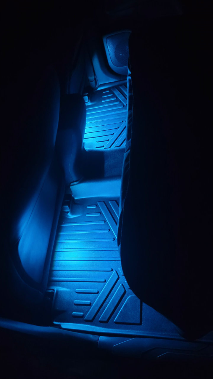

    Finally added my rear footwell kit. I was procrastinating because I thought it would be difficult, but I think they were easier than the fronts. I used the 8ft extension to run from the front to the rear, then used the 4ft to cross over to rear driver side. I did not use the second 8ft that was included in the kit, however I do love the fact it was prepackaged with more than enough extensions for us!
