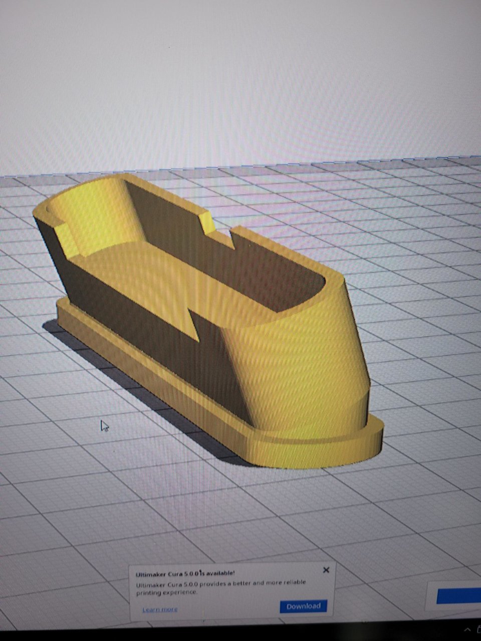

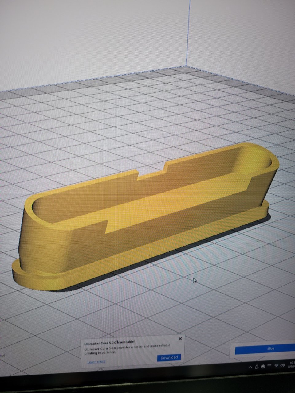

    They look a lot better and I like the placement. I still need a darker filament due to light bleed. I also need to edit for a wire guide and a bigger awning because I can still see it from the drivers seat. I forgot I was mounting on a pitched surface.
