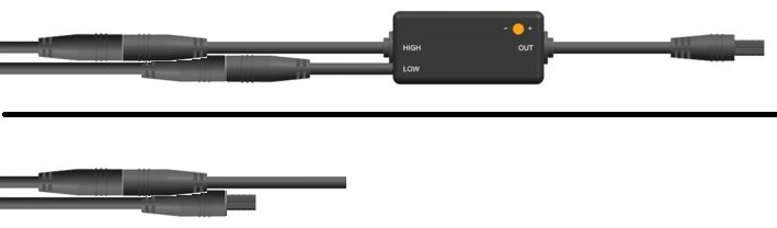

    so you can see the floor at night when you open the door?
    They come adjusted to minimum dimness, which I went back to
    Very faint glow that doesn’t seem to distract eyes from the road vs adjusting the brightness higher
    2 modes
    Bright with door open
    Dim adjustment when closed
    You can pick red which is visible but easier on the eyes than white

    Test by removing the module box and connecting directly to foot well LED, leave Low (parking) off.
