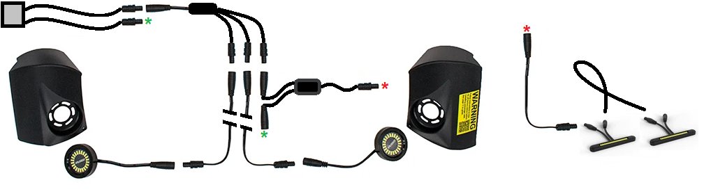

    Not like that...like this:
    Just need to re-wire the cables from each door to the VLED Y.
