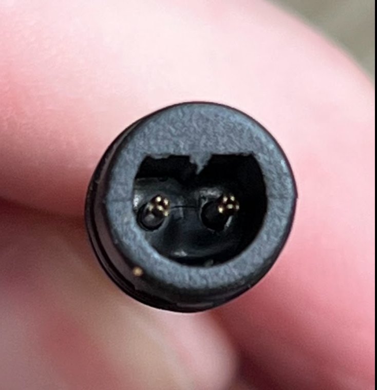

    FUBAR'd module:burp:
    Would you post a pic on the HIGH input of the module? (inside receiving connector view)

    Ya, considering that troubleshooting is part of what I do for a living, I'm a little disappointed I hadn't bypassed the module prior to being asked. :D
    Appreciate the help.
  12. Sep 26, 2022 at 7:56 AM
    #1332
    MNGTaco
    MNGTaco Well-Known Member
    Jul 26, 2021
    #372295
    84
    2020 BRM Tacoma SR5
    Missed the add a pic part the first time.

    Seems ok, would you dare place a jumper to those pins and verify (for one last time) module output?

    Yep! Your PWM is shot. Give VLEDS a call today and tell them Kyle troubleshooted with you and determined you have a busted PWM (they’ll probably see this post).
