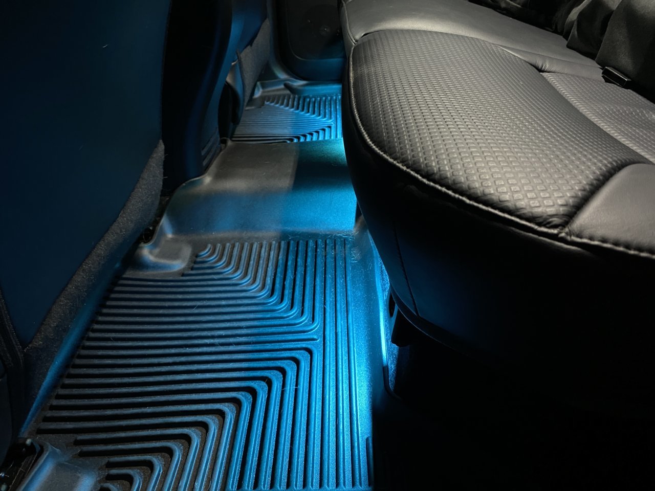

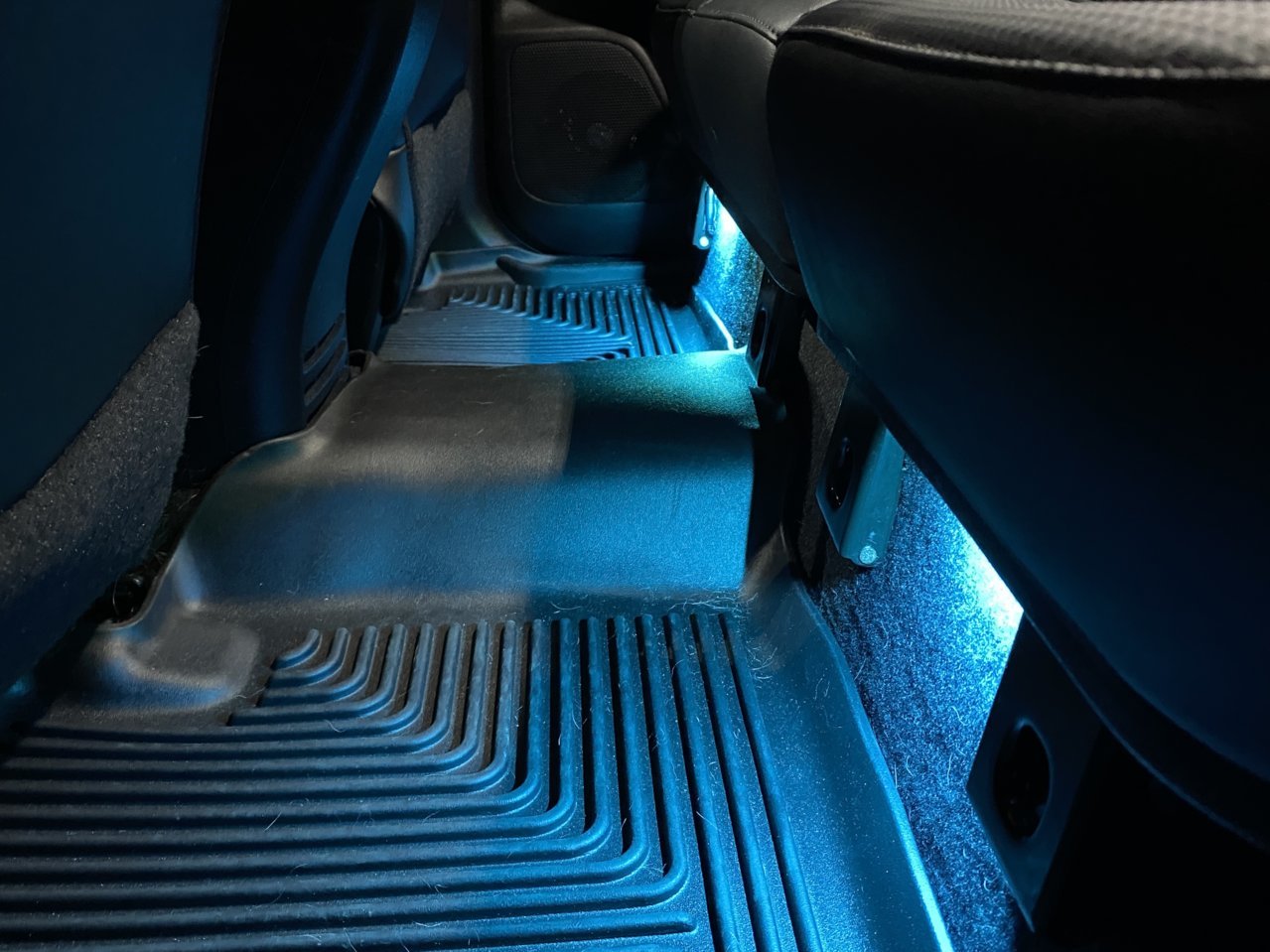

    Following the advice of @kmorgan3 and the trails blazed by @TheCochese @Devious6 @playdixie @ljerr2 on this thread, I dove right in and installed my rear kit under the rear seats. Thanks to those mentioned, install went smoothly for the most part.
    35B4176F-D2B8-421E-8F9D-BF425294368B.jpg 1FB17FA0-B69D-4831-BCE9-C0C2D75CC9B3.jpg I’m quite happy with the results…that is until I realized (ok, forgot about) the seat cover for the dogs will cover this up. *sigh*. May move these to the back of the front seats … reluctantly.

    Two Trucks
    Just connect a vled max pod to the rear center console
    I’m just not a fan of the rear seat mounting
