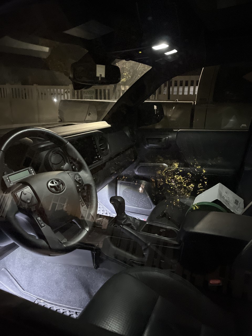

    So I just finished installing the footwell lights and this is happening. Trucks locked, doors closed, and overhead interior light switch is off, but the interior lights are staying on
    I bought the new overhead wiring harness that was recently released by @kmorgan3
    Edit: I have unplugged everything and plug it back together to make sure the connections were solid. No change. With the footwell lighting disconnected from the harness the overhead lights remain dimly lit when in ‘off’ position, and fully bright when in ‘on’ position. When the footwell lights are connected, there is no change to the brightness between driving and having the doors open. Turning the screw position on the footwell module between + and - has not effect in changing anything

    Unplug the PWM and just connect high mode. See what happens. There’s a chance the PWM is bringing the high mode to ground constantly and leaving it always on. If that doesn’t enslave the lights to the overhead switch, then the high and low mode ground wires are reversed which would also result in it being always on. Give it a shot and let me know and I’ll get you a warranty for whichever one is the problem.
