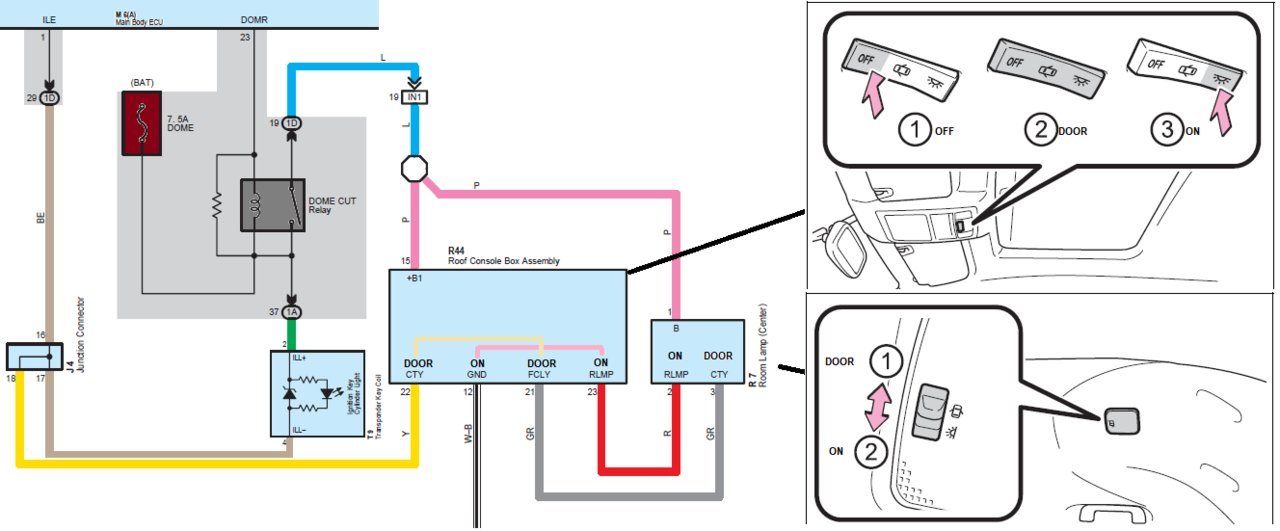

    No problem...happy to get any info. Hoping maybe @caribe can confirm my interpretation of the graphic...

    He originally directed that graphic @ me which I definitely appreciated but I think hooking them up that way would have my upper dome switch controlling the puddle pods too? Didn’t want it to work that way. That’s mostly why I’m trying to figure out how to rewire them so I can keep them functioning how they are but with nothing in the a-pillar other than wiring passing through, not tapped in there.
