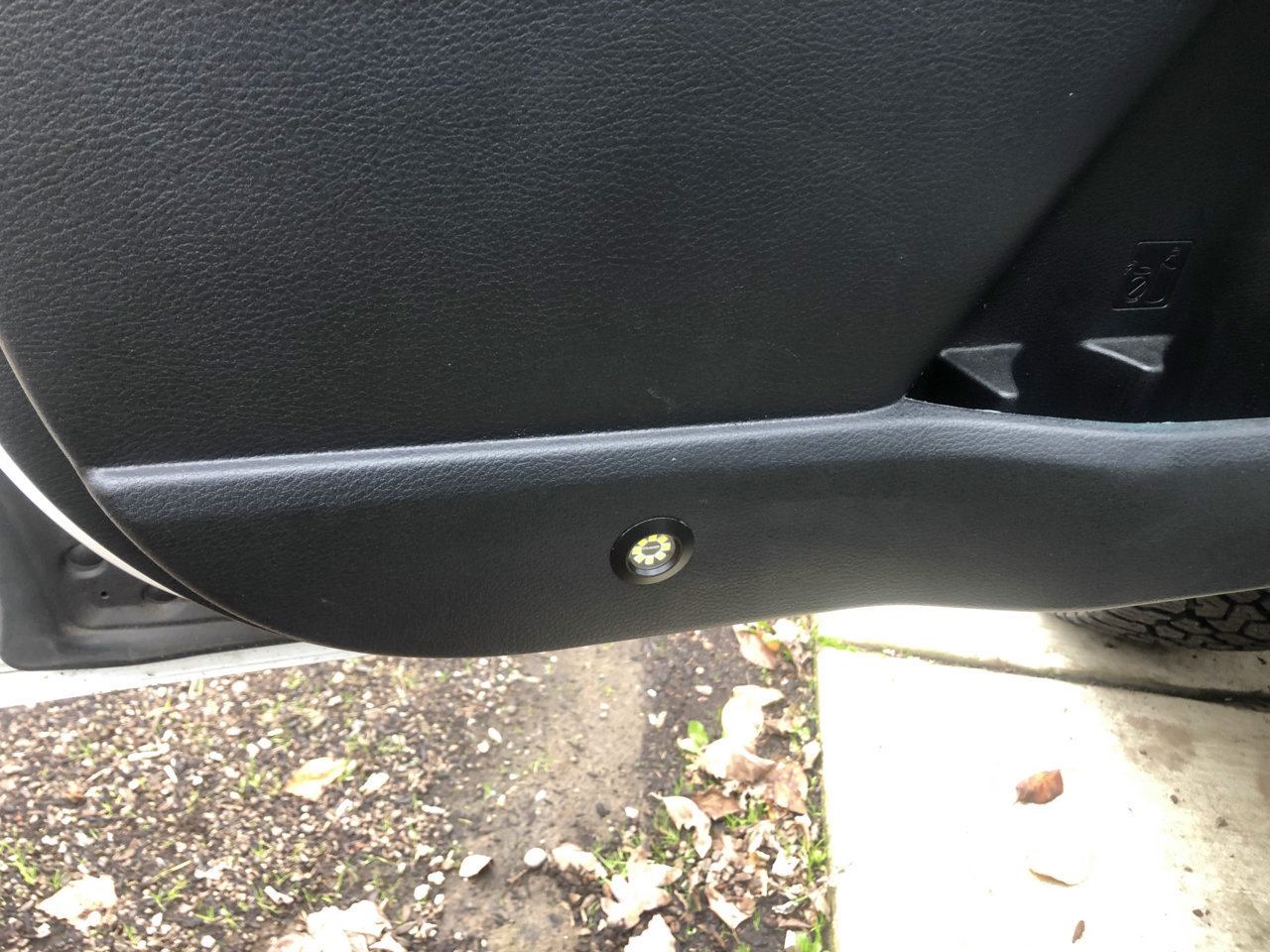

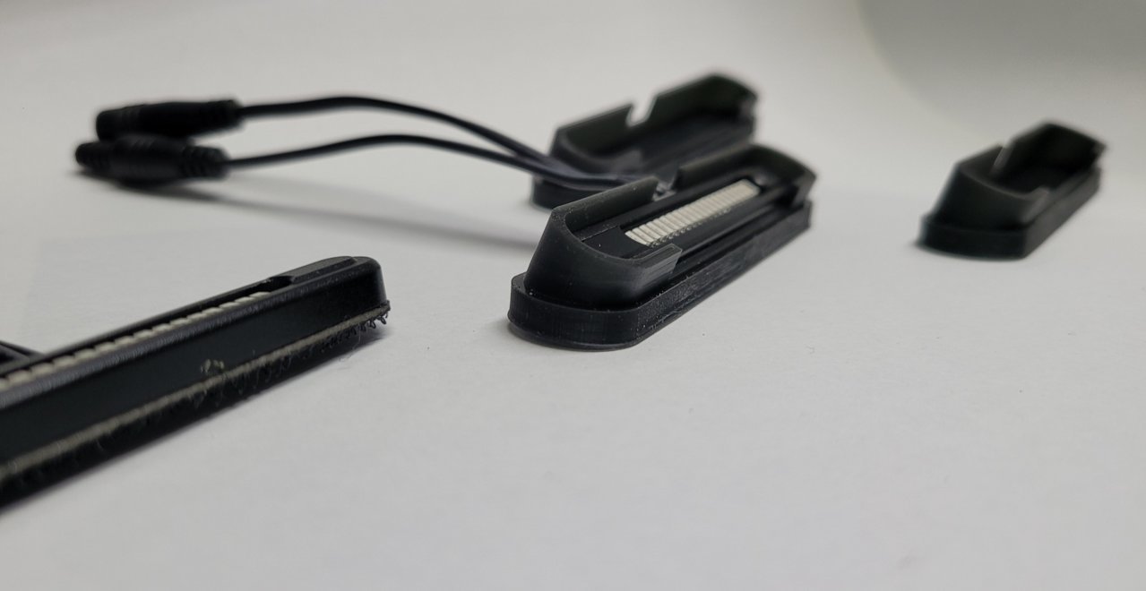

    The max pods in the door? Or elsewhere? I have mine in my driver's door with a flush mount but I drive an access cab. So for me it actually shines light into the rear seat when both doors are open.

    I did flush mount because it's a bracket holding it in place.
    The rear mount is just tape, and looks like it sticks out a little more.
    and it's just a hole. Use a step bit

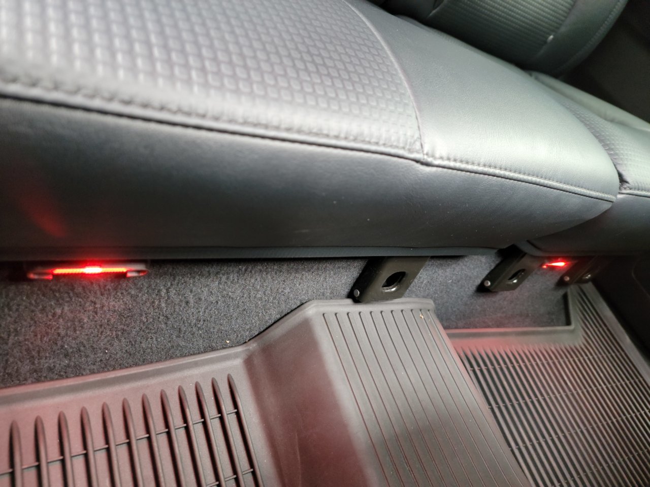

    I have the V2. I've been relatively happy with them minus the rear seat Velcro set up. After seeing a couple of other pics where they are mounted under the rear seats I think I'll go that route once the weather warms up a little bit and I feel like doing some re-routing.
