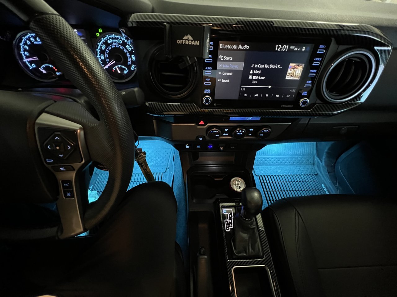

    V2s finally arrived and installed! Was pretty easy…maybe a little over an hour….
    I still need to do the rears but I dont want to put them under the front seats…

    Very nice. The aqua looks fairly close to the ice blue of the cluster. Was having a hard time deciding on color until this post.
    Under the front seats for the rear is also a placement concern for me.

    Yeah it was for me, too. I made some brackets to mount to the vertical "panel" of the rear cubby storage and I think it turned out great. Solid, looks good, and no concerns about being dislodged by someone's shoes or gear.
    I love the lights, both front and rear. Should have come from the factory!

    yeah this is exactly why I went with aqua…it ties in well with the rest of interior lights. painless install and im glad they switched the install with the overhead dimmer.
