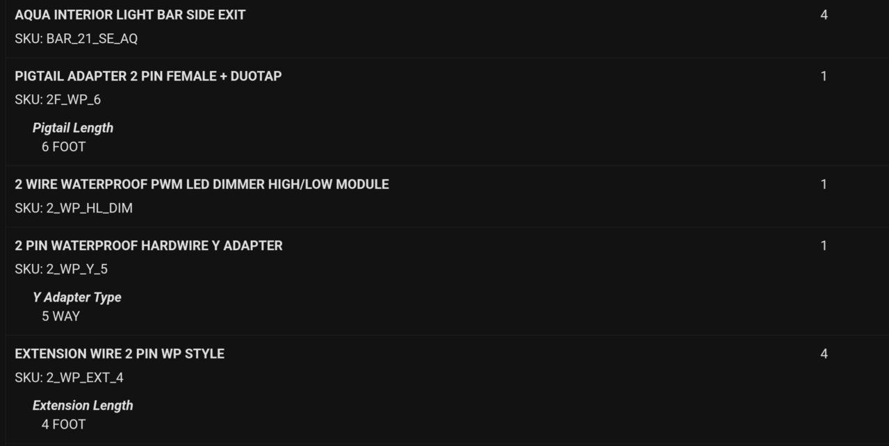

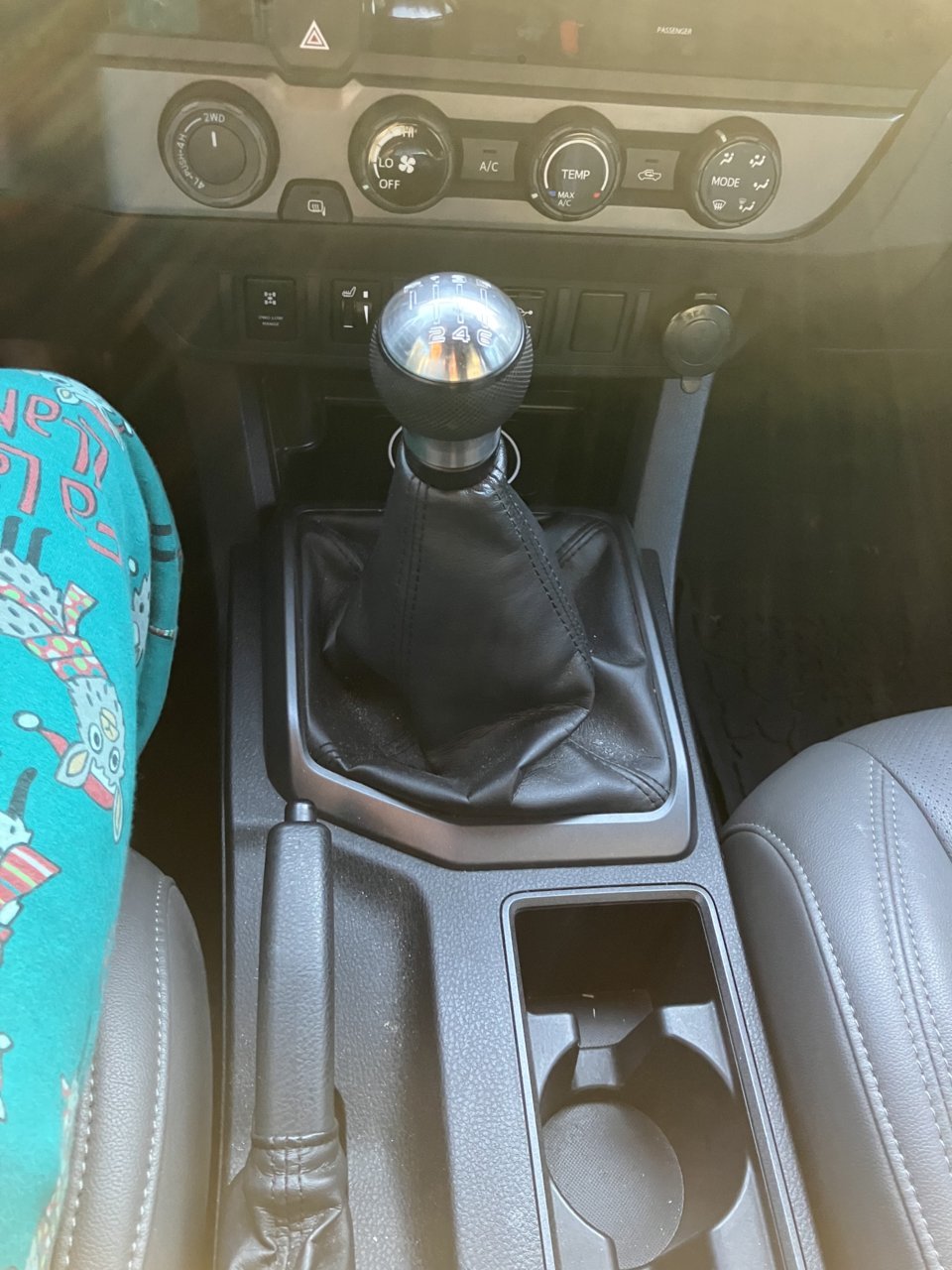

    Pieced together my own kit using the VLEDS aqua leds and their dimmer this weekend. Powered off the Qi charger circuit (I disabled the charger a few weeks ago and wanted to repurpose the switch). These are awesome. I like that they are fully modular - made the install very simple. Also swapped the cubby light out for the matching blue one from the RAV4 (P/N: 81080-42040). And since I always get this question - the light in front of the e-brake handle is the bass knob for my VX700/5i - I didn't have anywhere else within reach to put it.

    That’s a good spot for it. If I ever get mine in, I might follow you on that.

    You do have to be a little mindful of it when releasing the handbrake, but it's not too bad once you get used to it. Very easy to access when driving. If you have a VXi amp, this is the blue mode on the lowest brightness setting. Matches the gear shift indicator about perfect.

    Hmmm, MT is a little less accommodating for the JL VT bass knob.

    what parts did you buy that you used to "piece together your own kit"? was it much cheaper than just buying the kit with the harness that goes to the the dome light and is powered off of it? i was thinking about wiring my own leds as footwell lights off the cubby light so it comes on with the lights and when its dark, but Id also want it to come on when the doors open.

    IIRC I saved about $80 vs their pnp kit. Basically, piecing it together was less than just their front set cost by itself. The main differences are that mine is not pnp to the truck wiring itself which was fine since I wanted to repurpose an existing switch, is able to be turned off whenever I want, and currently is not wired to come on when the doors open (though it would be very easy to add that functionality via their hi\low input piece). I attached a screenshot of parts ordered (I did not use the duotap but it was cheaper at the time to order that option itself vs the harness alone). The full setup was pnp aside from tapping the switch wiring and I am only using the low side of their input as that is the feed that is dimmable. Hope that helps.
