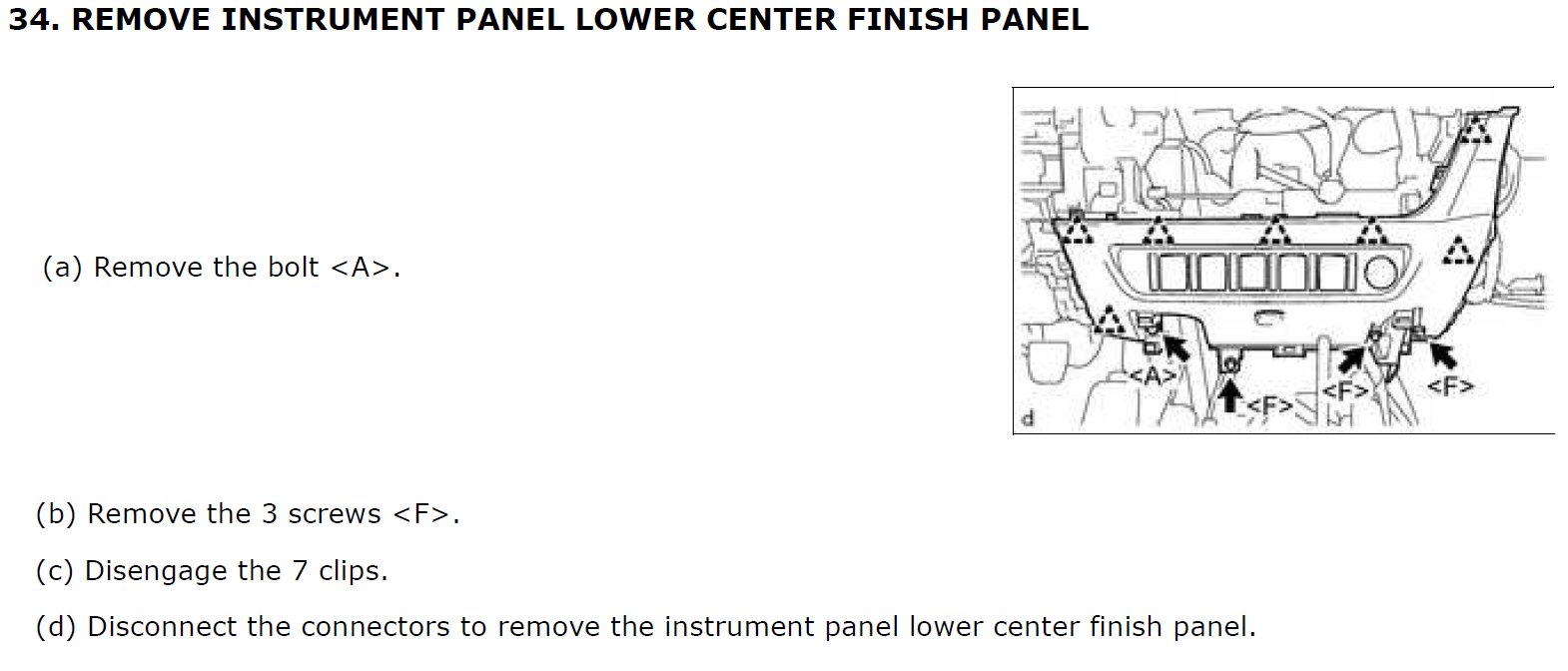

    @drizzoh, how much of the dash/console did you have to disassemble to replace the cubby hole light above the qi charger?

    I don't completely remember, but I know it only took about 5 minutes to swap. I think whatever is needed in order to swap out the push start button\trim is about all you need to do.
