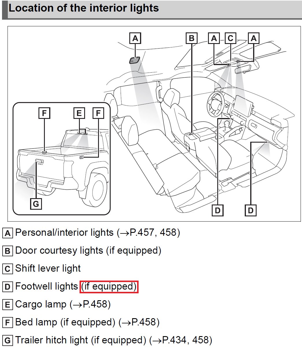

    Glad you were taken care of! Overall we’ve only had a hand full of equipment failures, which at scale is always going to happen. Relatively speaking these kits have been surprisingly robust for the number of components.
    It looks like a dual color option may be possible in the distant future. There’s a few ideas for some designs but there isn’t a timeline. I’ll keep this thread updated as we move through the priority list. As of now I’m prioritizing a few 4th gen mods; footwell lights being one of them as it looks like Toyota missed those yet again.

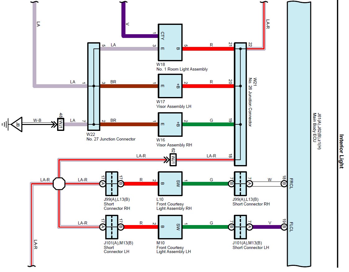

    Nope, you have.
    It's on the doors, easy T to footwells.

    Yes those are in the door, though, correct?

    Yes, T to footwell, easy peasy.

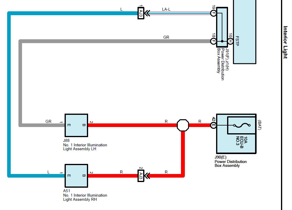

    I have a couple people with 4th gens that have mentioned the courtesy lights don’t have ambient illumination while the door is closed, so a T from that 2-pos would just handle the door open/closed. I’ll shoot you a PM.

    "Under" dash center of Driver's and one for passenger.
