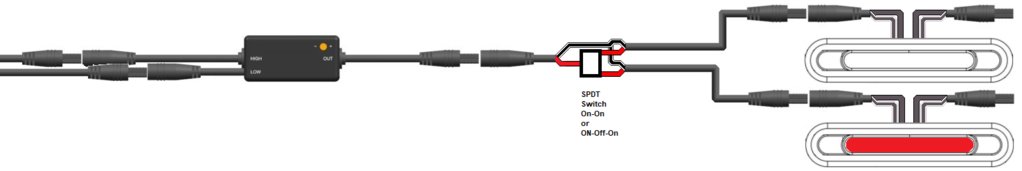

    Why not get 2 sets of light bars and a switch to select which color you want?

    Twice the price, voiding the warranty, possibly taking up twice as much space and looking jenky.

    I’ll try to get an update tomorrow. I finalized a prototype harness for the 4th Gen over a month ago and it’s been on hold as I think they’re making changes to other parts of the kit. So we’ll see if a dual color option is part of that list.

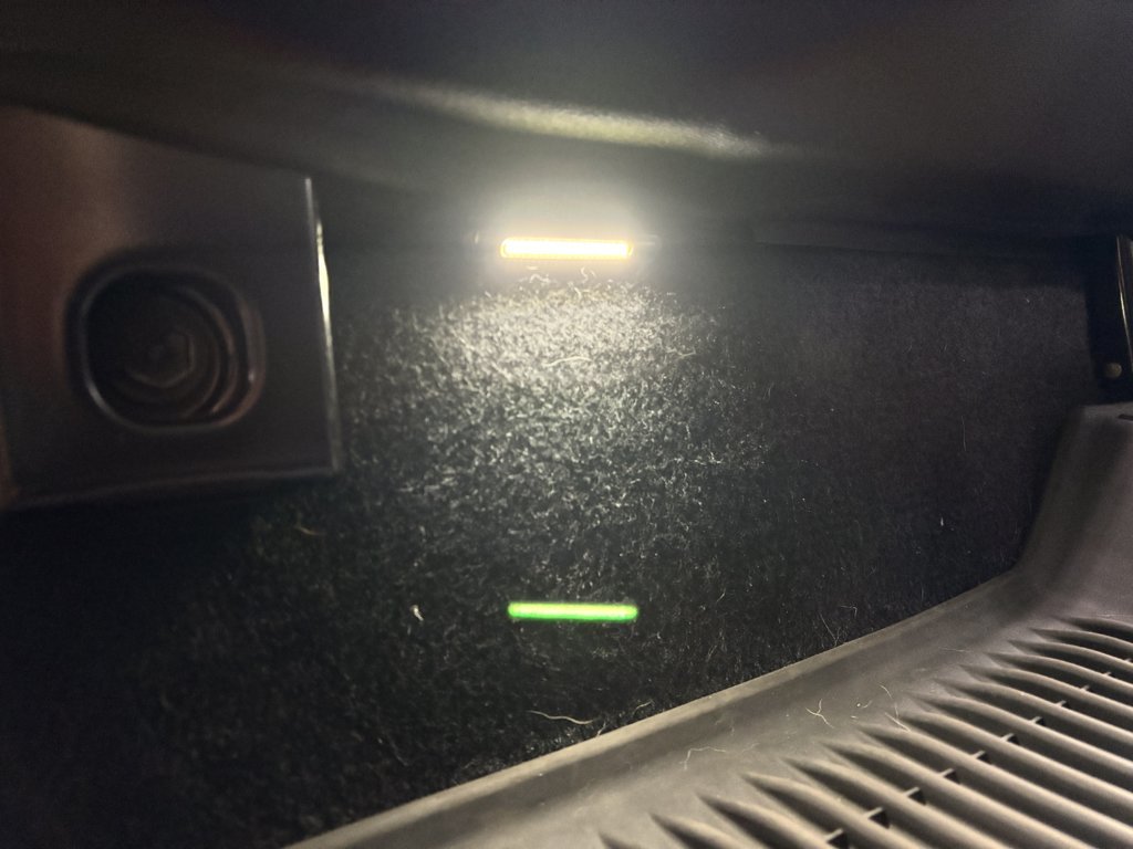

  11. Apr 3, 2025 at 4:27 PM
    #1571
    Bubble Wrap
    Bubble Wrap Well-Known Member
    Jun 21, 2016
    #190200
    368
    Honolulu, HI
    2016 SR5 DCSB MGM
    Just wanted to give a quick shoutout to @kmorgan3 and @memario1214 for a great product and @caribe makaira for his knowledge and tech support with the install.
    I’ve had these one the truck for a while now but wifey wanted them on the RAV. Unfortunately there’s no PnP kit for the RAV yet but for anybody wondering… I got the universal kit from VLED and while it took some tinkering, it works just like the kit for the Tacoma.

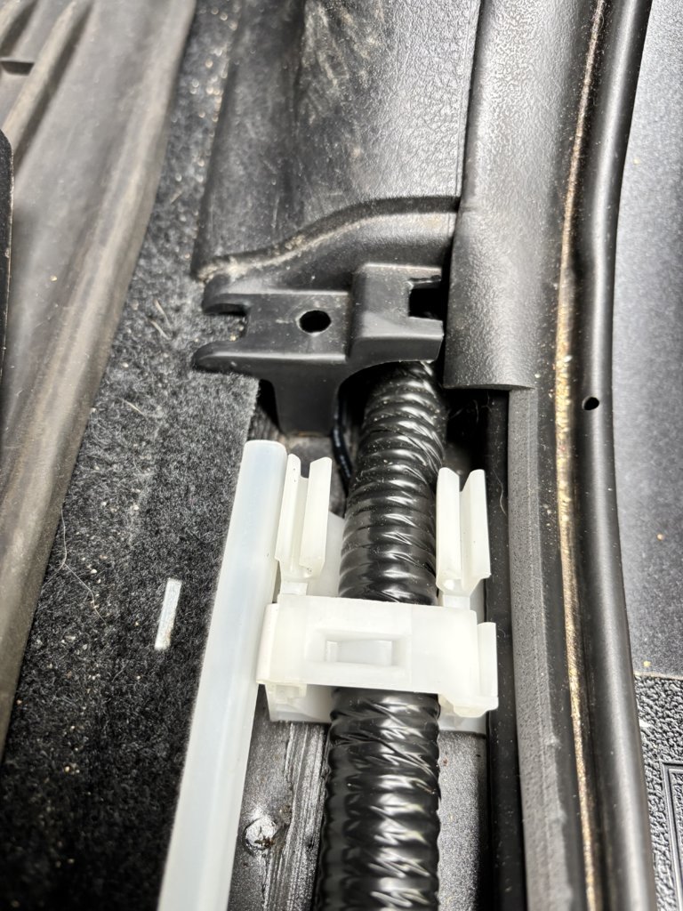

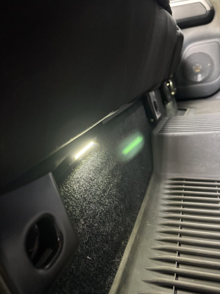

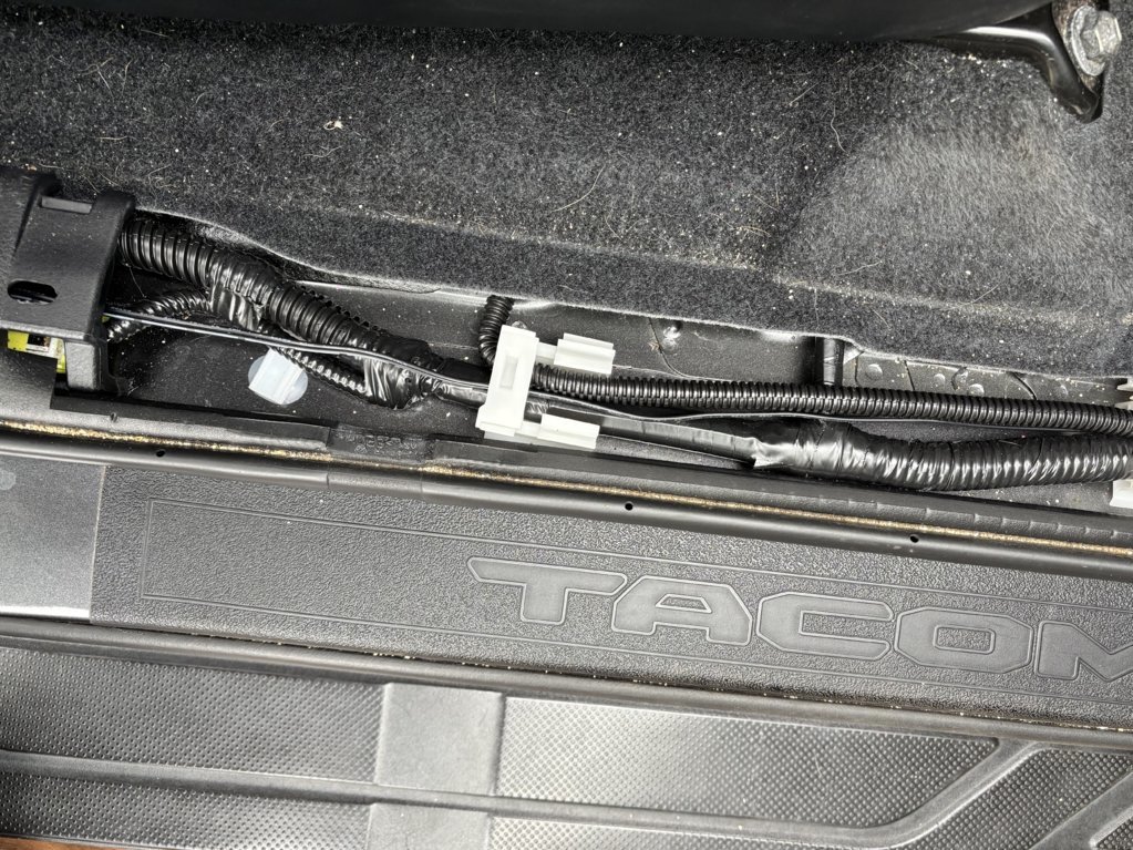

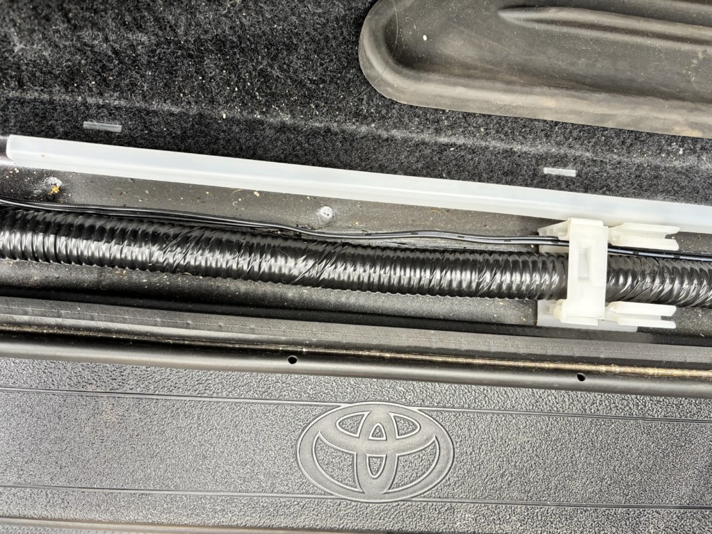

    Hey @Bubble Wrap, can you give me some insight as to how you routed the wiring to the rear seating area and the mounting of the lights in the rear seating area?
  15. Apr 4, 2025 at 2:18 AM
    #1575
    Bubble Wrap
    Jun 21, 2016
    #190200
    368
    Honolulu, HI
    2016 SR5 DCSB MGM
    I routed the lights from the passenger footwell behind the kick panel along the door sill to the back. Simple pull up the panel and route the cable along the existing ones in that channel. In the back, I used Velcro tape for the lights to adhere them to the carpet under the rear bench. I can snap some pictures tomorrow if that helps.

  18. Apr 4, 2025 at 12:27 PM
    #1578
    Bubble Wrap
    Jun 21, 2016
    #190200
    368
    Honolulu, HI
    2016 SR5 DCSB MGM
    Here you go. I hope this helps. Like I said, it’s pretty straightforward. Just pull up the panels and route the cable along the OEM harness. Let me know if you have any other questions and I’ll try to help/snap some more pictures.
    Also… Please disregard the sand. It’s our beach mobile.
    robgeetar and caribe makaira like this.
