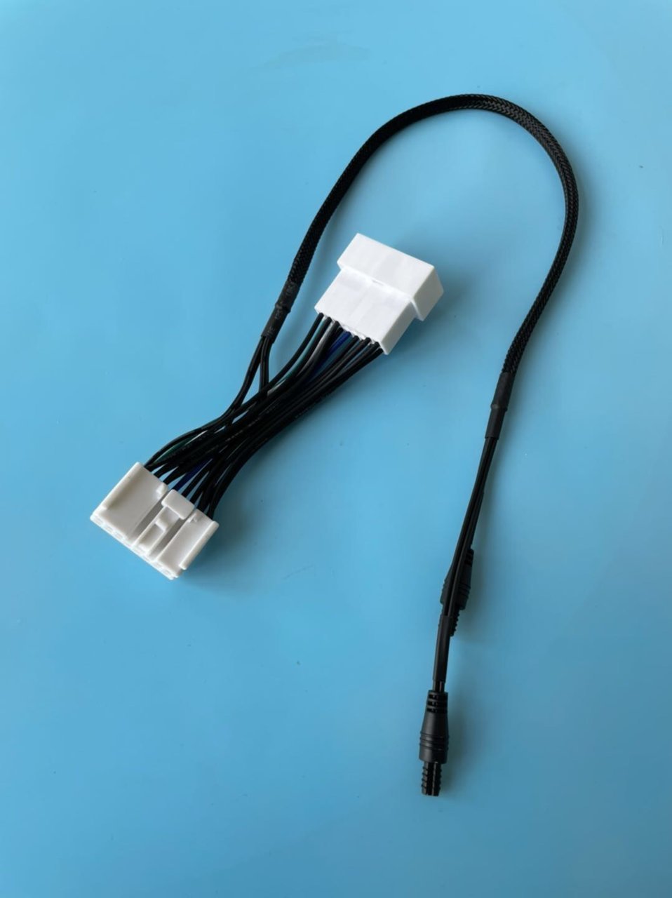

    Production harness without tape:

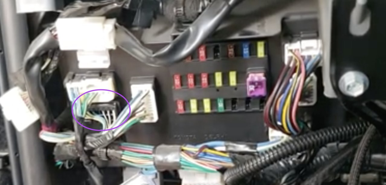

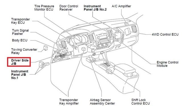

    Awesome. where exactly is the plug located is it further down by the kick panel? or up near the fuse box?
  11. Mar 11, 2022 at 1:02 PM
    #111
    kmorgan3
    kmorgan3 [OP] Redside Electric, LLC | VLEDS
    Aug 22, 2019
    #302994
    1,952
    Kyle
    PNW
    2020 4Runner SR5 Premium | RAM 1500
    Right in line with the fuse box :thumbsup:

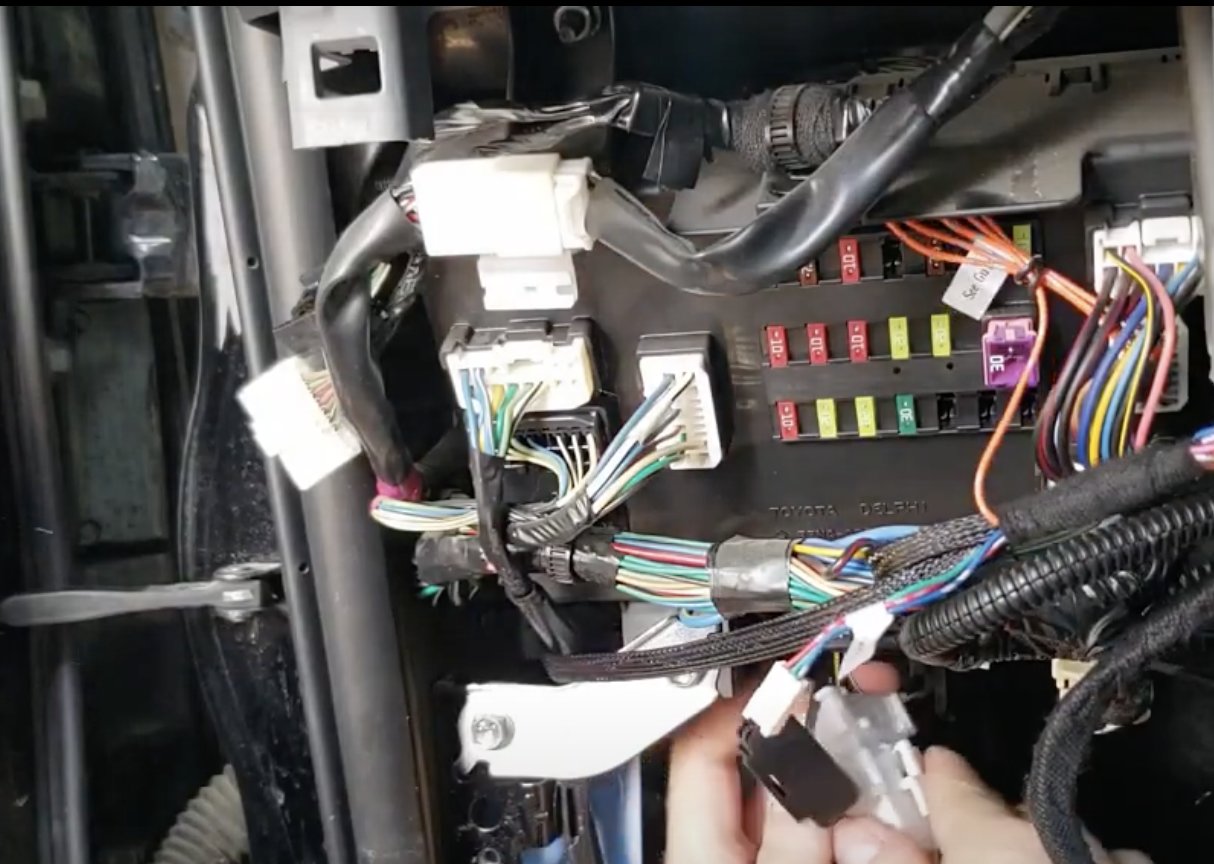

    Im not entirely sure as there are multiple connectors on the 12v kit. I dont remeber them plugging into a module at all though. Some on the steering column one down in the door harness etc. Let me watch the install videos again.
  14. Mar 11, 2022 at 3:10 PM
    #114
    AJKlug1
    AJKlug1 Well-Known Member
    Mar 29, 2021
    #360972
    1,166
    AJ
    SE Wisconsin
    2010 ACLB 4x4
    Full sound system, 3rd gen OR suspension, pro headlights & more
    If this is where the connection is made then no the 12v solutions remote start kit will NOT interfere.Screen Shot 2022-03-11 at 5.08.32 PM.jpg

    See above comments; it does not interfere.

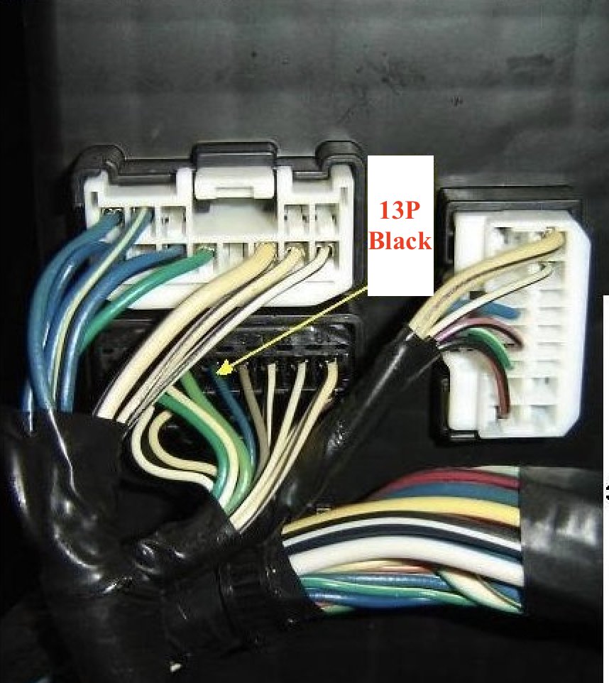

    Will these work on the 2.5 gen regular cabs that aren't prewired? I have a 2012 base model 4wd and its not prewired for anything so just adding cruise is gonna be expensive so before I bought these lights I want to make sure they will work.
  20. Apr 4, 2022 at 5:50 PM
    #120
    caribe makaira
    caribe makaira Well-Known Member
    Feb 13, 2011
    #51121
    11,788
    Caribbean, Puerto Rico
    05 PreRunner TRD Offroad AutoTrans
    Hood Struts, My version Fogs always ON, Map & Overhead Light Mod,
    Remove the cubby that gives you access to the cab fuses.
    Look for this connector:
    Blue wire on slot 9 of 1E.
    If the single cab has it, you're good to go.
