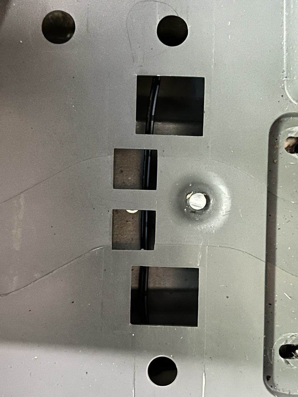

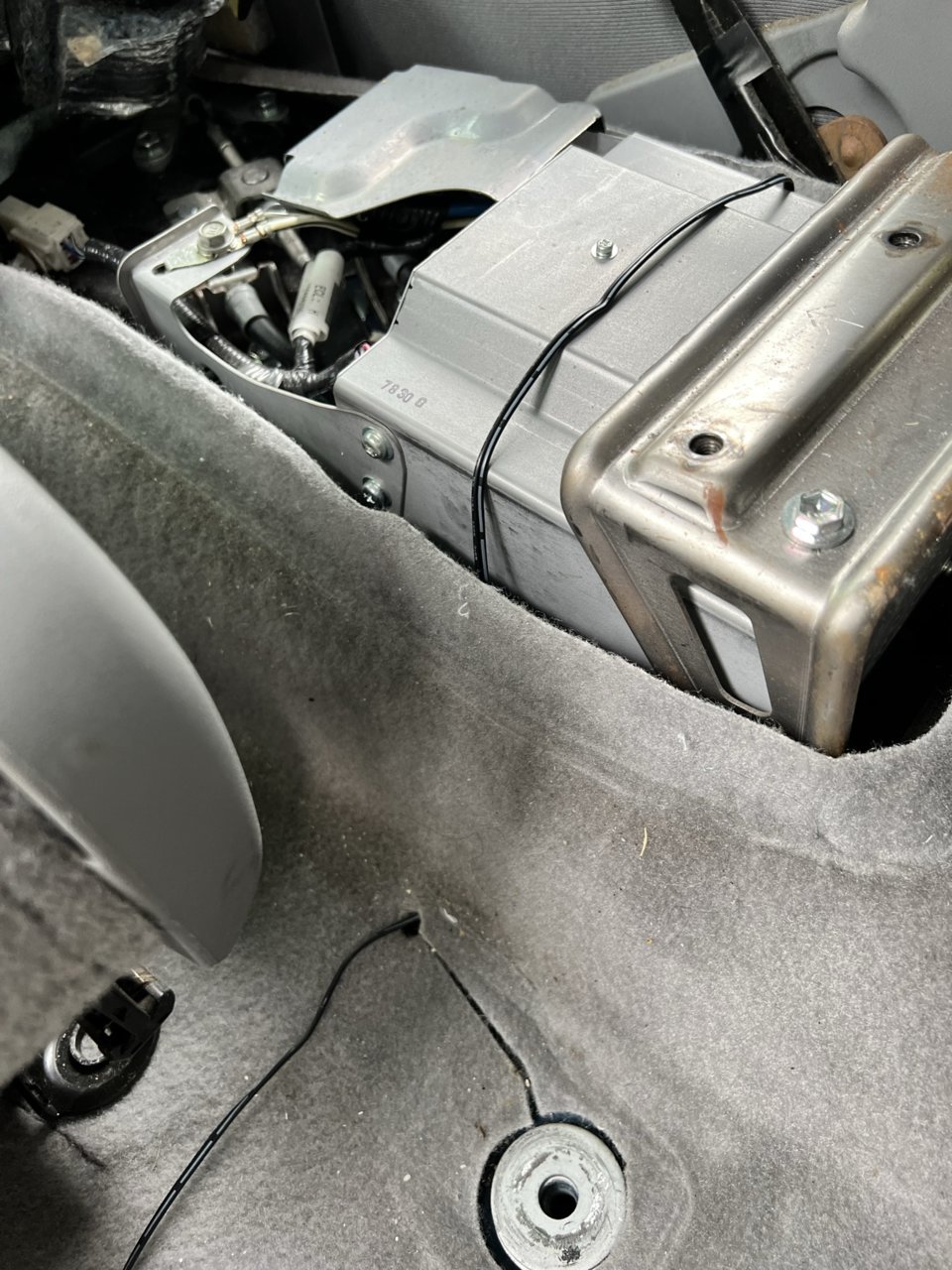

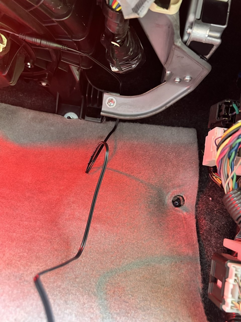

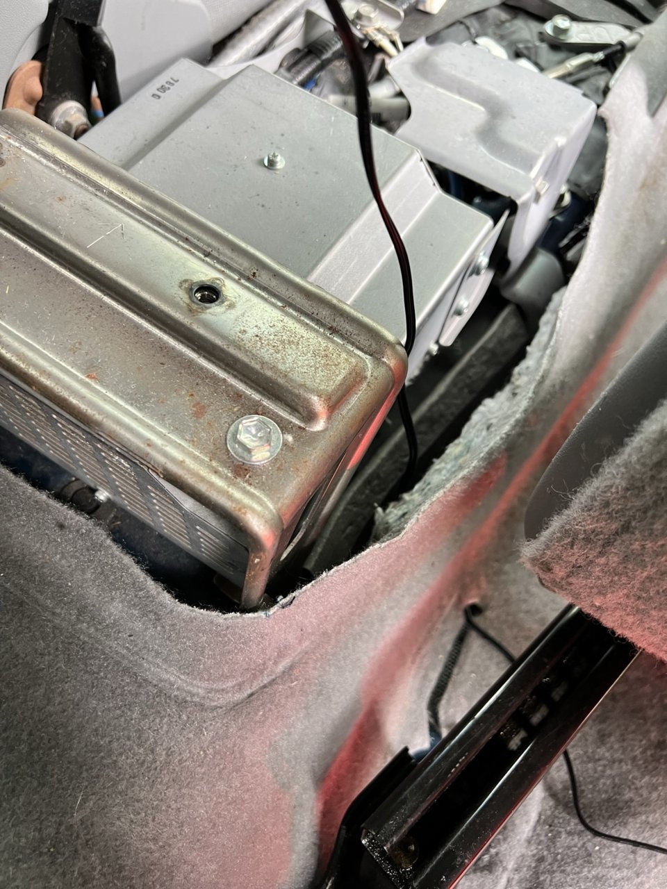

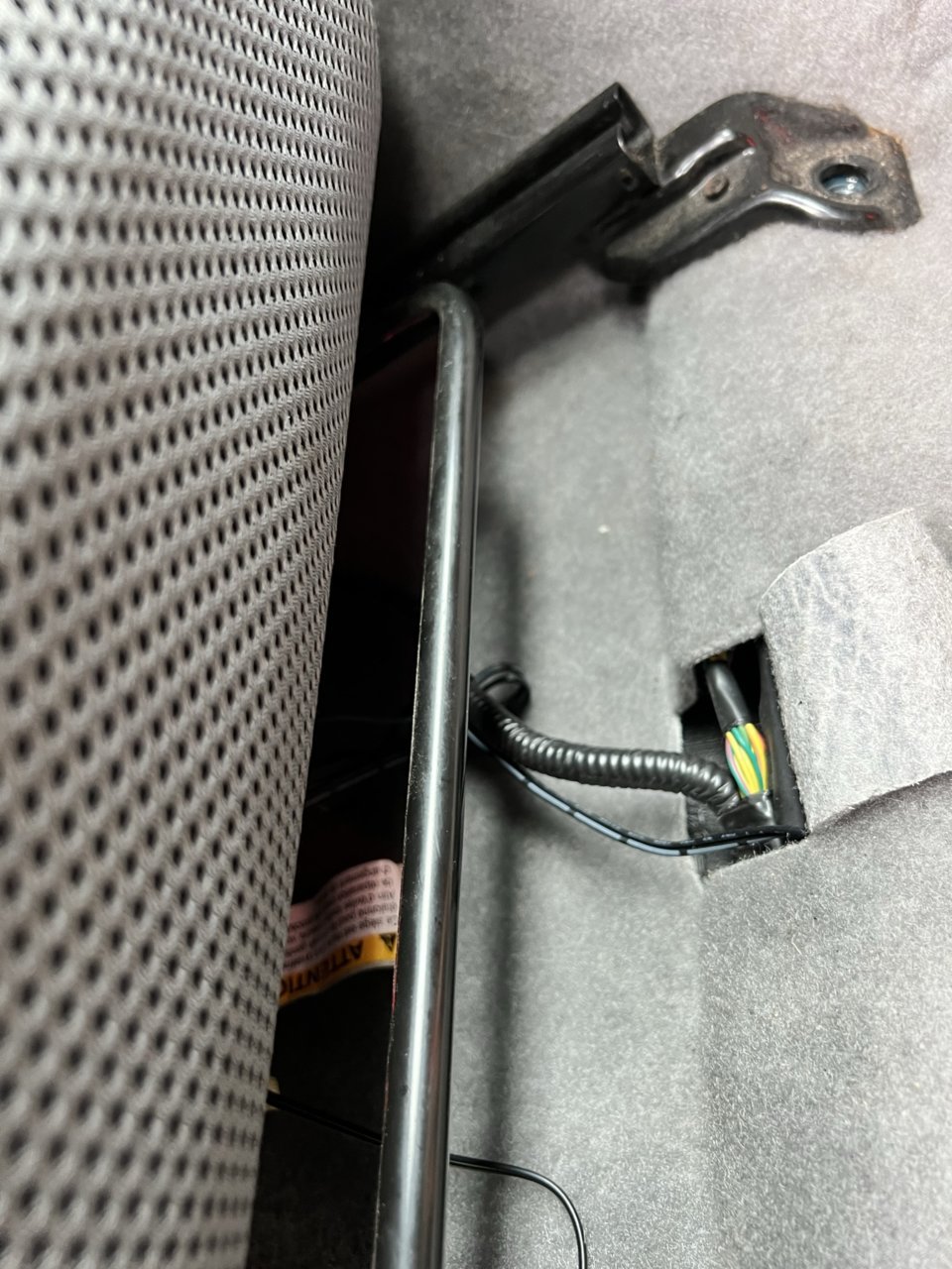

    Rear lights are done. Barely more complicated install than the fronts. I removed the center console and unbolted both seats. Wire came under the carpet and up through a pre-existing hole at the inner-most rear seat bracket. There's a perfect spot for it. Then looped it over the center console and through the same hole in the carpet on the driver side.
    The velcro pieces are so strong that it pulls the tape off the light as opposed to the releasing from the carpet on the seat lol. My suggestion would be to zip tie them on after you adhere the piece w/ the tape. Also leave some slack in the wiring otherwise when you move the seat you'll constantly be ripping of the light. I chose to zip tie the wire bundle to a piece under seat.
    Hope that all makes sense. Pics of where I ran all wires and aftermath....
    Ran the wire from the footwell under the carpet. Had to pull the side panels in order to do this
    Used all pre-existing holes in the carpet to run the wires. Right in front of pass. seat is where the first wire comes out from underneath the carpet.
    Here's the hole in the carpet that I used.
    Up and over!
    You can see the wire running below the center console, once it's been reinstalled...
    All Done!

    just got mine today! Going to install front and rear tomorrow. When installing rears do they piggyback off the front plug or do they come off the front lights somehow? Probably a stupid question

    Nah, not a stupid question. They daisy chain off the passenger side. Youll see once you open everything up. It’ll make sense.
    if you route them the same way I did you’ll use the two longest extensions for the rears. One to go pass. front to pass. rear and the other from pass side to drive side.

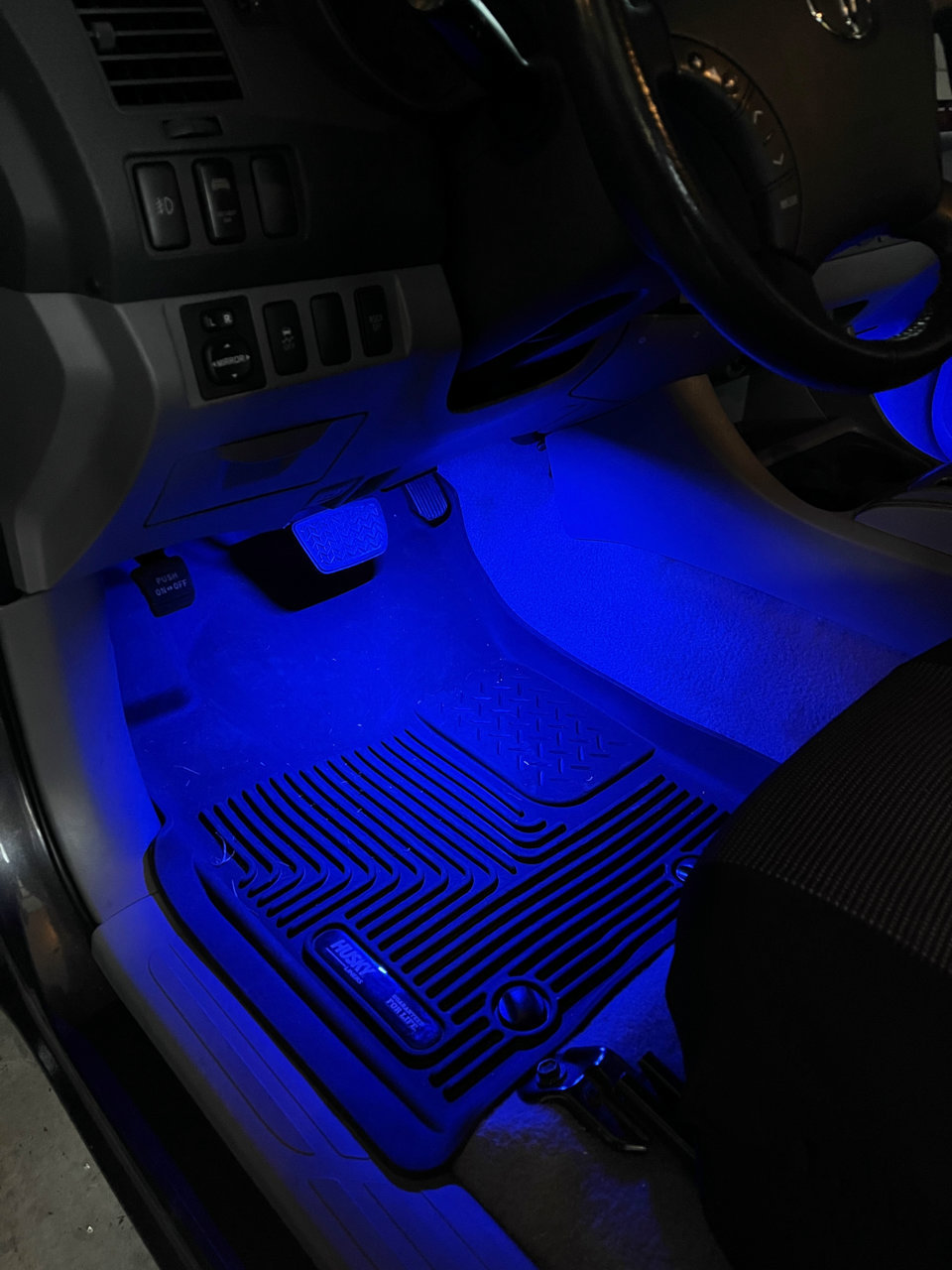

    Love the blue! A great full and vibrant color! Mounted the dimmer on a bracket for the brake pedal, hidden and accessible at the same time. Thanks @kmorgan3!
