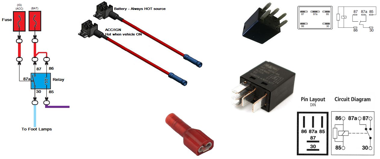

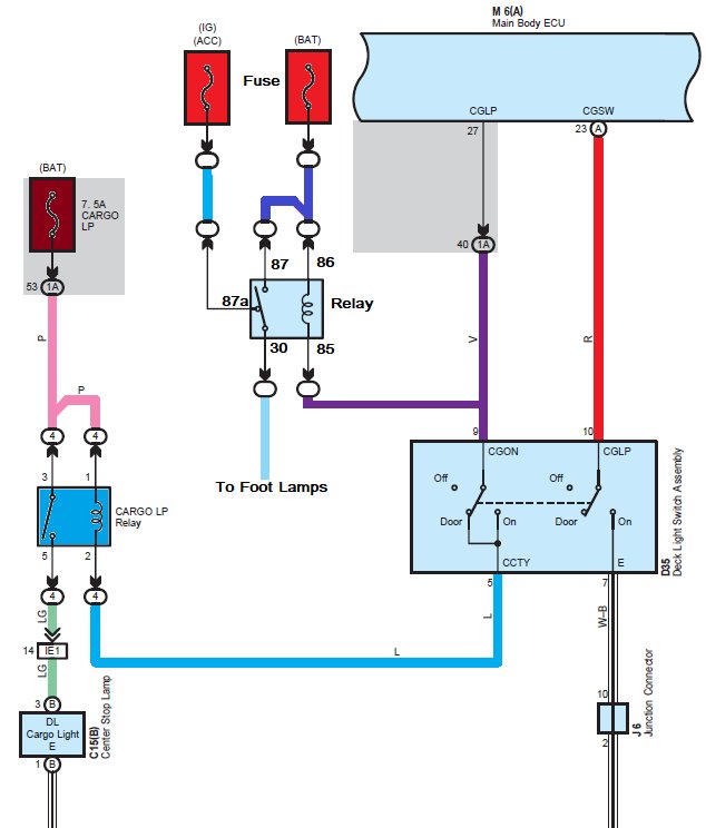

    Got it. So I would just need to add the relay and tap the purple wire coming off the deck light switch assembly?

    Always HOT/BATTERY:
    Sunroof is a good one. Seat heater also..unless you use it up at
    Haleakalā:D

    Another "way"...

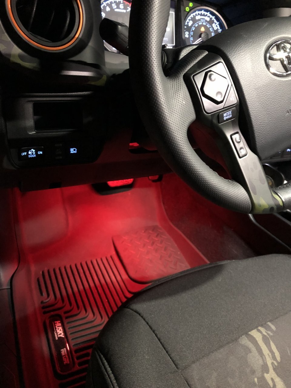

    Sorry for the delay in progress. Worked perfectly using the first wiring diagram tapping the purple wire on the cargo light switch. Thank you @caribe makaira

    No pics of the install?:notsure::typing:

    No sorry. Mounted relay in the engine bay on rago relay mount then ran wires inside the cab to fuse panel and the purple wire. Leds were little 5 led bars 3m taped to bottom of the dash.
